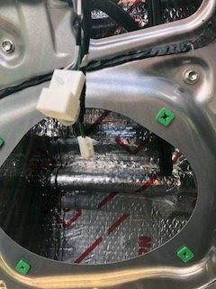

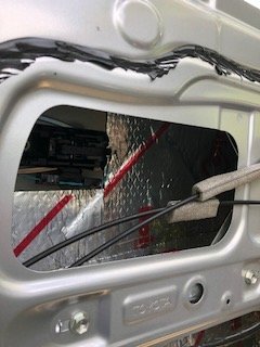

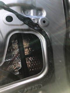

    Thanks, bshammer0 ! completed the tweeters last week and did the front doors today. Made it an all day project an still got finished a little early. I went to the trouble to completely line the inside of the door skins, yep I'm that guy (details, details, details) before I started I gave the door skin the old knuckle test. They sounded like an empty beer can. When I finished they just go THUD. Its like knocking on quarter inch plate steel. With only doing the front doors so far the road noise is reduced drastically. Ill do the back xcab doors next weekend and install the speakers. It is overwhelmingly worth it to take the time to do the inside and outside of the doors. Of Special Note: when you line the inside of the door stop the material an inch from the door bottom or you will block the water and moisture drain slots in the bottom of the door skin and your doors will rust out. The sound system is vastly improved.
