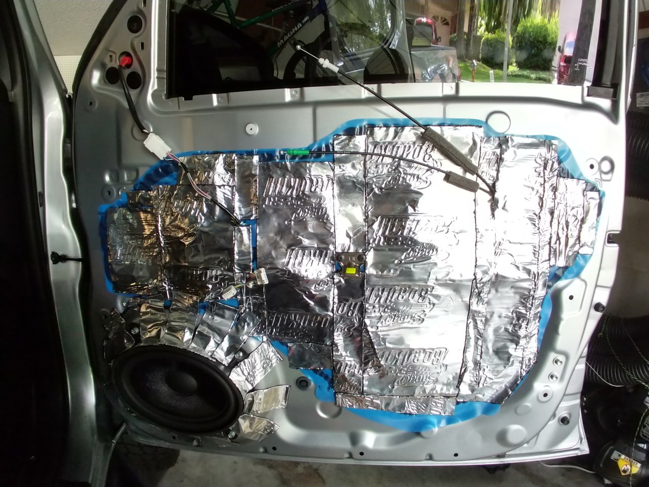

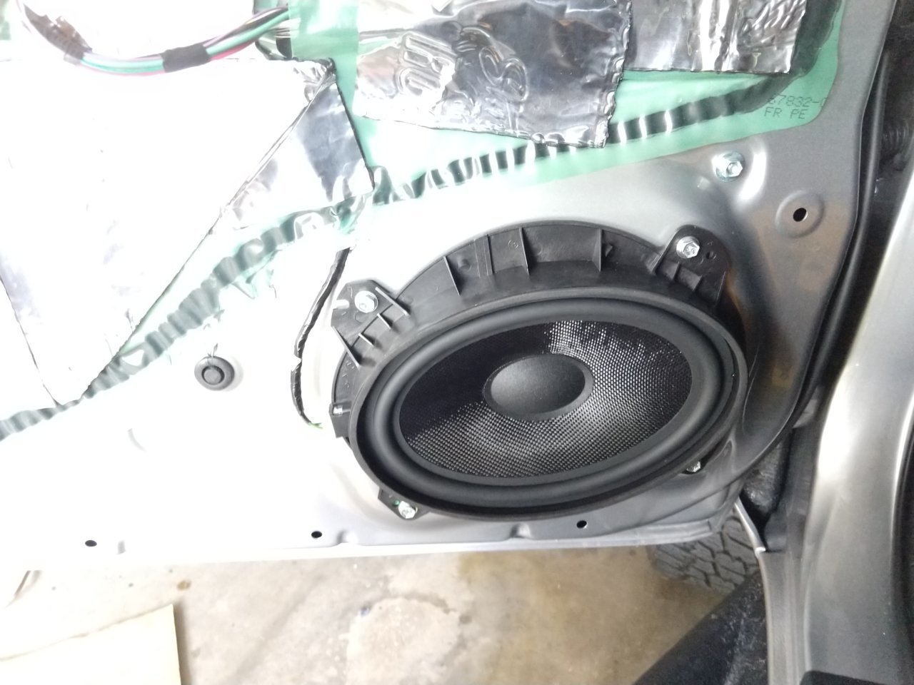

    Installed mine yesterday. Decided to go with Focal's because of the "Plug and Play" mounts. Added some sound deadening material to the door as well. Over all, a lot cleaner sound. More present frequency ranges both up and down. Cost me about $260 all said and done.
    I didn't snag too many pictures. Just some as I finished each door.
    IMG_20180721_111318542.jpg IMG_20180721_125129794_HDR.jpg IMG_20180721_113451973.jpg

    I neglected to install sealing foam/gasket between the speaker and the mounting adapter, and between the adapter and the door. The bass response is clean but not very strong. Have folks found stronger bass after sealing the speaker to the door? I have the Crutchfield Kicker speakers recommended by the OP.

    Road kill fast rings ($17/pair on Amazon) and a roll of speaker gasket tape ($15) will change everything!

    The doors are not air tight speaker boxes. I get enough bass that the inside and outside mirrors shake. If you need that much bass install a subwoofer. The foam rings are a waist of time and money. I’ve been an audiophile since the 70s.

    As a geek squad AutoTech, I 100% vouch for fast rings (and so do the other 2000+ installers we employee)
    We don’t even sell them so it’s not like we’re making money for recommending them. They absolutely make a difference when used properly. My experience is with the Road Kill 3 piece kits so your results may have varied with different products

    Like @MMXVII said, the speaker rings don't really make the bass response any stronger for door speakers like it would for a subwoofer. They will, however, clean up the audio quite a bit. It helps isolate the speaker's forward waveforms from the relfected waves (coming from inside the door/behind the speaker). That should make your system sound a bit clearer as you push it harder.
    The best way to improve bass response for in-door woofers is to cover the door with sound deadening material so that you are sealing as many of the gaping holes as possible. Just beware that you don't seal it so that you end up blocking drain holes or restricting any of the door's functions.
