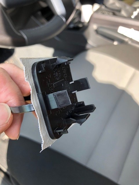

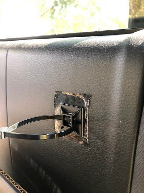

    Well, I ended up having to answer and invent my own answer to:
    "How do you get the three bolt covers out of the back seat cab panel in a 2017 Access Cab without marking the plastic".
    For one thing they are stuck in there very well. Here are two photos to show what I came up with. It works perfect, pulls them right out without a mark. Items you need, Gorilla black duct tape, 2 X 2 inch square. Large zip tie anchor self sticking. Medium zip tie. Set things up like in the photo. Give it a smart pull straight back and out comes the plug. Note that the plugs are indexed and are not the same.

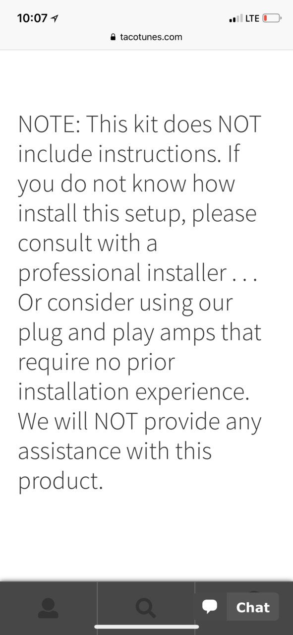

    Judging by this message on the page for this product, I would probably disagree with @Rodchester about contacting them. Normally contacting is the way to go, but probably not this time.
