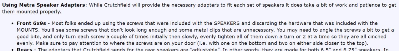

    How do you mount the feont kicker speakers to the metra adapter?

    Yeah.
    If you order from Crutchfield, you get the harnesses and adapters that make any speaker that fits plug and play. I went with the JBL GT7 series front and rear. Since I was not planning to amplify, I wanted to get the best sensitivity and lowest RMS speakers I could find, and the JBL has slightly better specs than the Kickers. But probably not enough to make a noticeable difference, LOL. They were on sale at the time and a little cheaper, so I said WTH.

    Yeah.
    It's been covered in this thread, but the holes don't exactly match up. Start the screws at a slight angle and get them all started before tightening them all down.

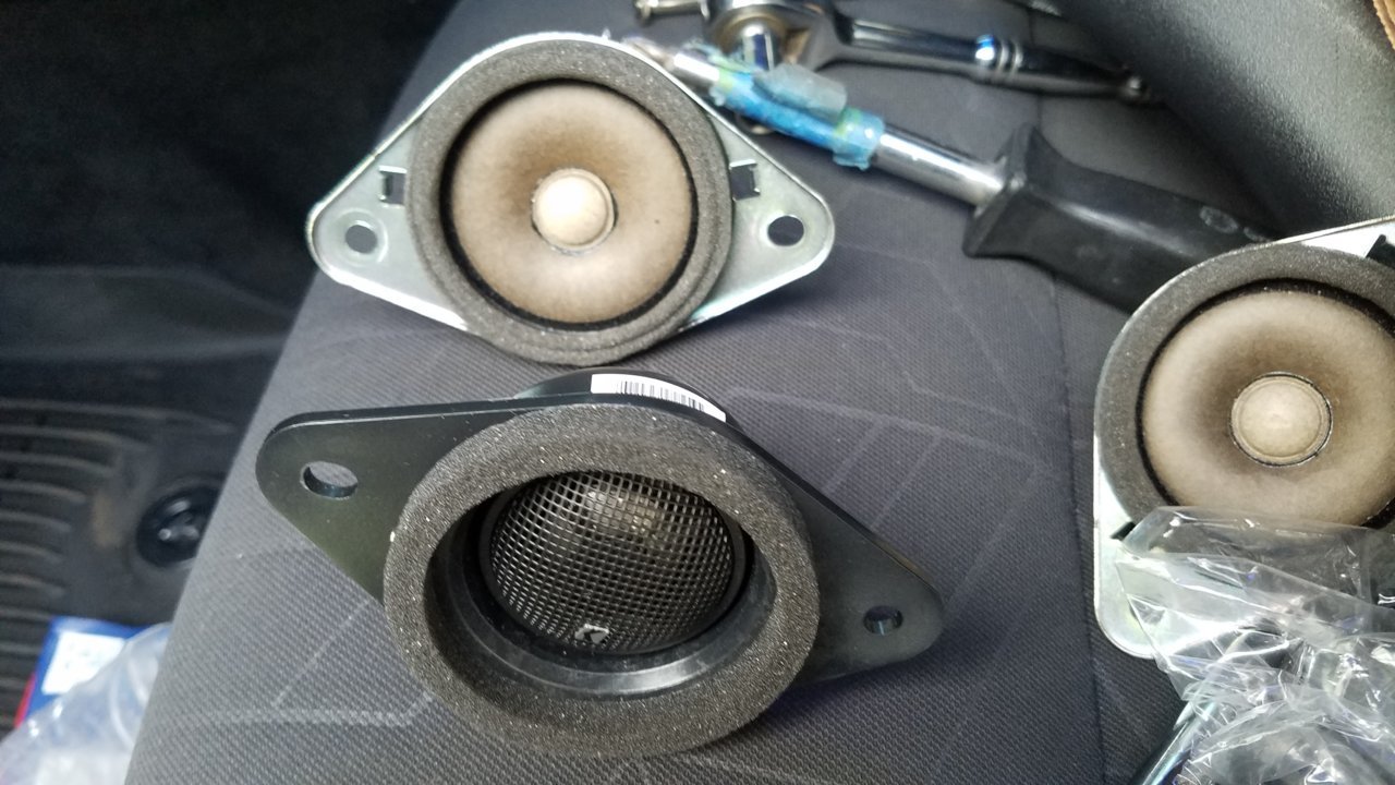

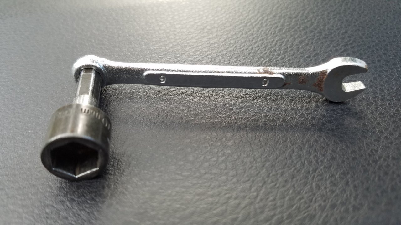

    Done! Holy dawg! Don't think twice about this mod, just do it! I don't need no stinkin' amp. The speaker swap sounds fantastic! I also added Kilmat behind the speakers on each door outer skin. Front driver door was first, took me about an hour from start to button up. Rear driver side door was next, went much faster, maybe 40 minutes. By the time I got to the passenger side doors, I had it down and it took about 45 minutes combined.
    The tweeters were the toughest part for me. My 1/4" drive 10mm socket wrench was too big to get to those bolts closest to the windshield. In the end, I "made" a wrench. I took a 10mm driver bit and jammed it into a 6mm wrench. And by "jammed" I mean beat the crap out of it with a BFH until it fit nice and snug. Improvise, adapt, over come. It worked. lol
    Compared to the Kickers, the factory speakers feel like toys. Impressive how thin and light they are, surprised they make any sound at all. Thanks agains @bshammer0 for this thread.
