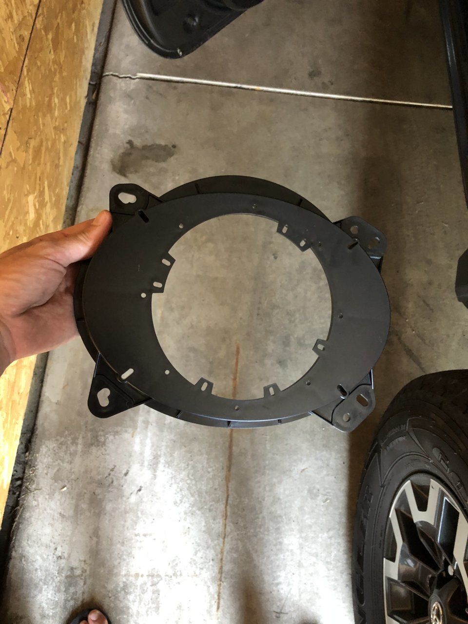

    Wow, this is a massively large pain in the ass due to the “universal mounts” from crutchfield. Once I figured out the fronts, not that bad. But now, how in the actual fuck are these rears supposed to mount? This isn’t even remotely close to the OP’s “just snap these off” picture. Wondering if crutchfield sent me the wrong part.

    No, that's right.
    They're just plastic. Just snip them off with dykes or shears or whatever. It doesn't have to be pretty or perfect, just so the speaker fits flush.
    Edit: ignore the wires in the picture. I hadn't routed them through the little opening in the speaker adaptor yet.
    Edit 2: I'm sorry, those do look like the wrong mounts. I was only looking at the tabs. Those look like adaptors to put a round speaker in a 6x9 spot. Sorry

    Crutchfield sent you the set for the fronts, not the back. That's an adapter for a 6.5/6.75 to 6x9.
    They did the same thing to me, call them and give them the product code on the bag and they'll send out the right set.

    I see it now. You're right.

    THANK YOU! I'll give them a call now.

    They’re sending the correct mounting brackets now. Thanks again guys! The front speakers sound great for the time being. I’m getting super crunk.
