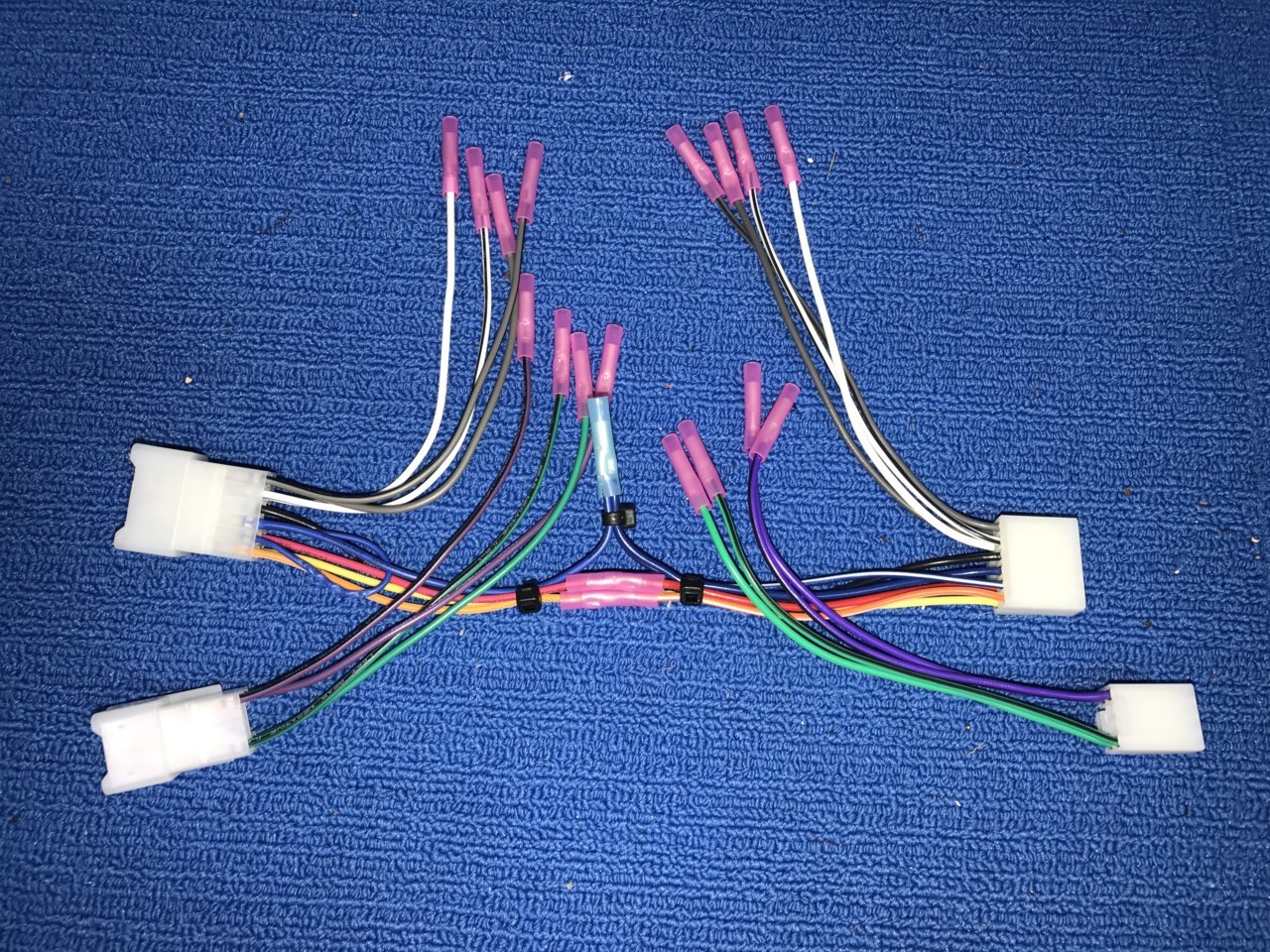

    Hey guys. I need some help. I'm going to install the Kicker Key and have some questions about how to wire the metra harnesses to give it power, ground and a 12V turn on. I understand the speaker wiring but not the others. If harness A sends speaker signals to the amp, and harness B received the amplified speaker signals to send to the speakers, how do I handle the power, ground and remote turn on? Thanks for the help, guys!

    You will make a literal T.
    Take a look at the blue remote wire. The two harnesses are still connected, but I also have a place to attach a third wire. You will do this with power, ground, and remote.
    This particular harness was for a client getting a large 4 channel that needed a dedicated power run to the battery. If it was my vehicle, I’d solder/heat shrink. But in the shop, time costs money and good crimps hood perfectly fine.

    Thanks for the help. So if I want to draw power and ground from the headunit, I make the same kind of T linkage as the remote turn on wire?

    Exactly! Be it with soldering or crimps like shown, just have all 3 wires connected in some way (yellow from the male harness, yellow from the female harness, positive to the amp) and follow with ground as well

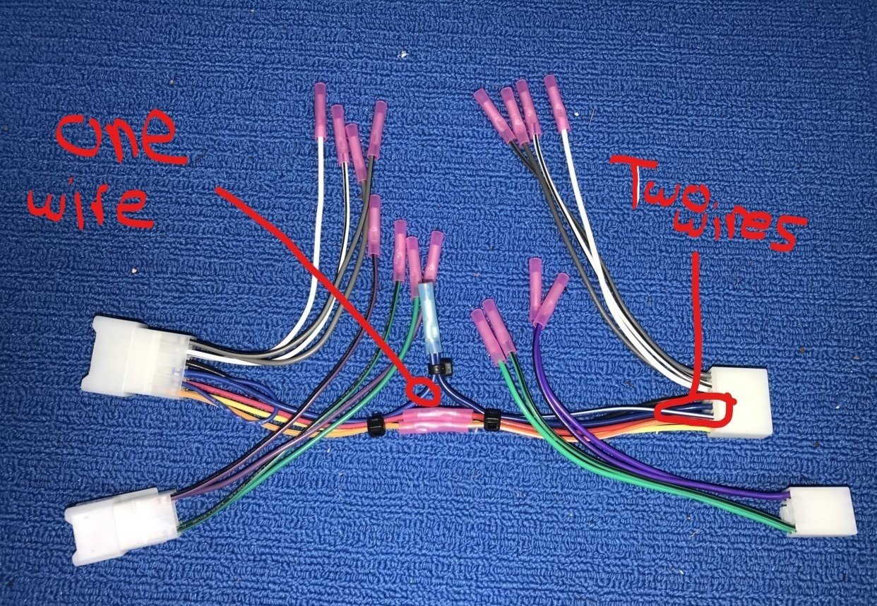

    You've been a godsend and thank you for all the help! One last question and I promise I'll stop. In the posted picture above, the two blue wires coming from the harness on the top right look like they're both connected to the single blue wire from the harness on the top left, correct?
    I've never done wiring like this before and want to make sure it's perfect the first time. I bought a soldering kit, the shrink wrap, a heat gun, etc., everything I need. I'm excited to try this.

    The two circled wires on the right are connected together with the one circled wire on the left?

    It looks like they are crimped together in the center.

    Gotcha! Yes, they are both connected. I believe only the solid blue (power antenna) is actually pinned in the factory wiring but usually combine them when I’m in the shop to speed things up, instead of going over to the vehicle, comparing with factory wiring, and de-pinning the unused wire.
    Ultimately, all of these wires are just accy wires. Solid blue is power antenna, blue/white is amp turn on (unused in our non-jbl trucks,) and red is the accy radio turn on. They all get hot with the key. You could have the amp’s remote turn on tied to any 3 of these wires.

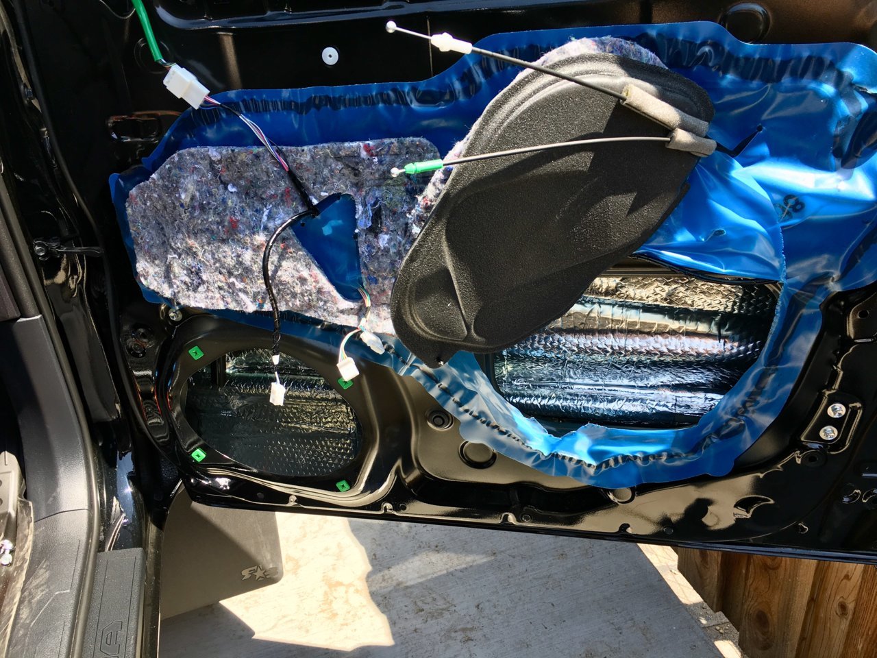

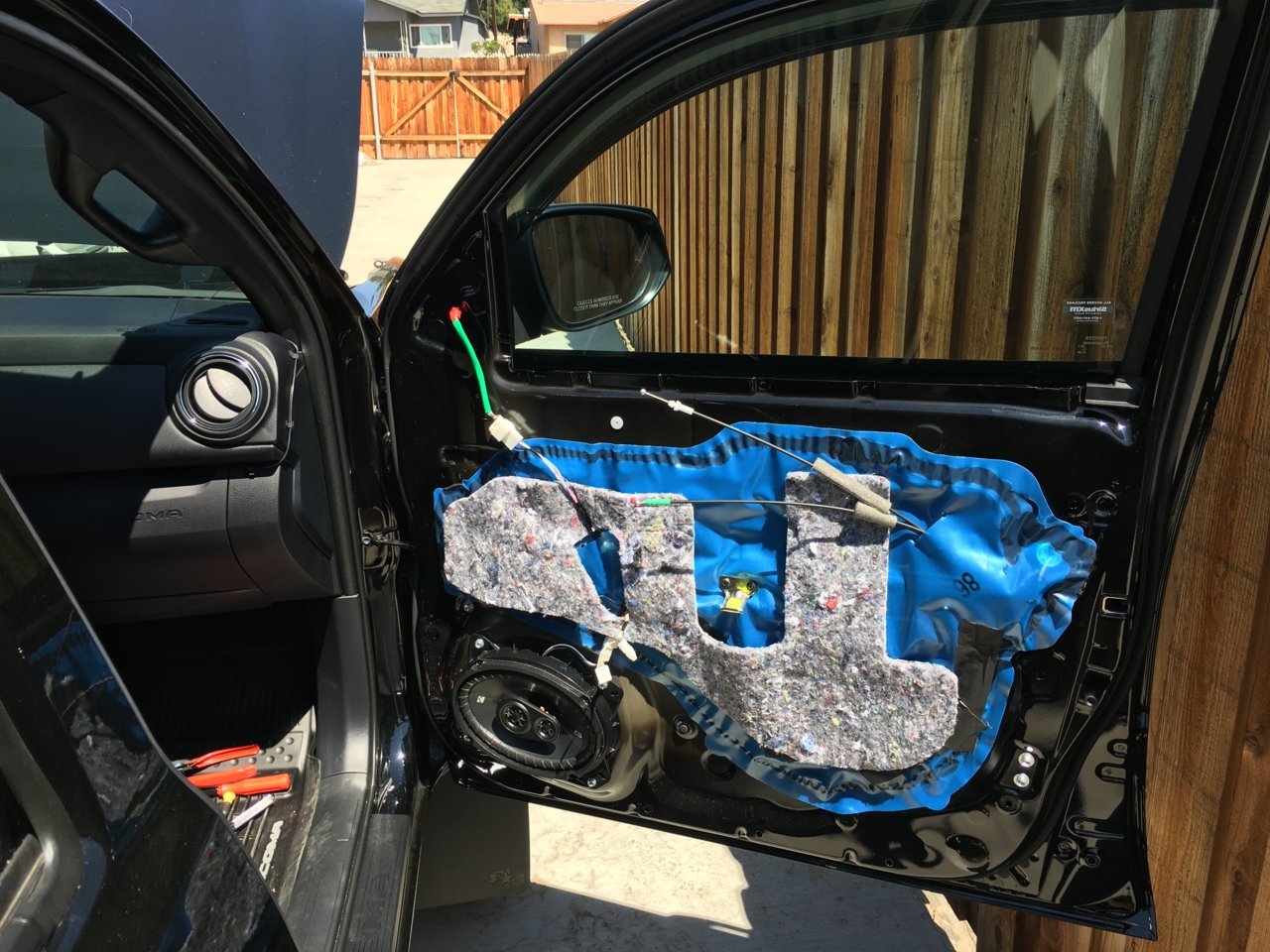

    Finally installed ! Managed to add Noico 80 mil and still kept under $250 budget !
    Tweeters/Fronts/Rears ... now for a beer.
