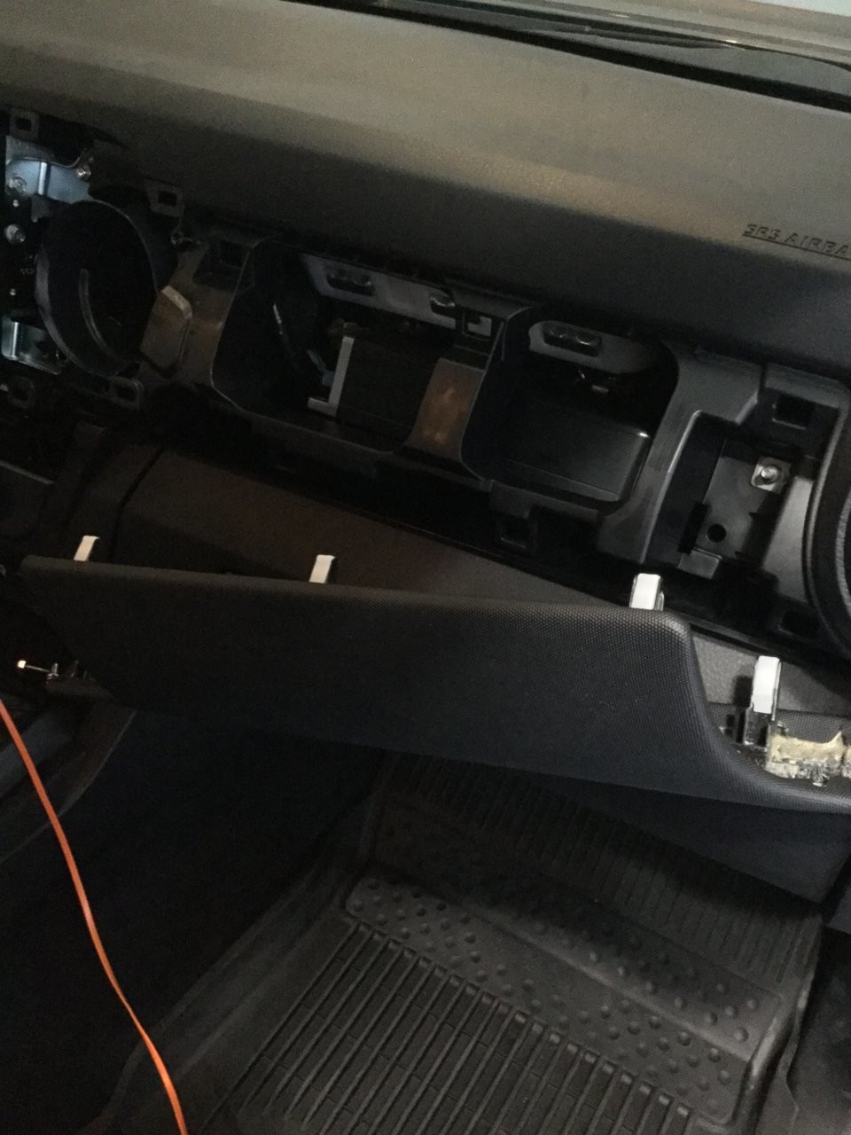

    Ok so I got the Kicker Key amp installed behind the dash. I Velcro’d it to the bottom of the deck. Tight squeeze but it fits. Now for the sound. It’s definitely louder. I used to be able to turn the volume up to 40ish, now 25 is blaring! There is also slight white noise when the deck is on but not playing music. When I turn off the truck there is a quick high pitch squelch/squeak before it turns off. I used the auto set up with an aux cable playing pink noise. Did I do something wrong? It now sounds like I have too much power for these Kicker CS speakers. Should I try and auto tune with the pink noise slightly lower in volume? I had it on 46 for the set up.

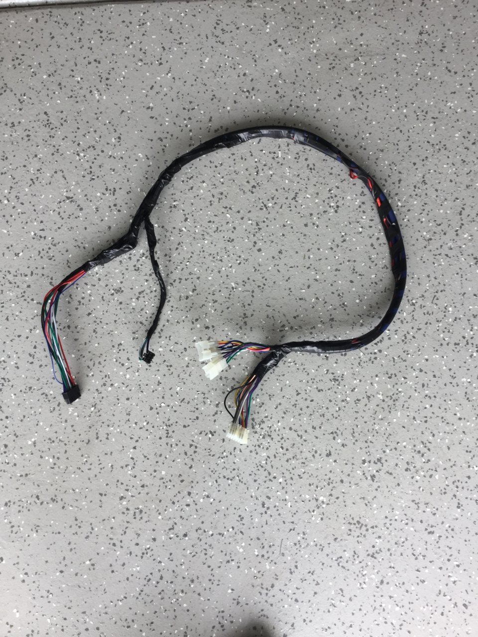

    I got it all done. Took several hours to solder my own wiring harness. It was difficult at first but then I got the hang of it. I stuffed the kicker key in the compartment above the glovebox behind that textured panel and secured it with several portions of Velcro tape. I left it exposed and shut the car off and it did indeed cool down so I know I got all of the wiring right and it’s not constantly on.
    As for sound quality, I’m happy. Not thrilled, but happy. I’ll give it a few weeks before I make my final judgement but knowing how much I like to tinker, I’ll probably rip it out and do something else (likely starting with a decent head unit).
