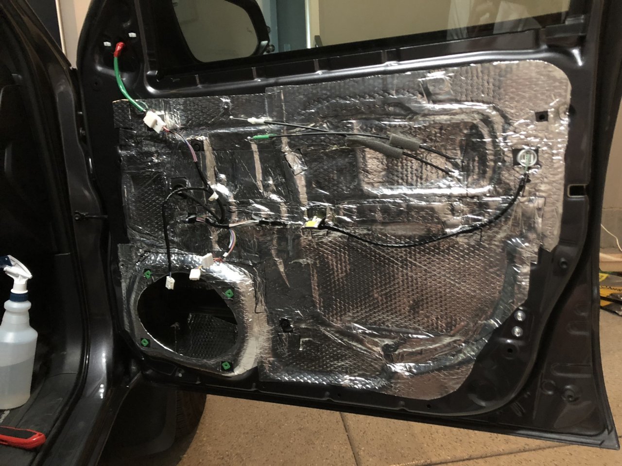

    Soundproofing the doors should eliminate any rattle

    I have zero rattles with regular woofer drivers (Morel Tempo Ultra 6x9) set at 70hz, that have way better low end than the kickers. A little prep work goes a long way.

    Already done. The rattle is coming from the plastic interior shell. If I push on the upper part where the door meets the dash it stops.

    Holy crap. Your door could be a Faraday cage.

    Put some sound deadening on the inside of the door panel

    I’m going to put some padding on the sides of the dash where it meets the door. I’ve done that with previous cars and it’s worked.

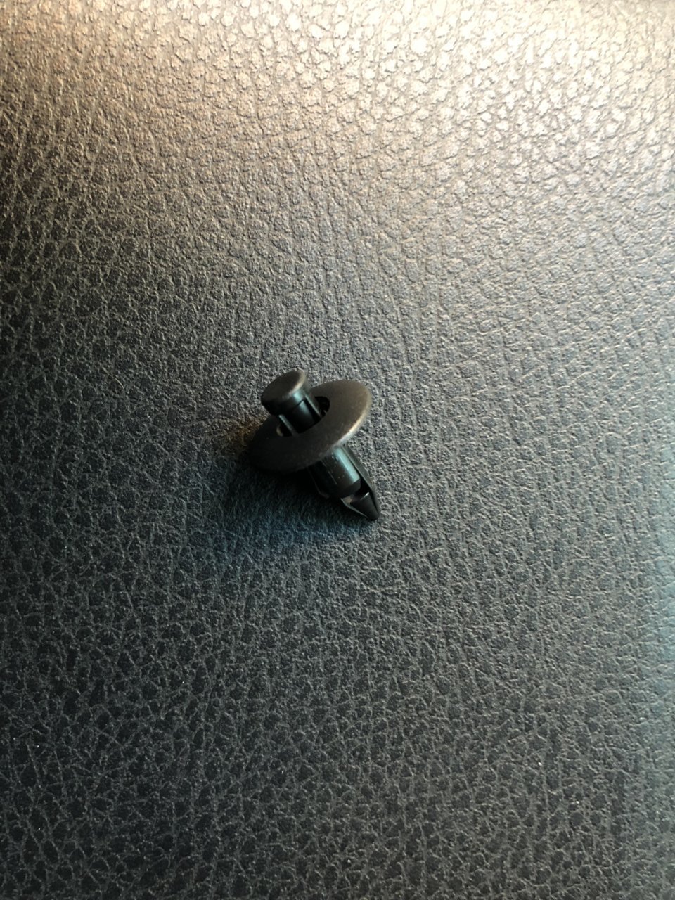

    Anyone have a part number

    90467-07085

    Loose one? They are reusable. You just re-set the center stud.

    Haha. I had one break on me. Well I stepped on it lol
