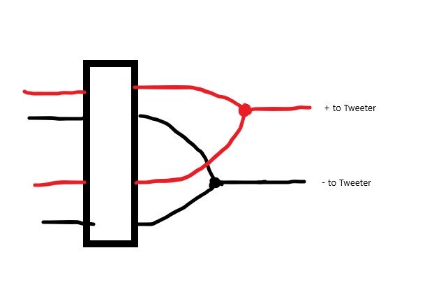

    Looking to maybe change out my door speakers as well now and I'm considering getting the JL Audio C1-690 components 6x9's. They have an in-line crossover for the tweeter, so would I be able to use the ********* adapters (or build one myself if anyone knows what kind of connector I need to order as I've already thrown away my stock tweeters) without running new wires through the door? I'm thinking I would just need to create a Y above the connector so that the full signal flows to the door woofer and the tweeter, so long as I don't remove the in-line crossover to the tweeter correct? Pardon my paint skills:
    Otherwise I might just keep the Subaru Kicker tweeters in and toss the JL tweeter but that seems wasteful to me...

    Ehh, not really how these are wired up. Glad you drew the diagram though so we know what you are seeing in your mind.
    At the tweeter connector, two of the wires are coming from the radio, and the other two are going out to the door woofer. To use the JL speakers you listed, there will be some cutting and splicing involved. This can be done with simple butt connectors and a pair of crimpers. Or you can solder if you prefer
    for the drivers side for example
    connector will need to be cut off (cut it with maybe 2 inches of wire left on the connector so it can be re-attached later if need be)
    Purple/black (+) and purple/white (-) are coming from the radio
    Dark green (+) and light green (-) are going to the door woofer. Splice these together, and also splice in the + and - for the tweeter crossover. Now, you have a signal going from your radio to your door speaker, with the tweeter wired in as well
    passenger side colors are
    purple/red (+) and purple/green (-) from the radio
    grey (+) and blue (-) to the door woofer
