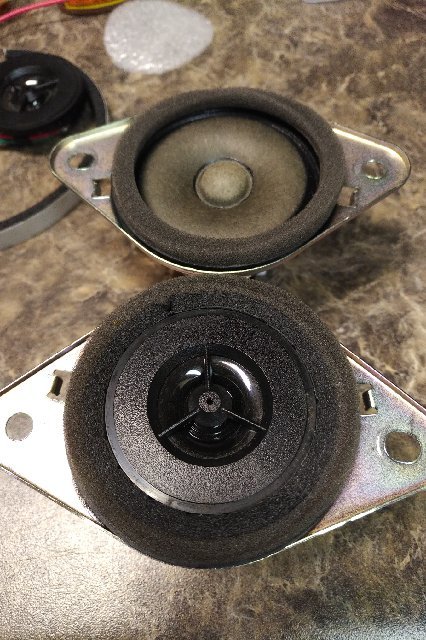

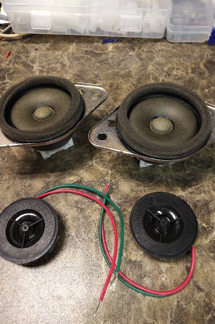

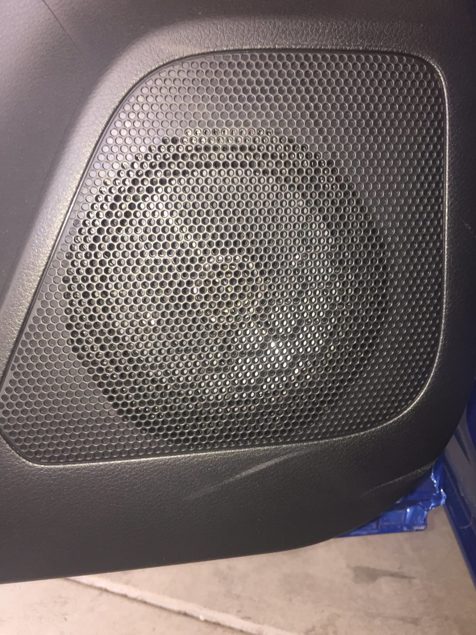

    I just replaced the crappy tweeters by cutting out the entire cone and voice coil and installing Bose units inside the OEM bracket.

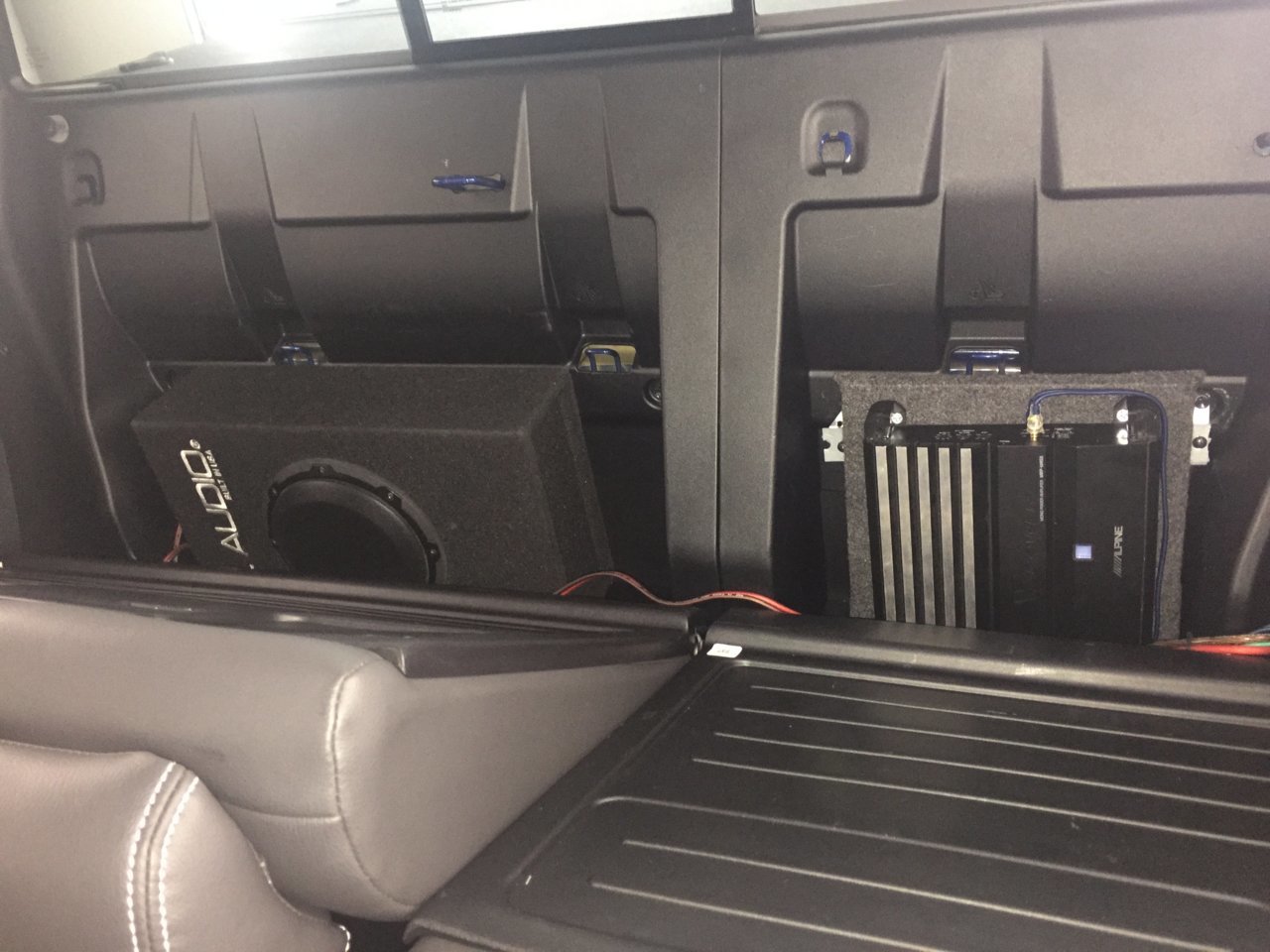

    K So I pulled the gun and completed the system with the kickers in the doors also .. my thoughts definitely a lot clearer sound . Good highs and mid's now for you bass junkies this setup by itself hits most bass loads but most are none existent don't expect a 6x9 to sound like a 10 inch sub .For some its enough for me I wanted more so I went to a stereo shop said even if I added a amp on these speakers u still wont get that low bass out of these speakers they will just be loader that's it … so what to do next hmm well I decided go a step further and run a JL audio micro sub these things are unbelievable in sound cant even describe it till u here it your self . they do come with a built in amp or without and only require 250 watts max .Over all I can say kudos on the speaker recommendation . Hope this helps others to decide .

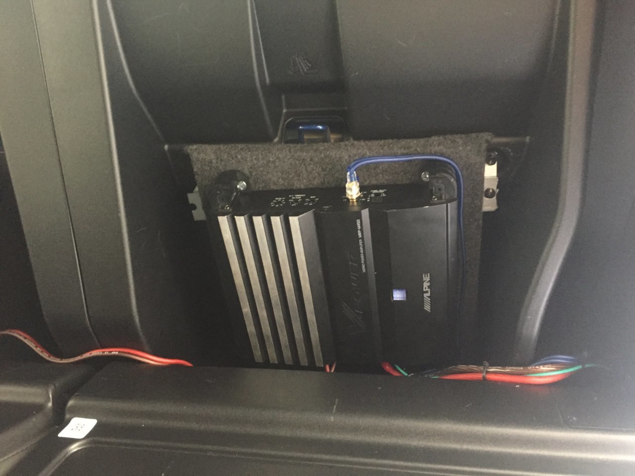

    K Sorry for the delay, hear is my build. I went with the Subaru tweeters no pic it was hard to get a pic with them in . The doors kicker CS series 6x9 in the front and the 6 3/4 in the back . for the sub I went with a JL audio 8" sub got it used for 140 bucks on offer up . the amp I already had alpine 450w mono amp pushing at 220w at 4homs .Plenty of power to run that sub since the max u need is 250w figure under power it a little bit to extend the life of the sub .Don't get me wrong with only 220w that little sub is a ear full lol .So I had a local shop install the amp kit and the amp at first hated the way they mounted the amp in the back so I decided to build my own rack . I bought a piece of pine at Lowes had them cut it to my spec. Wish I had measured it better … lol .. I bought a perforated piece of steel to mount the board to. So there is 2 screws on top that hold the plastic box in place, my original thought was to use the steel bar and mount it to those by using longer screws . Well since I cut the piece of wood a bit larger than what was required it didn't line up very well .So I improvised I got 2 L shaped mounting brackets mounted those first to the screws holding the box then I mounted those to the metal bracket .At the end it worked out better . I posted a pic of the material I used to build the amp rack if anyone else is interested to make one cost me around 25 bucks to build it . So System is done time to move on to off road stuff … lol its never ending … IMG_0033.jpg IMG_0034.jpg IMG_0035.jpg IMG_0036.jpg IMG_0037.jpg IMG_0032.jpg
