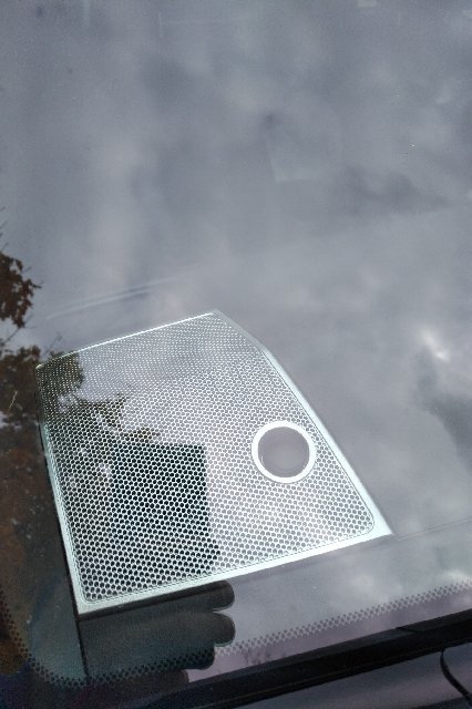

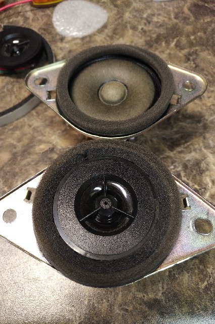

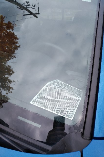

    I have already built my harness to run to the back subs(1x 4 channel Alpine and 1x mono Alpine with pics to follow). I am adding a set of Bose tweeters into the rear panel and will feed the unused rear channel output from the head unit to the tweeters. By using the fader control I will be able to adjust the volume of the tweeter output. I have 4 tweeters, 2 are installed as an upgrade in the front already. Before: top bracket, After: lower bracket

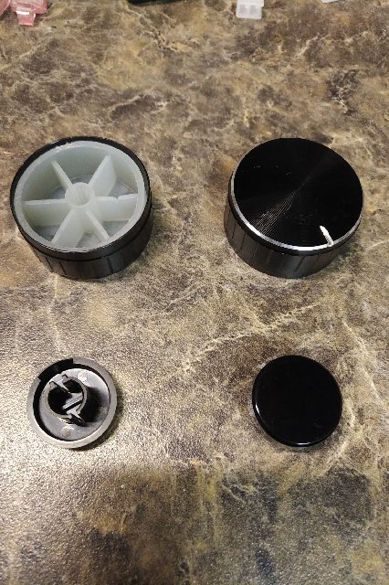

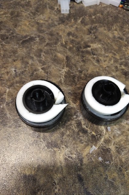

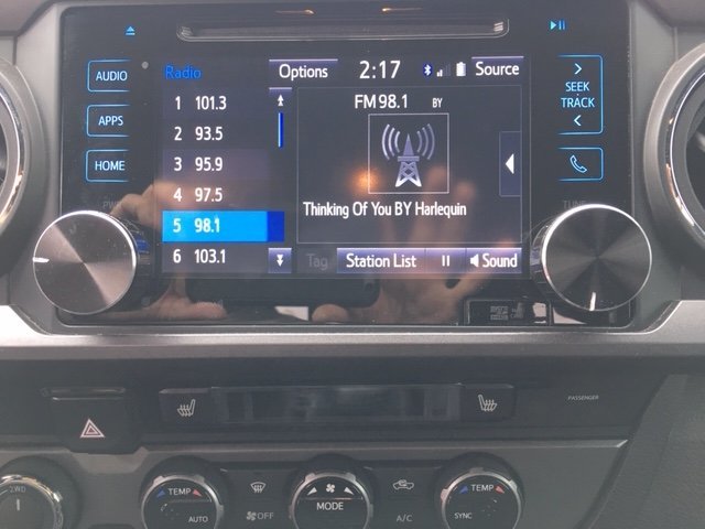

    Decided to do something about the crappy radio knobs today. Found some larger aluminum knob and inserted the OEM knobs inside with contact cement.
