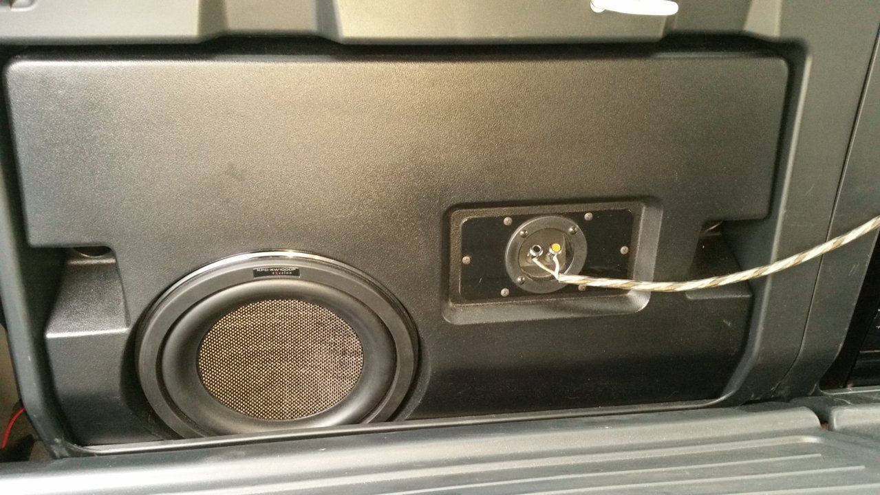

    Finally finished up the install in my 2014 DCSB with Entune non JBL. I am not a super audiophile, but wanted some better clarity and a little bump. I am using the stock head unit, Memphis Audio 15-SRX60C components up front, for right now the stock rear door speakers, Kicker Key, an older Rockford Fosgate P325.1 amp, an LC2i, and a Kenwood Excelon KFC-XW1000F 10 inch shallow mount sub in a Schosche TATAC05 enclosure. I already had all of the wiring from previous installs that I just re-used. Also, make sure you check the Crutchfield Outlet. Sometimes they will have what you are looking for a little bit cheaper. I found my Kicker Key there and was able to save a few bucks.
    I received the LC2i and a Pioneer TS-SW2502S4 sub last year for Christmas. I would have used the Pioneer sub, but the funky mounting ring wouldn't fit in the Schosche enclosure. So I had to get a different sub. I picked up the enclosure for free from a guy on the Toyota Nation forum. The enclosure fits in the stock right storage bin like a glove. The only thing I don't like about it is the mounting spot for the speaker connection. If I designed it I would have made it so that the speaker connections were in the indentations for the mounting bolts.

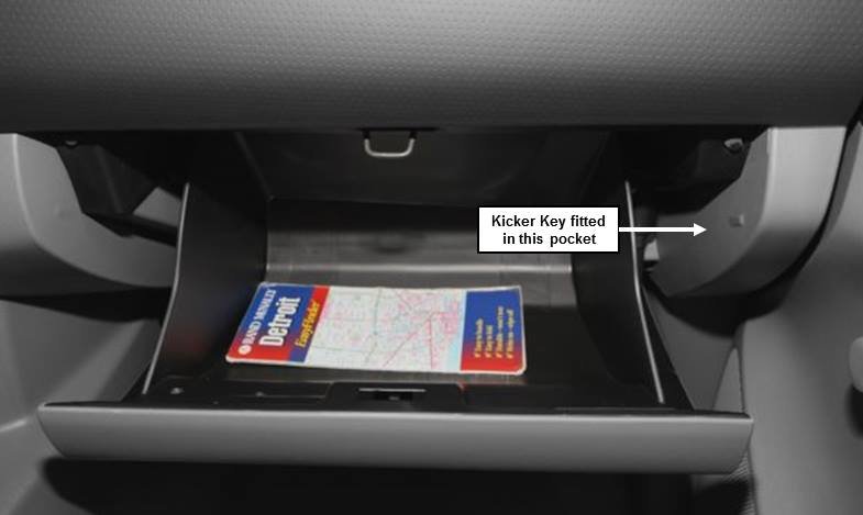

    I mounted the Kicker Key in a little pocket on the far right hand side of the dash just to the right of the glove box. There is just enough room to mount it in there. If you pop off the little cover on the side of the dash, that provides access to make any adjustments to it after it has been installed. This placement also makes for easy running of the wires to the rear of the truck since they can immediately route behind the kick panel. Additionally, there is a rubber grommet in the firewall that is a great location to run the power wire from the battery through. There is an identical rubber grommet on the drivers side slightly behind the brake booster to run the amp power wire through.
    46190775_10213371848676329_1443142413416_c08ea5146ffb233db1df0fe116ea1956918908ec.jpg
    When I built my T harness I just had to extend the wires to and from to get to the KK. There has been a lot of discussion about the orange wire with a black tracer on the Metra 71-1761 harness. Some say it isn't necessary to use some say it is. I had to add a wire to the mating Metra harness (70-1761) in order to have the button lighting and brightness control of those lights on my head unit. I didn't go through the ordeal of removing any of the remote power blue wires. I had the pins and orange wire in my spare parts bin so I just made my own wire.

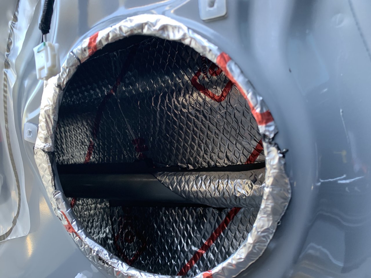

    When I mounted everything in the doors I used butyl tape vice that sticky backed foam. In the DIY: Basic Speaker Upgrade thread it was mentioned to use some 3M strip calk. A box of that will set you back about $30. For $8 you can get a roll of butyl tape at just about any RV parts/repair place. It is usually about 1" wide, but is easily cut with a razor. This is the same stuff that the stock vapor barrier is held in place with and is the same stuff as the 3M strip calk, just a lot cheaper. If you are going to be using the stock wiring like I did the Metra 72-8104 speaker adapters are worthless. Taco tunes sells the adapter you need to connect to the 4 pin connector, but I found that $20 plus shipping for two connectors and a bit of wire a bit expensive. I did manage to track down the manufacturer of the connectors, but that info is on my home laptop. If I can remember when I get home I will update this thread with that info. I decided to de-solder the wires going to the stock tweeters and extend them to the crossovers.

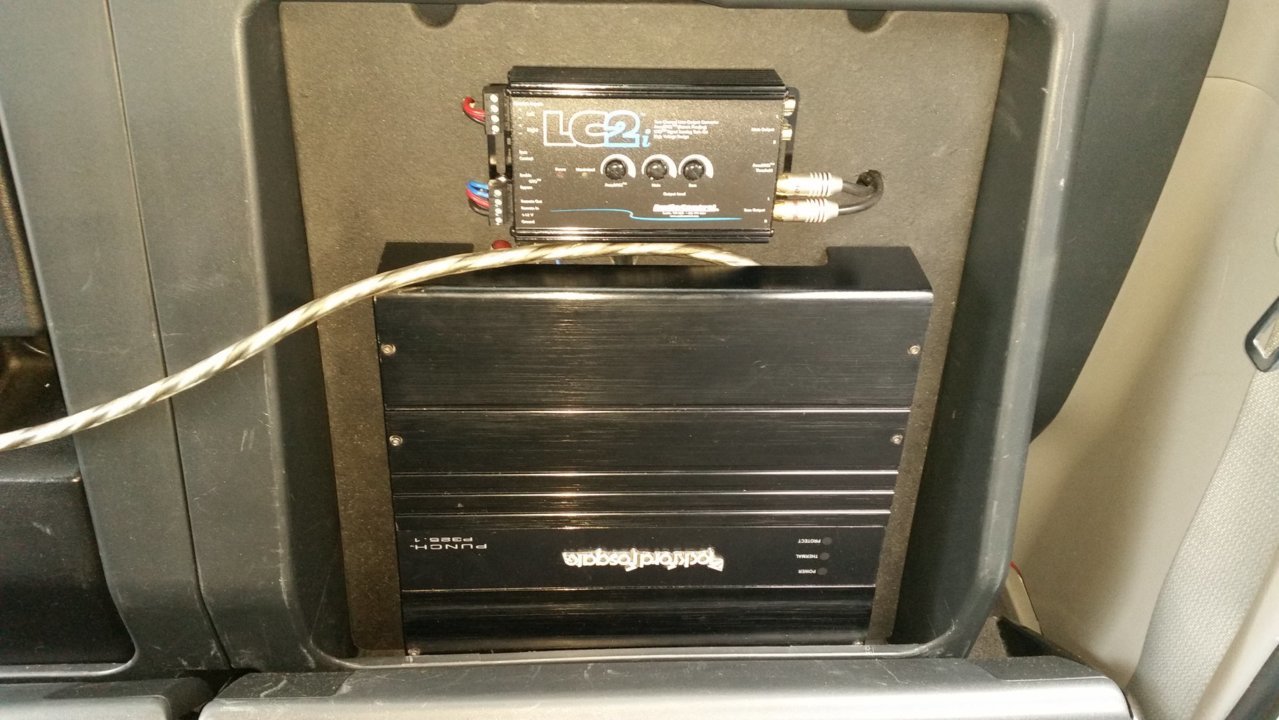

    Onto the amp rack. I wanted as much of the wiring hid as possible. I used the pic below as a basic template for mine. Everything mounts to the other side of it. This allows space for all of the wires to hide behind. Mine is a bit taller than the pic below so it would fill the entire storage bin. I also cut out a bit of the top brace to feed the wires from the bottom to the top. It is held in place in the storage bin with some double sided foam tape. The front of mine is not permanently secured to the bracing either. I used a couple pieces of Velcro to attach it. This allows me to easily pull the it free of the bracing in case I need to get behind it for some reason and to provide a bit of room for my hands when feeding the wires through. That is why I have the two notches at the top. Those allow me to get my fingers in there to pull it free of the bracing. I used some truck bed spray liner to cover it.
    46136842_10213371935238493_2338869778711_f87e2d185c8f3af83b5aa8d047c9dc0358a4ff18.jpg
    I wish I could say everything went without issue, but that wasn't the case. I didn't like the way the power and ground wires were routed through the hole in the amp rack to the line output converter (they crossed vice being flat) so I pulled them back through the hole to adjust them. When I did that I forgot to pull the fuse. Of course the wires touched and there was a very small spark. Got everything the way I liked and went to turn the head unit on. Nothing. The only light I could see was the power light on the line output converter, but the head unit didn't even think about showing any signs of life.
    Started checking fuses and everything was good. Power was getting to the amp and line output converter, but I wasn't getting any power on the remote wire from the head unit. Of course my mind immediately sunk and I thought I just killed the head unit. Decided to check things again and I found a second fuse for the head unit. It has a 20 amp and a 30 amp fuse. The 20 amp fuse had popped. Swapped that out and the head unit turned on. Whew.
    Overall I am now happy. I have a great sounding system. The Kicker Key really changes the dynamics of the sound. I heard things I never knew were in a song and everything is so clear sounding even at max volume. Although, I am still a bit disappointed in the overall loudness. I was hoping I wouldn't have to turn it up as much to get it to scream at me. I have to remind myself that the Kicker Key only puts out 45 watts per channel. That is about what a lot of aftermarket head units put out so the overall volume isn't going to be that loud. The only thing I don't like about the looks is how the speaker wire runs from the amp to the sub. The speaker enclosure has the connection right in the front of it. With the seats up you never see it, but I know it is there. I may go back and drill a hole between the two storage bins behind the amp rack and have the wire come out where the indentation is for the mounting bolt. That way all you would see is about 4 or 5 inches of the speaker wire.

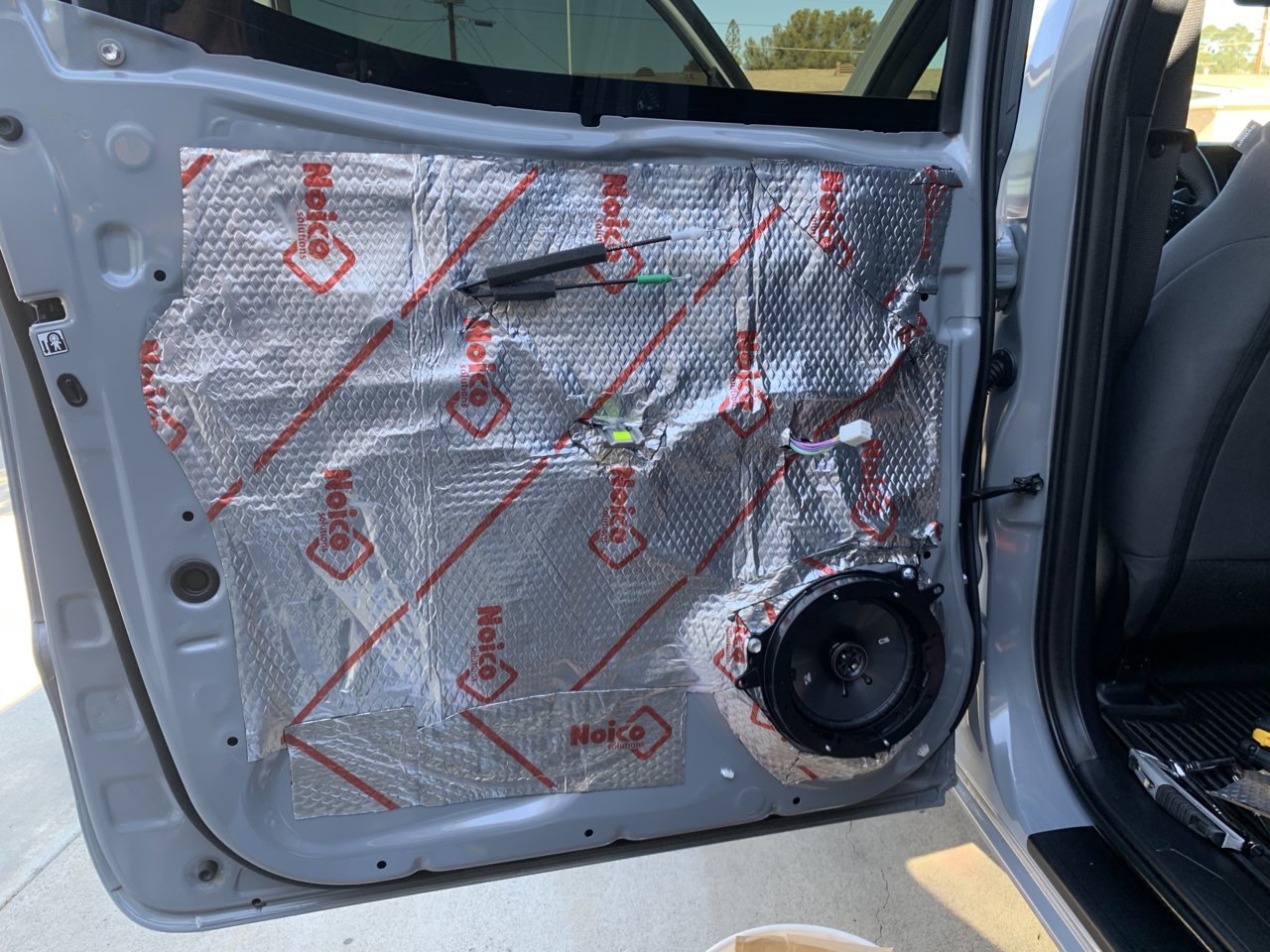

    157FBDA9-5C73-43E6-8049-ED7CE9E59A82.jpg Kickers and some noise dampening

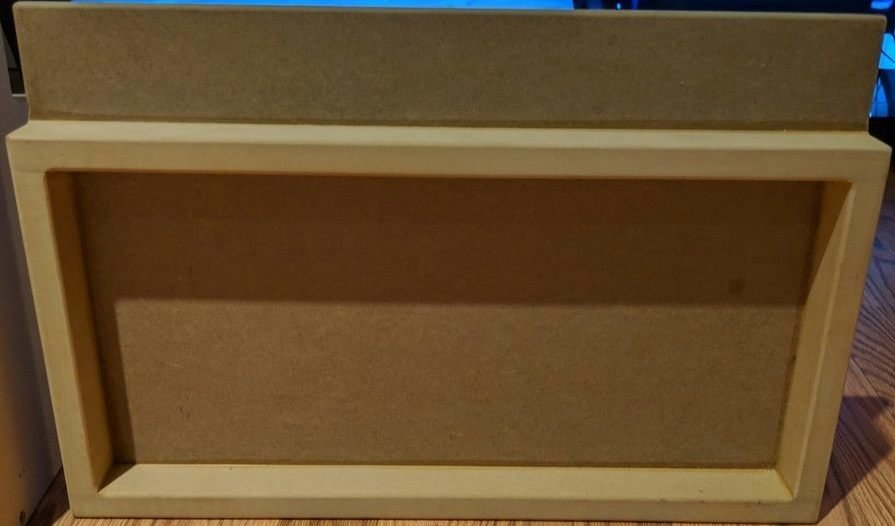

    TRD emblems, tinted windows, OEM running boards, AVS vent shades, RMAS upgrade, LED lights in front and rear, interior LED lighting upgrade, LED lighting in bed, touch control dash mount for LED lighting, auxillary 12v and USB jacks in bed, replace all speakers with Infinity, custom mod with Bose tweeters, TRD Pro illumination mod...

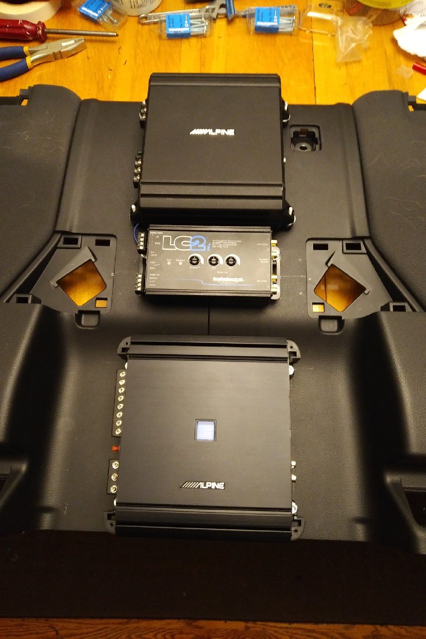

    This is what is lying on my dining room table currently.
