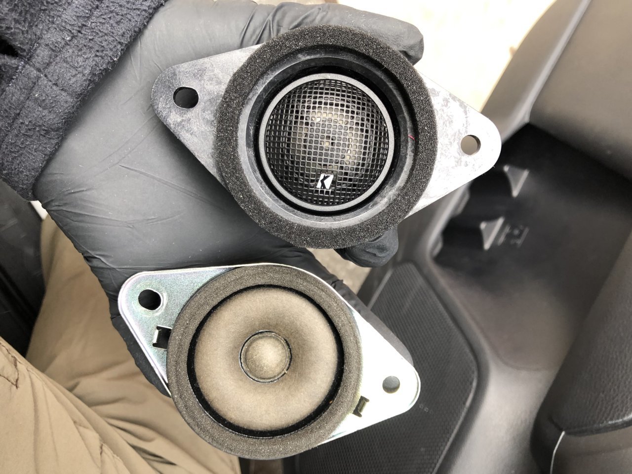

    Just swapped in the kicker Subaru tweeters, CS front and rears, and sound deadened all 4 doors.
    Love the improvement!! Though my hands and arms look like I was attacked by a cat.
