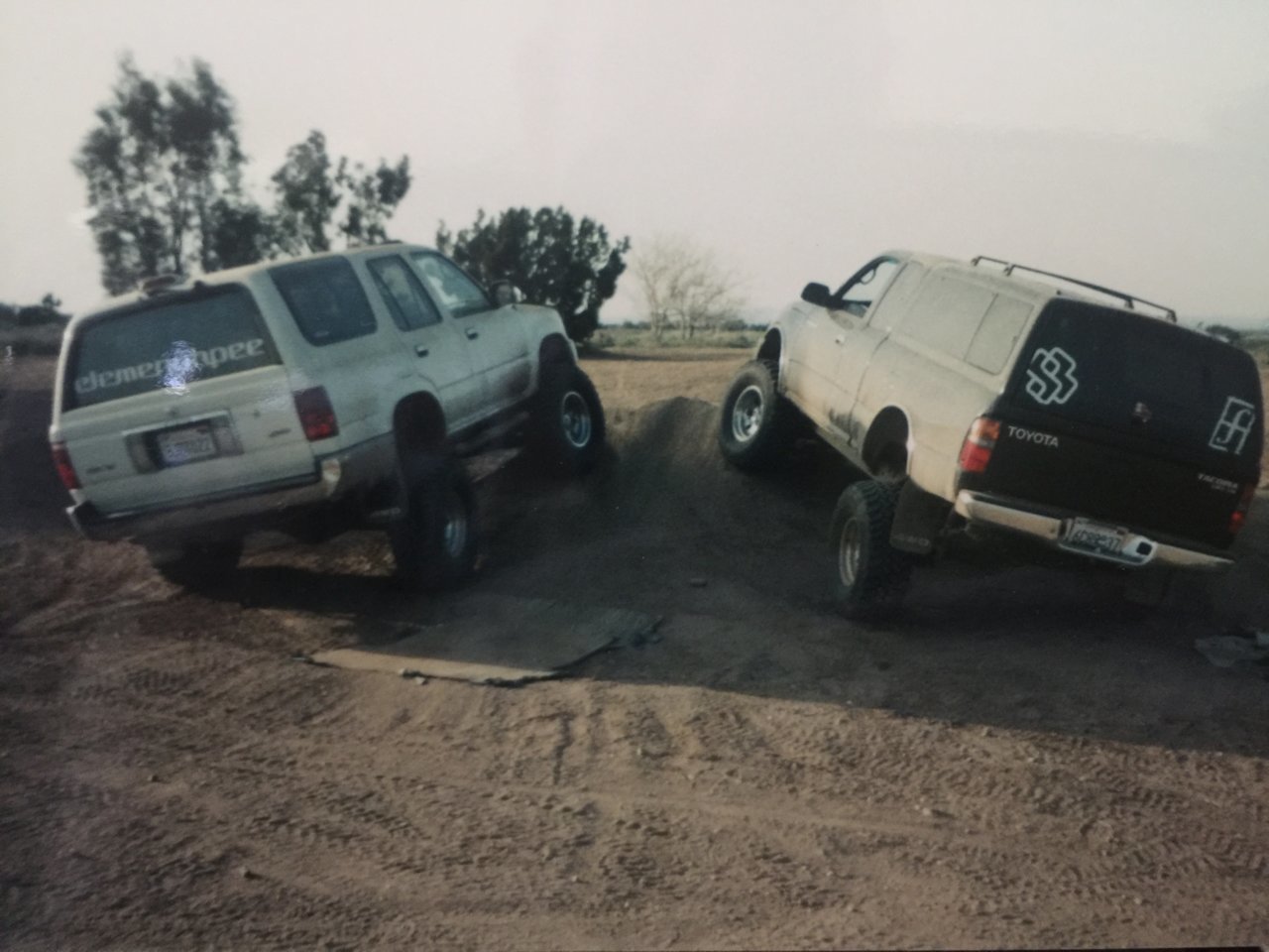

    Thanks for the info!!! I used to like loud thumping music and turning it up all the way but as I’ve gotten older, just good all around quality sound will just do. My first 4Runner when I was 17 had 4 JL Audio 12” subwoofers with 2 amps and those days are long gone lol

    holy smokes? Did you have multiple batteries setup for that kinda noise?

    Lol no I was young and stupid and went with only one aftermarket battery. Never had my stereo on when the engine was off. Definitely not the right move since all the lights would dim every bass hit so probably the wrong setup. But you live and you learn.
    I will say though, it was one of my favorite truck/suv I’ve ever owned.
