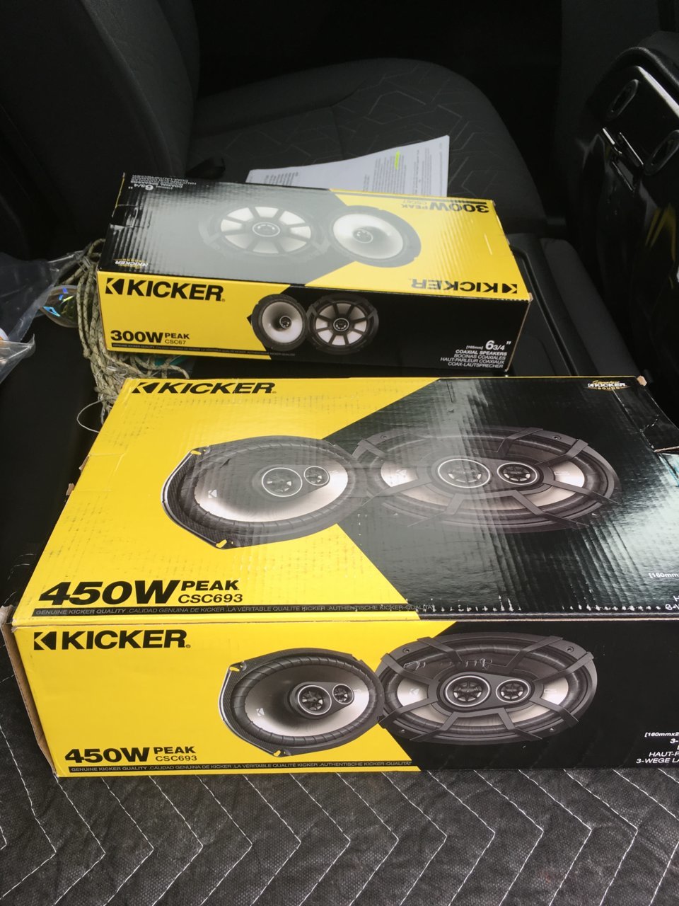

    Hey everyone, sorry if this has been listed already but Best Buy is now selling the popular 6x9 and 6 3/4” speakers for 60 and 40 dollars respectively. I purchased them when they were a little more and was able to twist some arms at Best Buy to include the adapters, but was just able to get them to price adjust to their new lower price. Just an FYI out there for those looking to get these speakers while they’re still available! I have them amped with an alpine power pack and Subaru tweeters, nice upgrade from stock but I am going to need to deaden the doors now.
