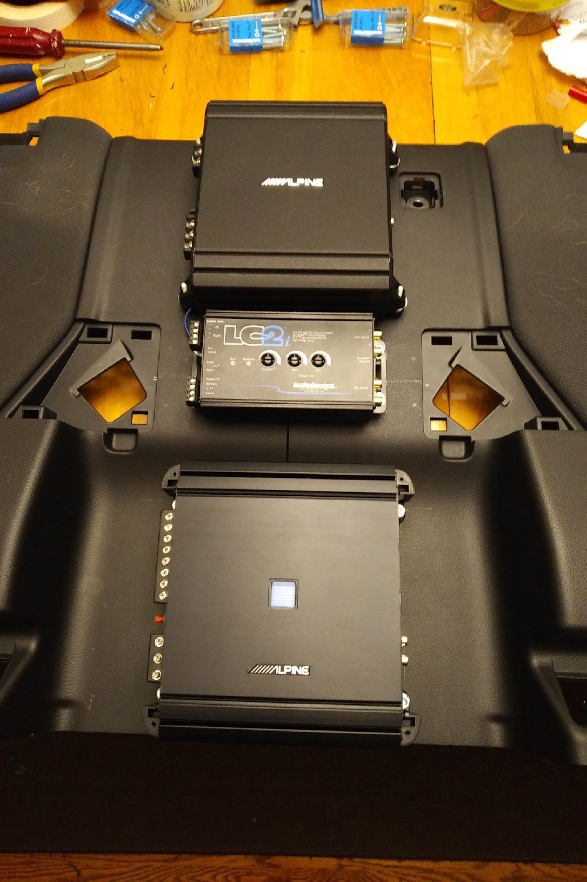

    This what I am building. It will power all 4 speakers evenly and the tweeters up front. Going to "T" into the factory wire harness, amp the front input, then output to the 4 doors.

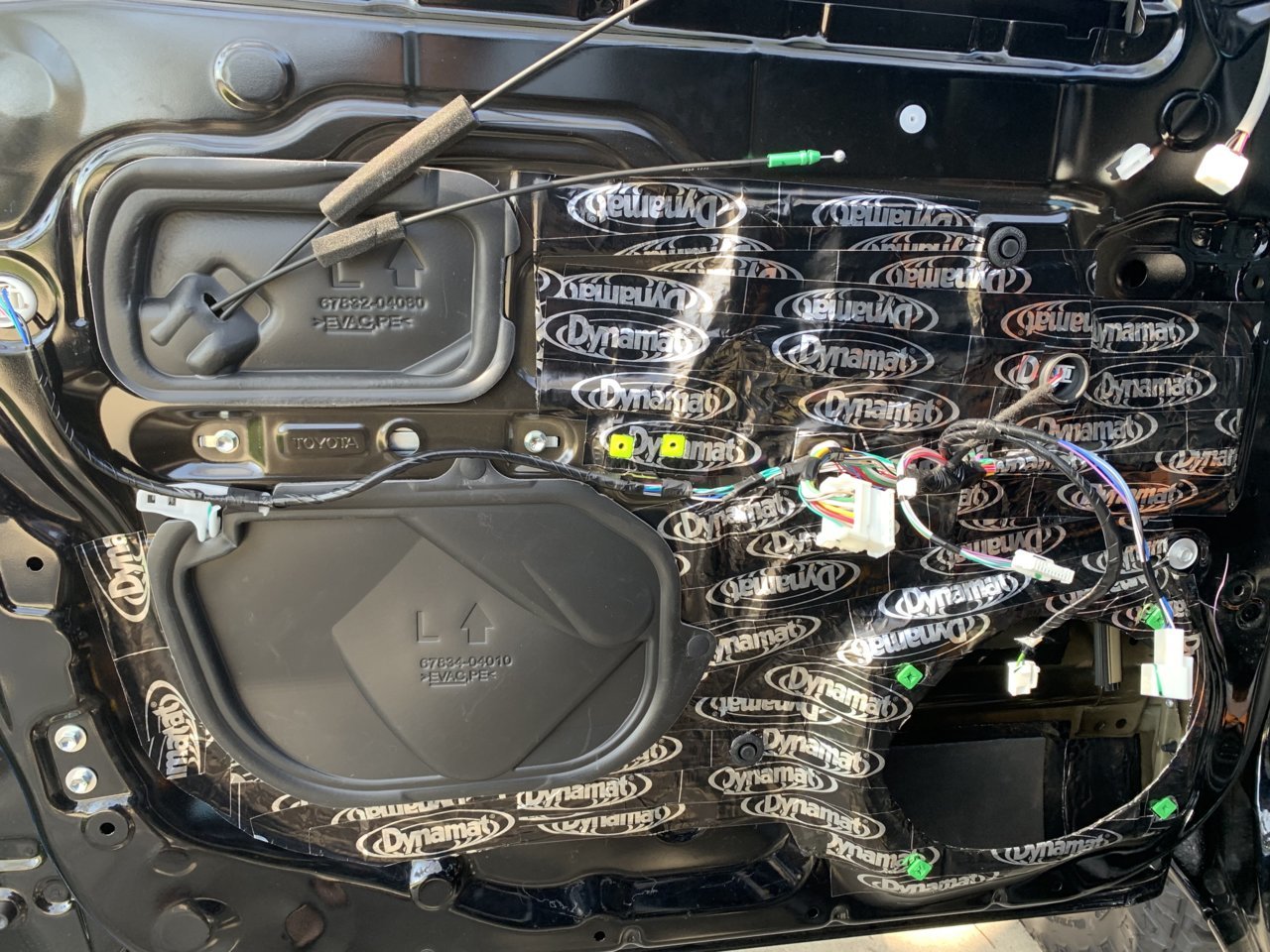

    This is the finished product for the driver side front door. I feel like this level of sound deadening wasn’t necessary for these speakers but I figured why not..

    Did you take any pics of the sound deadening that you did?

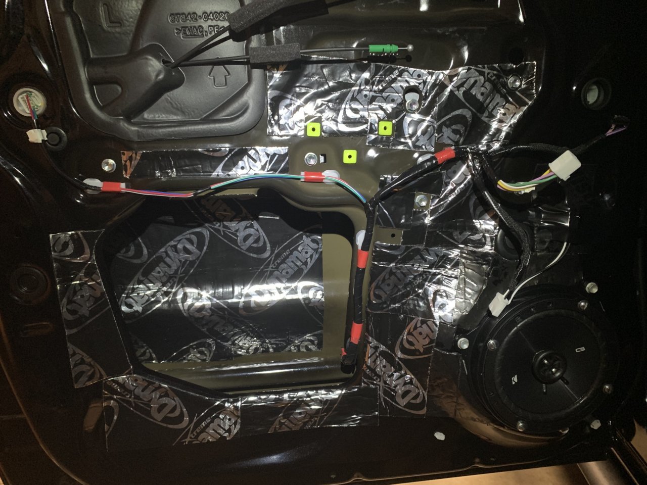

    Here’s what I did. Seems to have cleaned up the sound a lot to me.
