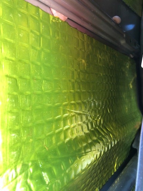

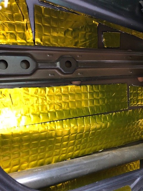

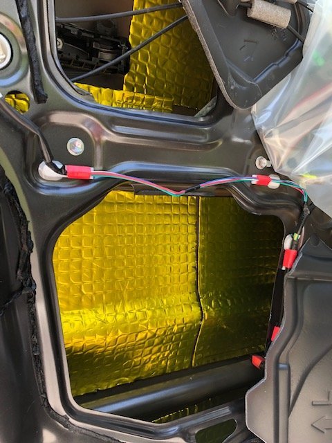

    Finally got the sound abatement in and speakers replaced.
    bshammer0[OP] likes this.
