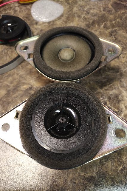

    Bought all the speakers the OP posted when he started the thread .Installed the tweeters right away and the were a big difference . Finally got around to installing the door speakers today . Nothing crazy better , but definitely better .

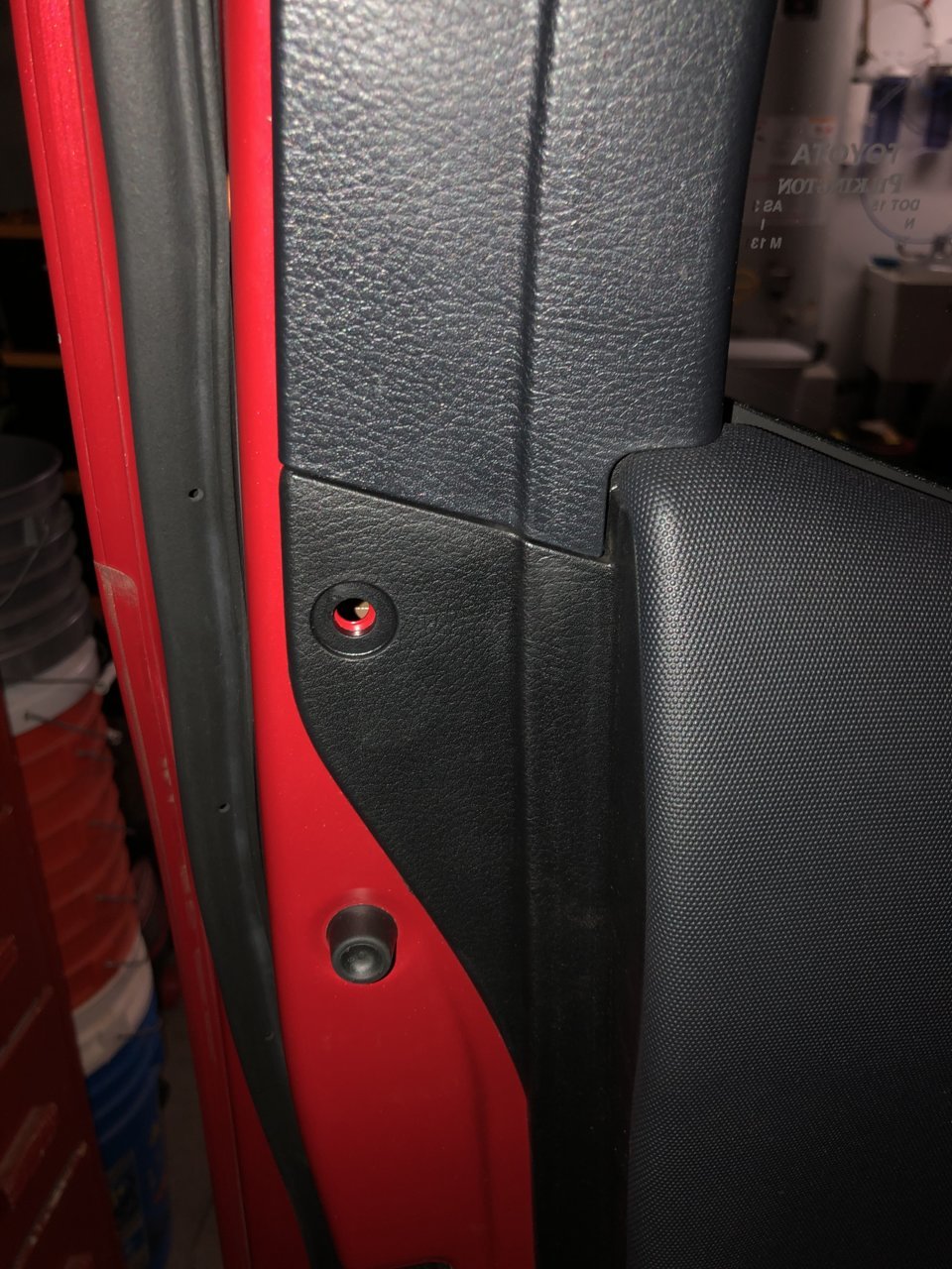

    Does anyone know the part number for this fastener?

    I believe you're looking for part
    90467A0016C3

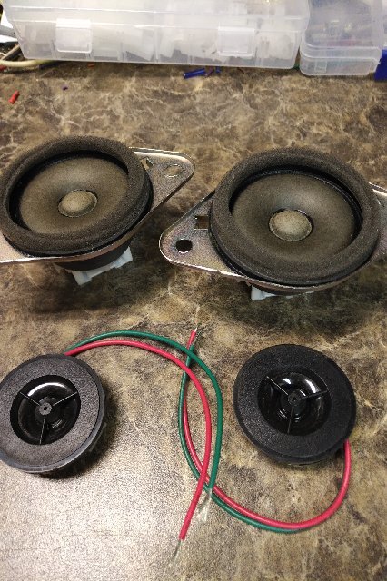

    No issues. Took a bit of fine soldering to connect the tweeters but that's it. I had them in my pile of audio equipment and they just happen to be the right size to fit in the OEM frame with a length a weather stripping around the Bose tweeter to secure it.

    This was definitely one of the best purchases I made, I started with the $90 tweeter upgrade in the front. After hearing it for about 5 seconds the smile on my face so was so big I instantly ordered 4 for the doors off crutchfield and installed them the second they were dropped at my door. Though now I hear a slight rattle in what I assume is the metal so I've gone ahead and ordered 36sq ft of the Noico sound deadening which drops tomorrow
