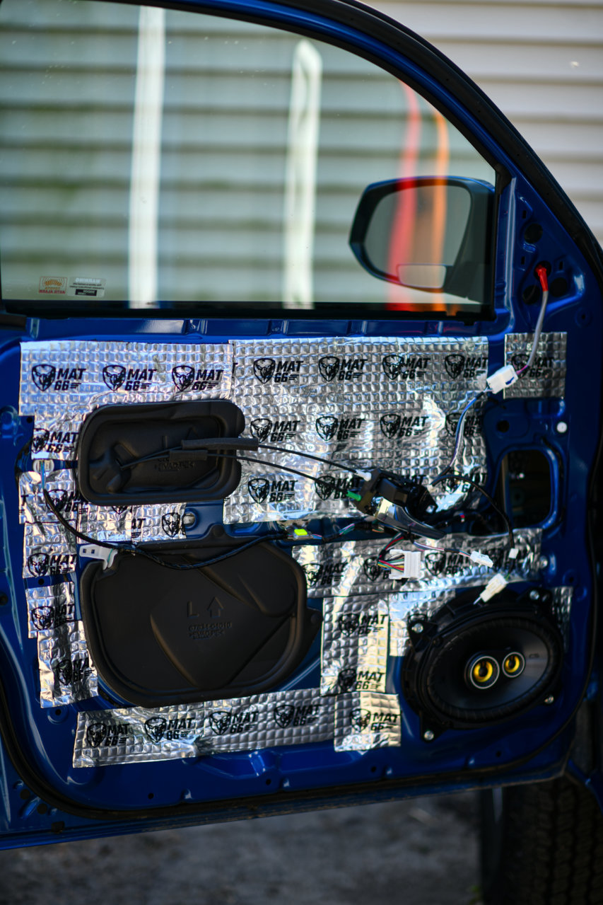

    For $35 of the 24sqft MAT 66 sound deadening I covered all 4 doors and it's already insanely noticeable in the change! Excited to do the floor and roof now!

    Did you do the interior of the doors too? Also doesn’t look like you used a roller much

    I did roll every inch of it, I also did the interior of the doors too! The roller effect didn’t really transfer much in the picture

    What's the black mat on the door? Does that come on our doors already or something you added?
