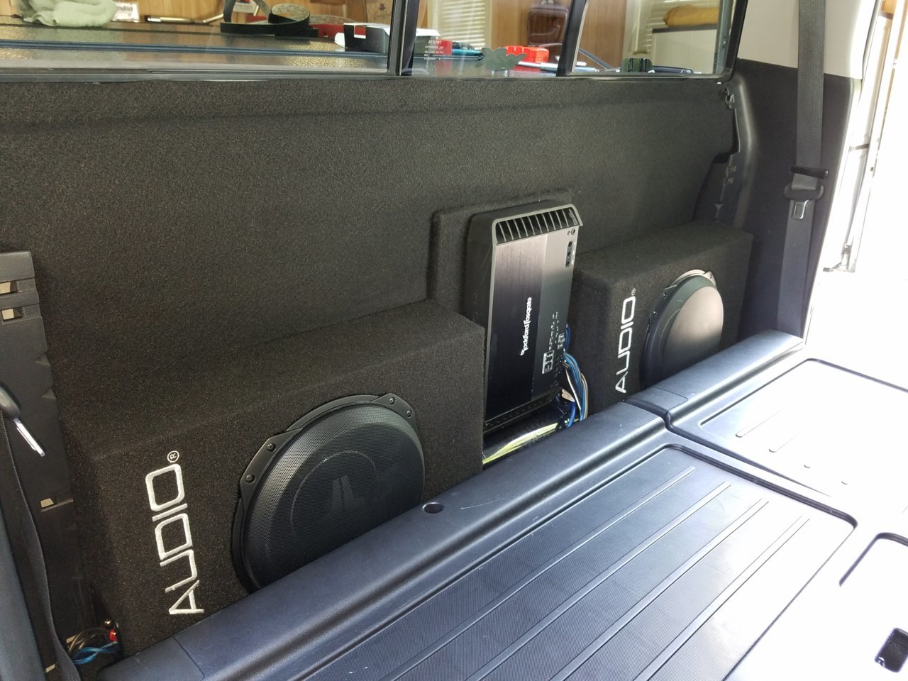

    Things
    How does one go about adding a mono amp from the stock non-JBL entune HU? I’m also wiring in the kicker key amp for the door speakers. Maybe best to return the key amp and just get a 5ch?
    I wouldn’t mind adding a 10” in the cubby behind the rear driver side seat, for a reasonable price.
    Most likely case is that I’d take both cubbies out and build a custom setup with 2 10’s in closed boxes.
    similar to the below, obviously not the prefab boxes though.

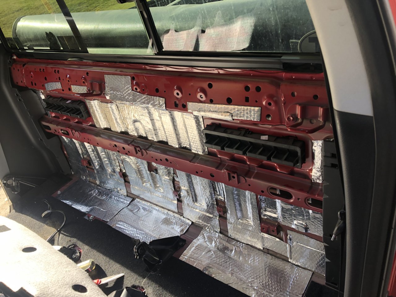

    I took the day off to get some projects done, for the truck I decided to use the rest of my Noico to deaden the back wall of the cab.

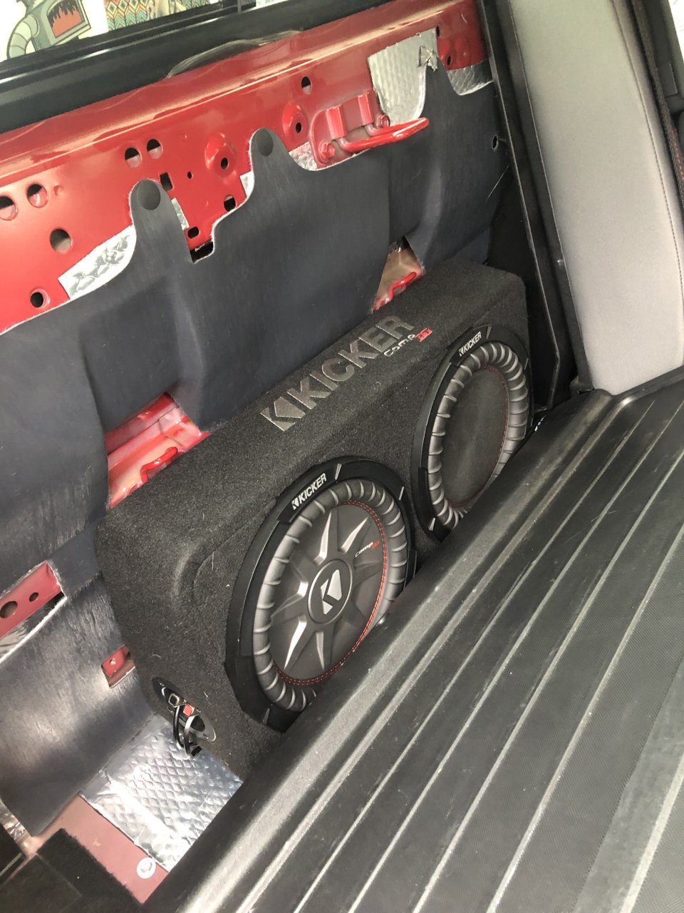

    I have a Kicker CompRT 43cwrt102 loaded 10” enclosure showing up tomorrow so I had to pull the panels out to trim the passenger side anyway. :)
    I also spent some time with the Key amp, resetting the gains as I think I had it a little too high. Mainly because the highs are a bit too bright. I decided to turn off the low pass crossover, and man I think i should have given the speakers alone more of a chance. These JL C1 6x9’s thump with the KEY powering them!

    Is that the 10”? Good to k ow it fits below the seat belt latches

    Yup it’s the 10. There’s maybe 1/2 between the hook and the top of the box. It also clears the seat back when folding the seat up and down. I’ll be trimming my rear cubby panel to get everything to fit like stock. Eventually...
