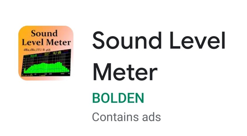

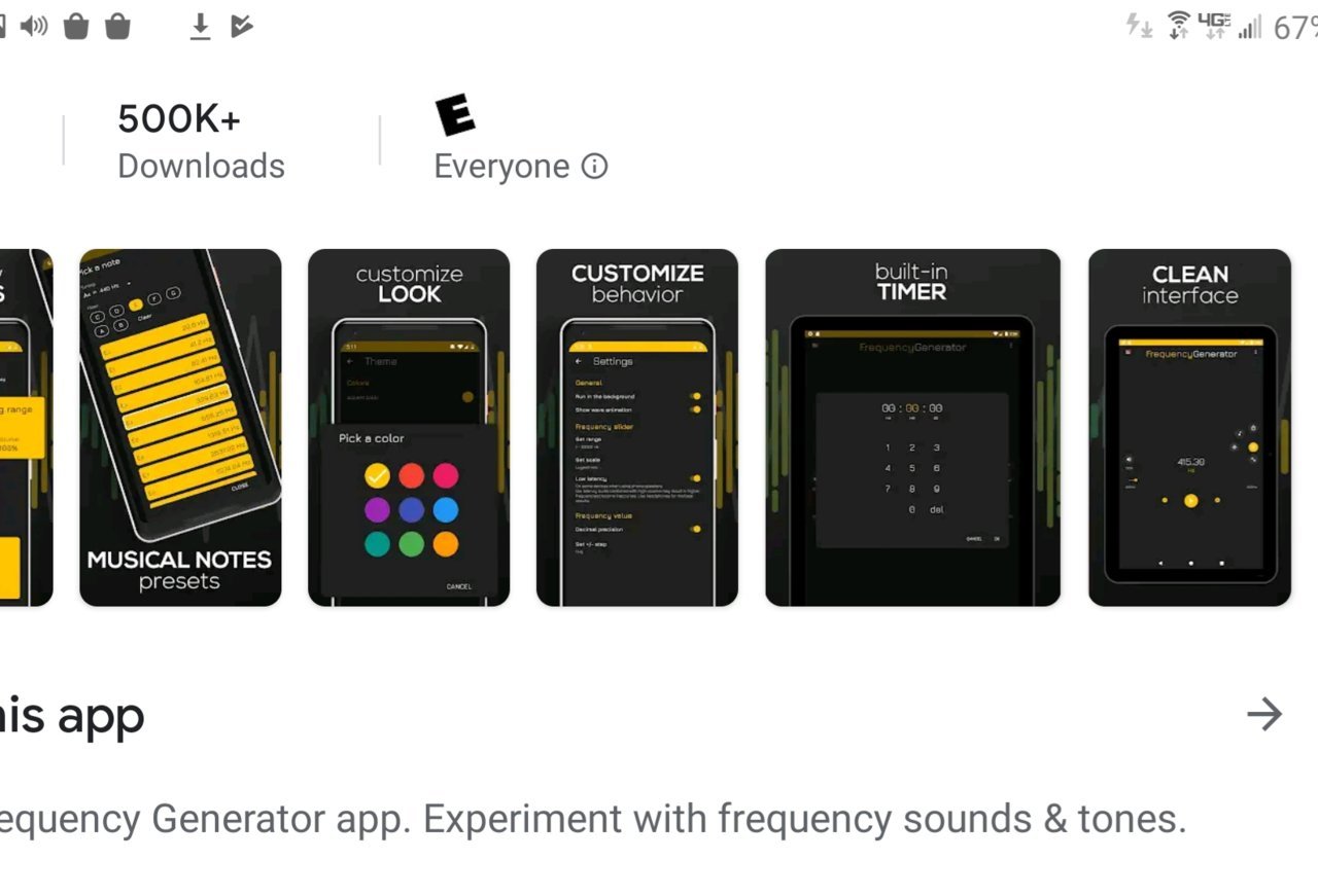

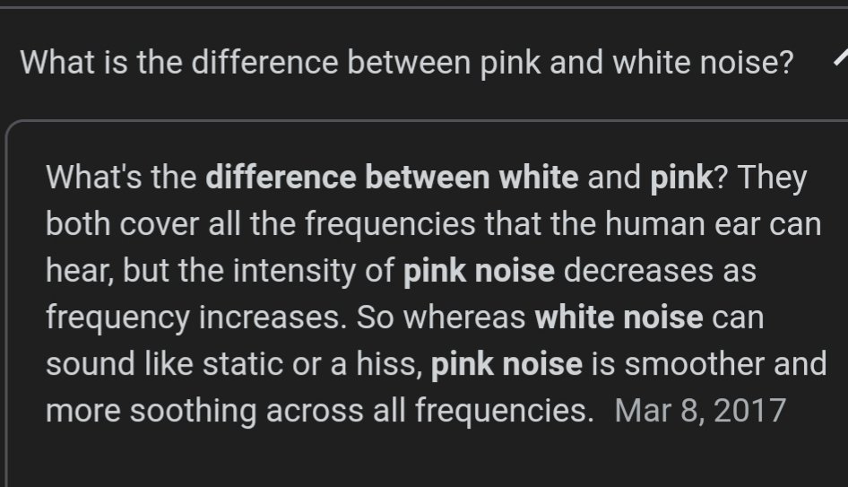

    More info and a couple of useful tools for the average car audio enthusiast that doesn't enter sound off competitions and doesn't have a DSP.
    With this app on your cell phone...
    ... you will be able to make your car stereo produce white noise...
    Then you can use this app...
    ... to literally see the sound and then you can use whatever means you want to smooth out the curve. When its properly set up you will see a frequency curve with no dips or peaks within the curve. Use things like this to smooth the curve, other that the curve being smooth don't concern yourself at all what the curve looks like other than smooth transitions. If there are no dips or peaks and you like the way it sounds you're done.
    Your phone will need to be able to run both apps at the same time and your audio system needs to have a way to receive the white noise generated sound (aux in, bluetooth, etc...).
    I just found these apps for this reply and I haven't used them ever... should work REALLY well for the average enthusiast. The sound level meter cuts the upper frequencies off a little sooner than I'd like it to but there really isn't much information that high in the frequency scale so no big deal. I can literally look at a graph and make a system sound great - with my ears plugged. You however probably aren't going to know what the curve you like looks like so set it up to where you're reasonably happy with the sound and then run your tests and make your adjustments.

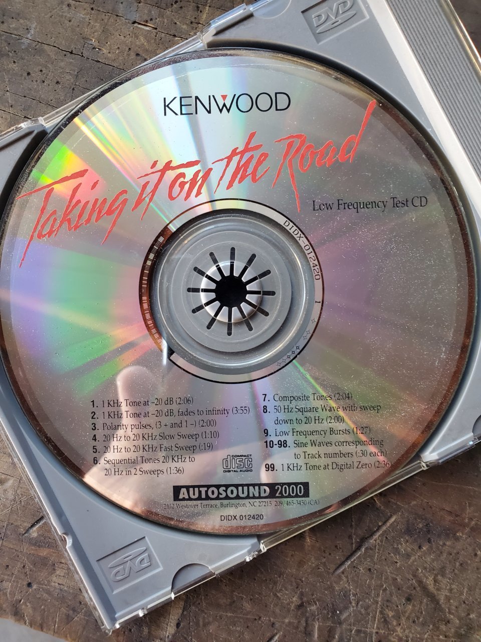

    By the way, if your phone can't run two apps at the same time then try to find this CD (or similar). It has a track ("song") for every needed frequency and a white noise generated sound in it as well.
    It also has several test run type tracks that can be useful as well.

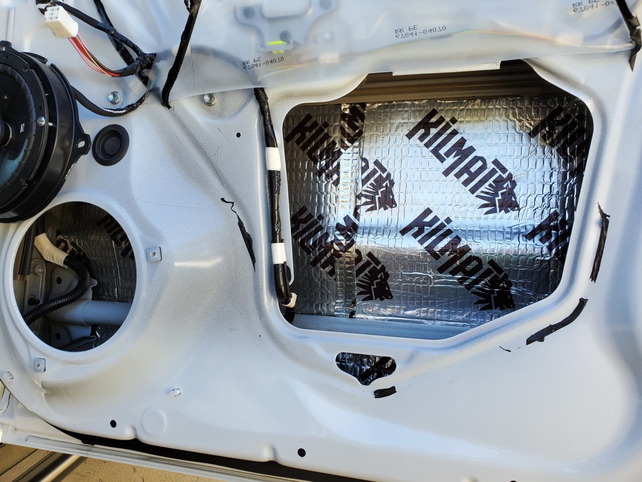

    Thanks guys. Installed all 6 plus the kilamat. Incredible.

    Have now done tweeters and fronts. Didn’t feel like taking the plastic barrier off the inside of the door so just have Noico around the inside of the speaker opening as far as I could reach. Cutting the Noico into smaller pieces enabled me to get a good bit in. Nice improvement in sound, will get around to the rear doors eventually. One tip for those looking to do this, take the whole piece with the green and white door cables out, don’t disconnect the cables as some have done. Follow the Crutchfield instructions on this point, or watch Jesse Rizzos video on this, it walks you through the process perfectly.

    Definitely recommend taking the plastic off and doing the entire door interior, vastly improves the sound and the door even feels more solid when you close it. The adhesive used on the plastic is super tacky, and if you're gentle taking the plastic vapor barrier off, you can just set it to the side and reapply it when you're done. Exactly what I did, easy peasy.
