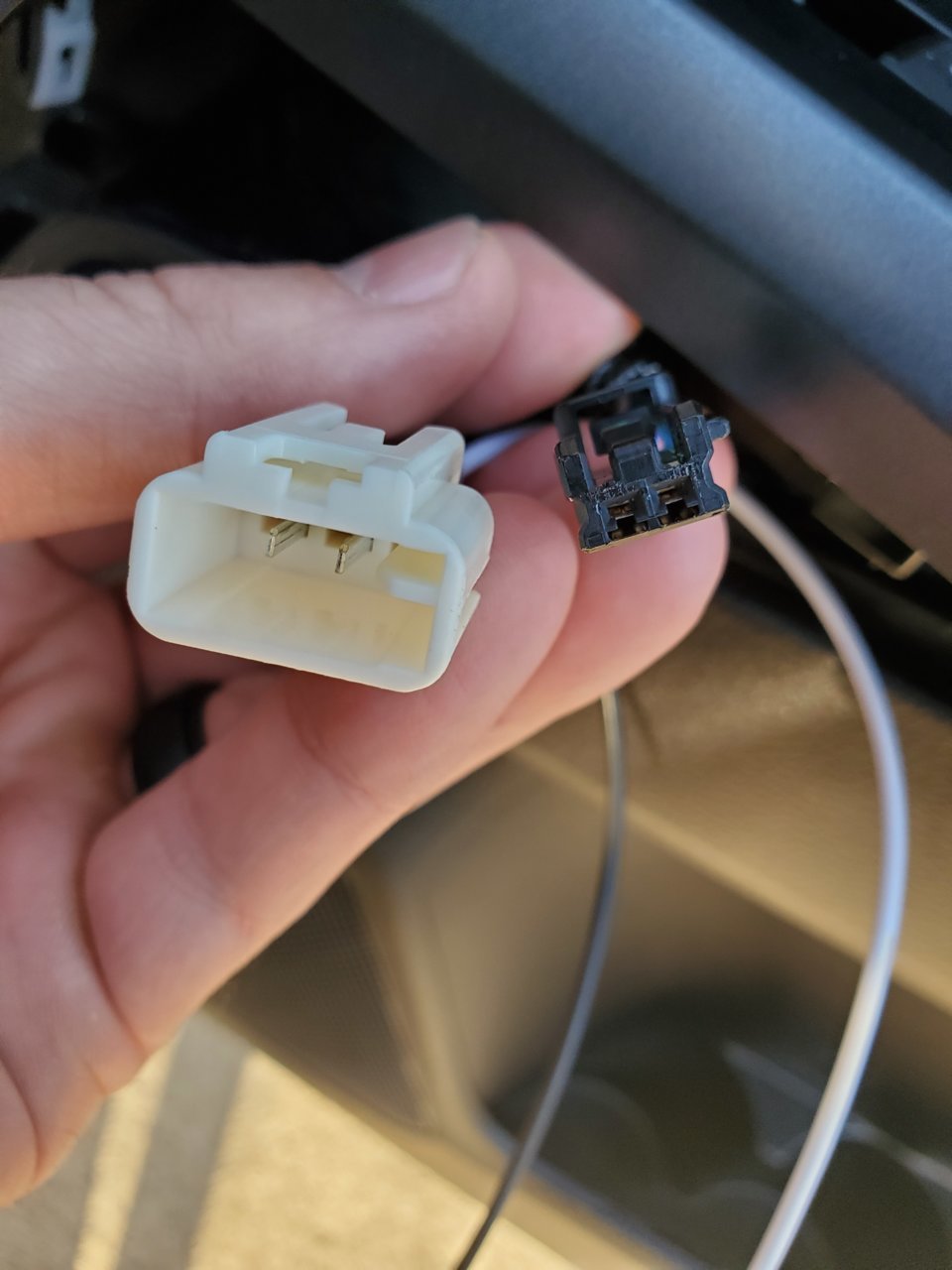

    anyone have any issues with the 2020 rear speaker harness crutchfield sent? the harness coming out of the rear door is very small and black and does not fit the harness they sent. I spoke to technical support and sent them pictures but just waiting to hear back.

    Old Man $538.00 Sound System Upgrade w/Kicker DS in the doors, and a Cerwin Vega VPAS10 powered (10") sub under the drivers seat.
    I have a 2018 and did the fronts on Saturday, was going to jump into the rears today but did my grill surround first. I have not pulled the rear door panels yet, so I can't confirm that the harnesses Crutchfield sent are right or not, but the part # of the harness they sent me is "72-8104" if that helps.
    I am heading out there to pull a door panel right now and check because I don't want to end up in the same boat.
    The front speaker spacers they sent are a total joke.

    i watched Jesse Rizo install video and his tacoma rear door has a white harness coming out of the truck that looks to fit....i'm guessing they updated it this year for some reason. I'm just trying to figure out if there is an adapter out there that fits!
    So yeah, sorry for the delay, but while doing my rear speakers, I cut the shit out of myself on the door panel sheet metal and had to superglue myself back together...literally. It was a deep enough cut that it wouldn't stop bleeding, but not bad enough to go get stitches.....So I got the bleeding to stop just enough to squirt some super glue into the cut and got myself glued shut...ugh..
    Anyway, the plug/harness that I listed in my last post, is the correct one for my 2018 rear doors, so yeah, they may have changed something in the 2020 that makes that harness no good for you. Sorry..no pics, but bleeding like a stuck pig sort of put an end to my process for the day... Got one rear door sound deadened and the speaker installed, but had to stop there. Pics tomorrow if you need them.
