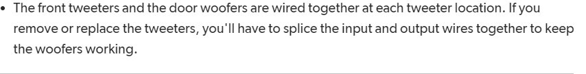

    Hey ya'll. Just upgraded my tweeters with the subaru swap. Was planning on upgrading the door speakers but on Crutchfield it mentions this: upload_2019-12-3_10-9-53.jpg
    Do I need to do anything or should everything work if I just plug in the adapters?

    I just installed the focal isc 165 fronts and infinity reference 9632ex rears and nothing needed beside connectors that Crutchfield sent with speakers I bought. I’ve also done the Subaru tweeter kicker ks upgrade... HUGE improvement over stock. I’m now on the fence about getting an amp bc the speakers themselves have made such a big improvement

    You’re welcome I literally just installed my rears and was about to let everybody know the big difference it made. Crutchfield sends what’s needed. I do think this is for coaxial speakers only though and some extra harness may be needed for component upgrade to clarify. That’s why I ultimately went with coaxial 2 ways. I’m at $240 right now with my 6 speaker replacement upgrade and install which was extremely easy coming from somebody who’s never changed speakers until now
