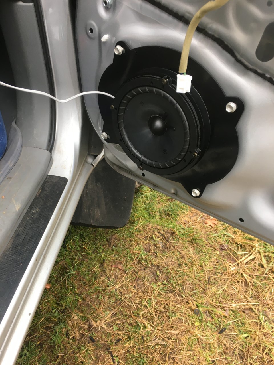

    Just completed today. Due to number of positive comments I made a leap of faith. WOW!! Amazing results for under 200...I have had several whole system makeovers in previous vehicles and was very skeptical on simply doing the speakers. Did the tweeters a week before the doors and had a huge improvement, but the doors really set it off, lots of bass with no amp. Don't question it, just do it... Love Crutchfield. Living in Cville made it super simple and fast.

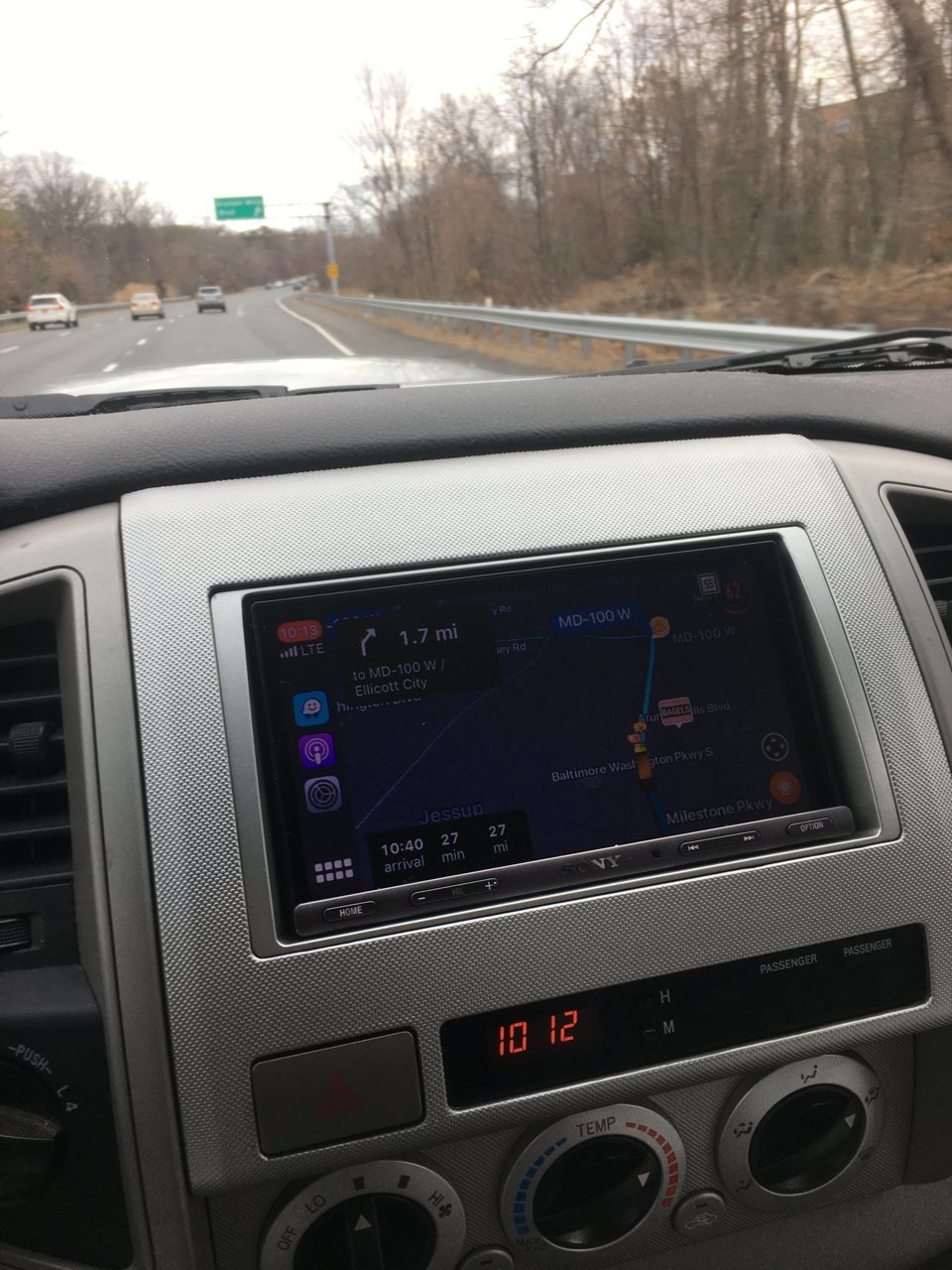

    Just added a new Sony head unit and new kicker speakers. Got everything from Crutchfield. I kept the steering wheel controls. About $575 all in. More than I wanted to pay but very happy with the results.

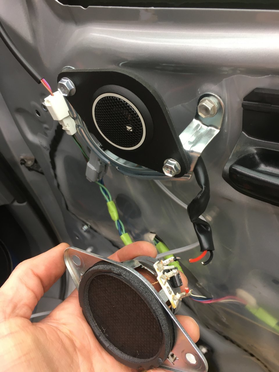

    I have installed the tweeters and the front door speakers. Great improvement over stock. Front door speakers really cleared up the bass.
