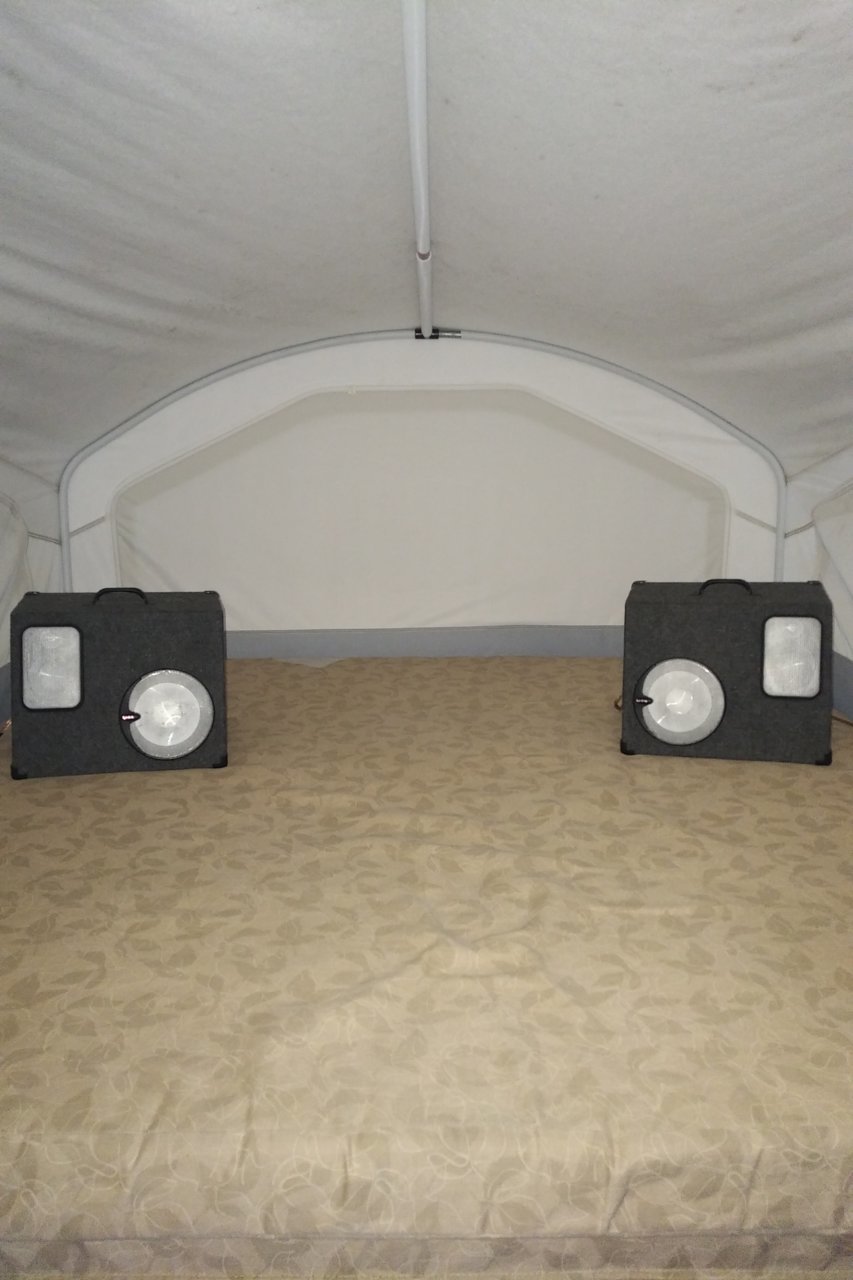

    I even added Infinitys to my pop-up camper powered with a nice Pioneer DVD receiver.
