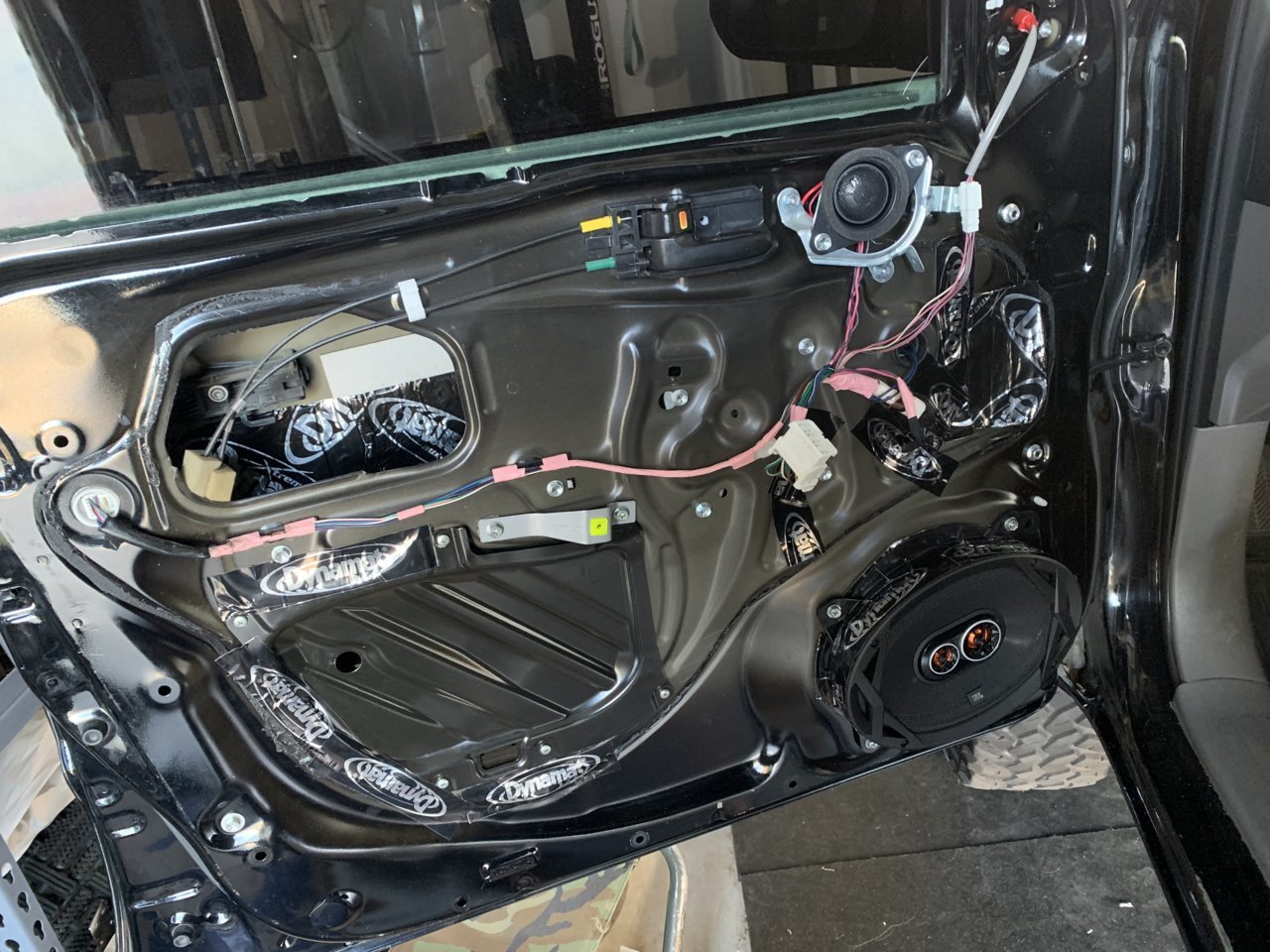

    Finalized my version of this upgrade. Did the audio upgrade using the Key Amp and wiring harness to keep my factory Headunit but improve my sound significantly. I’m extremely pleased with the result and couldn’t have gotten through it without this thread. Wasn’t looking for bass which is why I selected what I did. Parts listed below. I wired the amp into my center console for easy gains and loss adjustment while driving and altered my center console organizer to make it fit with a crisp look. Super happy with how it turned out.
    JBL Club 9630 6x9 3-Way Coaxial Speakers
    Focal ISS165 6-1/2" 2-Way Component Speakers
    Genuine Subaru H631SFJ101 Kicker Tweeter Kit
    Kicker 45KEY1804 4-channel 45 x 4 Key Smart Amp
    Dynamat Extreme on all four doors.
    All and all I’m pretty happy with the upgrade and it was nice to retain my factory look.
