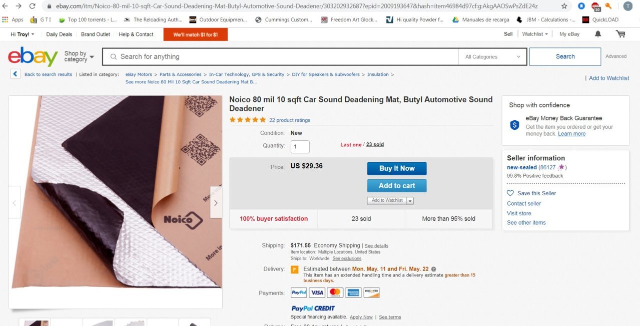

    Received my Kicker speakers today, 4 days from Crutchfield. I have seen it mentioned that some users are using weather stripping to seal the the speaker adapters and the speakers into them. I would like to ask what type would be good for this purpose. I wanted to use Noico deadening material but it may take awhile since Amazon is not shipping non-essential products.

    Get it from eBay. Same price, free shipping.
    These guys shipped out pretty quick and have been reliable for both orders I made.
    https://www.ebay.com/usr/soundcontrolproducts

    Where the hell do you live? AK, HI?
