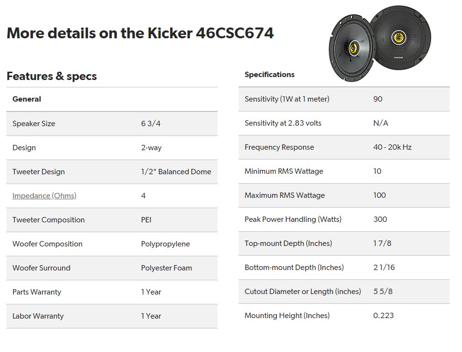

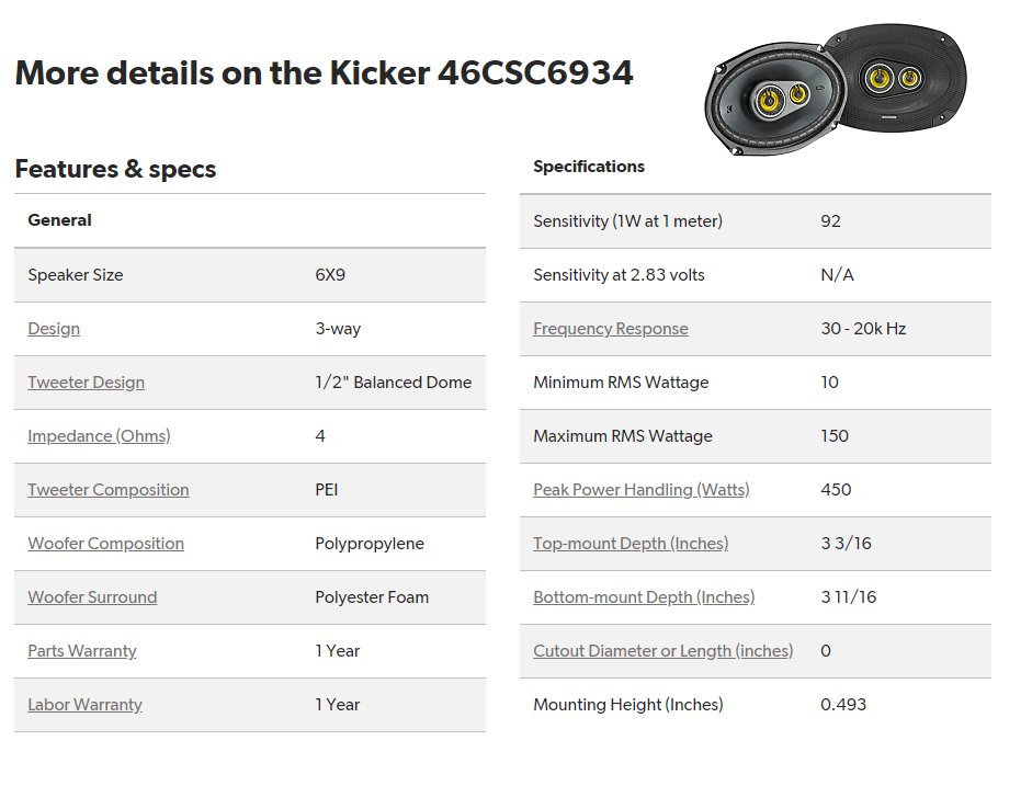

    Crutchfield will only send you the front door wire harness. You will need the 2018+ Camry speaker adapters for the rear doors of your 2020...
    https://www.ebay.com/itm/For-2018-T...2018|Model:Camry|Make:Toyota&epid=15017392234
    Also a lot add the kicker 46CSC674 in the rear doors, they can handle more power and have same frequency response and slightly cheaper today.

    Can't agree sorry...those specs don't compare. Just my opinion no offense.

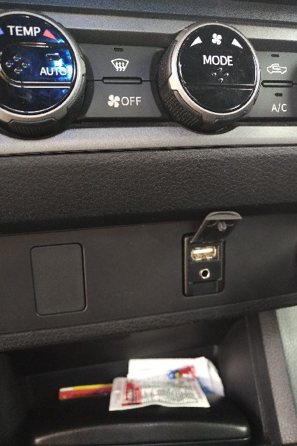

    Is thee a "T" harness for the OEM USB adapter so that another USB jack cold be located in the glove box?

    No. Unfortunately our radios (and most others) won’t read USB’s as a hub. You’re stuck with 1

    Then I think I will just relocate the jack entirely to free up some space. Thx.

    You could add a small hub if you want to keep two functional USB ports, see here:
    What are you using for music storage?
