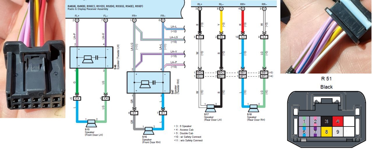

    IIRC the factory wiring routes to the dash tweeters and then run down to the front doors. If you disconnect the dash tweeters you lose the fronts altogether unless you rewire them. Do the door speakers and then let your ears decide if you need the tweeters.

    Below, if the tweeter is removed the front door speaker is disconnected from the head unit. The tweeter has 4 pin connector plug.

    Unless you use the Subaru Kicker tweeters. They leave the factory wiring intact, so the front door speakers work fine afterwards

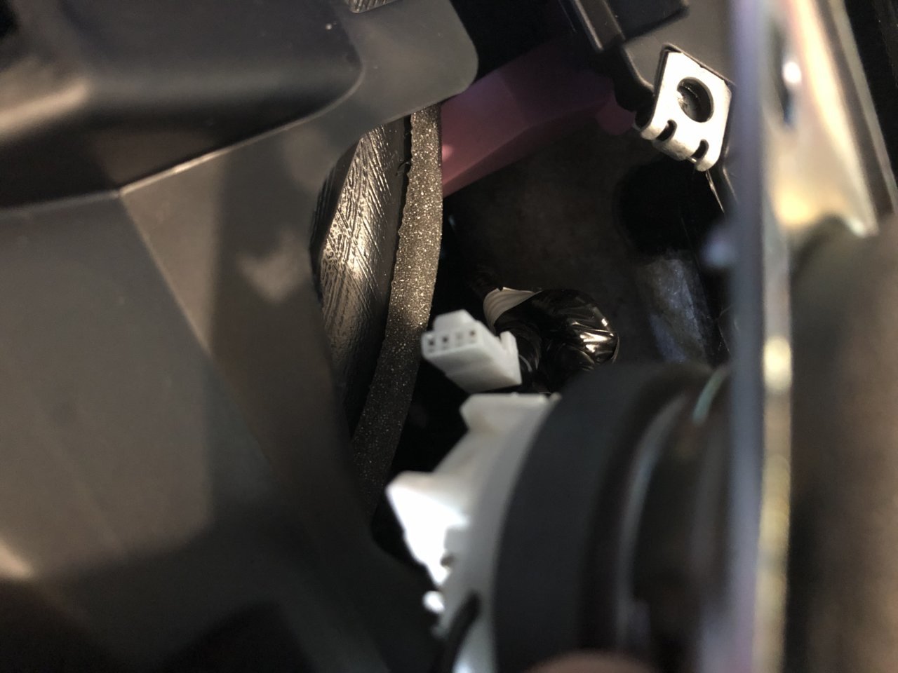

    I have a 2020 SR5, Double Cab with 8" Etune head unit. I just did the Tweeters. Great improvement over stock (non-JBL). I am doing the front and rear speakers next. Cant decide between the Kicker DS or CS series. Anyone know what wattage the stock etune unit puts out?

    DEAB22FD-9A6E-44FB-A351-DC3BE61ED337.jpg When I updgraded the tweeters...I noticed the right one had an "extra plug". It was disconnected. Anyone know what this is used for?

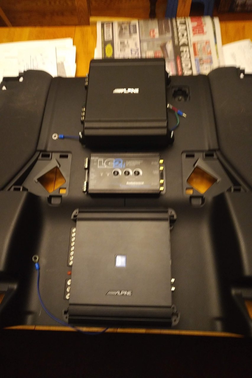

    I bought 3-way Kappas for the front and 2-way in the rear. I have Reference series in my 2017 Forte5 with a 200 watt Alpine amp powering a 10" Infinity sub. Another line of excellent speakers. I too am building an amplified system with a 4 channel Alpine and an Alpine mono amp to power 2x 6.5" subs under the jump seats. Wiring harness is built, just have to pull centre console out to start connecting everything up.

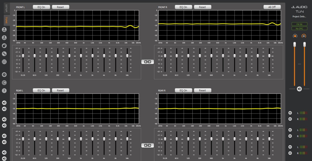

    I need help. I upgraded my 2017 TRD Sport audio and now the right tweeter/speaker are louder then the left. The front signals from the headunit are off based on JL Audio TuN. Do you have the same issue that I’m having and how did you correct it?
    I have OEM head unit + JL Audio FiX 86 Digital Sound Processor + JL Audio RD900/5 amp
