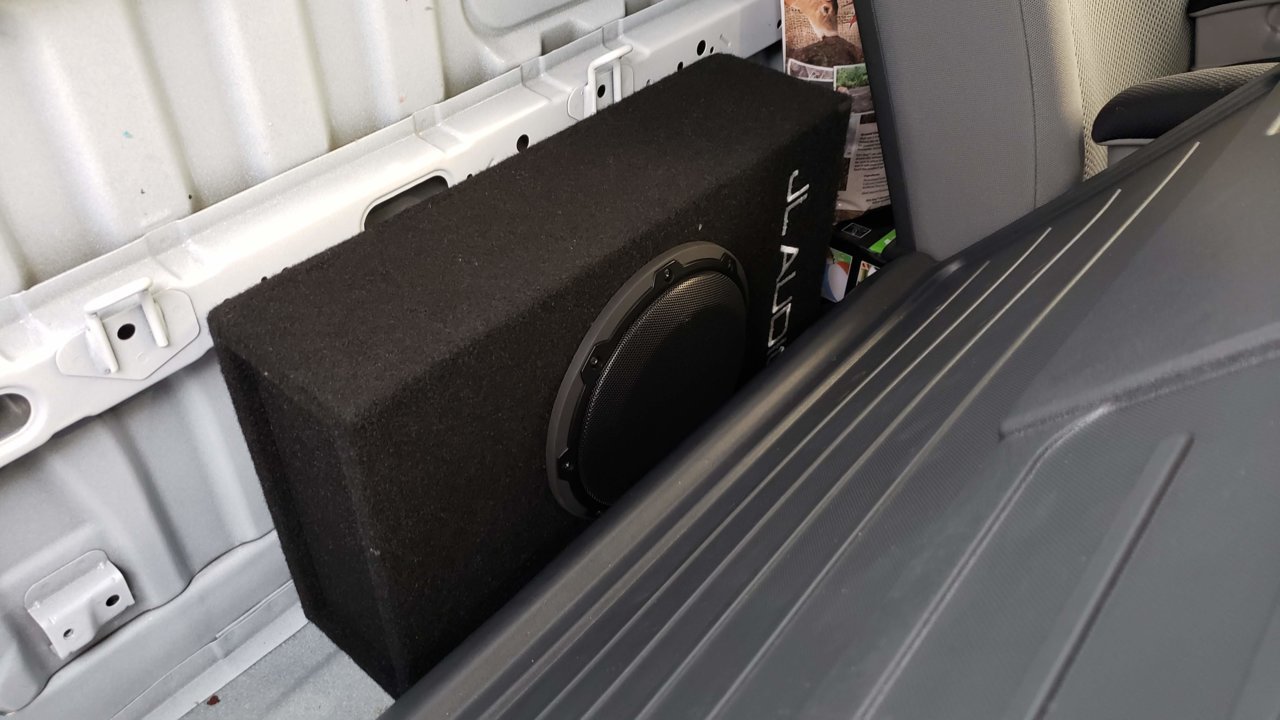

    Not sure how much power you want, but I'm running a 8" JL Audio powered sub that shocks everyone when they see it. It will let you feel and hear the bass running 80 down the road with the windows down!

    There isn’t a list of drop in boxes that fit, there options in a couple of different threads in the audio section.
    Mostly 8” and 10” subs can fit, some required cubby modifications or removal. Depends on what your feelings are about the back plastic wall, space is extremely limited unfortunately

    I was thinking of taking out the bigger passenger side plastic cubby and puting both the amp and speaker in there together. I haven't taken off that plastic piece yet, and I'm not sure how much more room there'll be with it gone

    For a size guide use the Kicker CompRT 10” dimensions.
    https://www.kicker.com/10-comprt-subwoofer-box-2-ohm
    To answer your original question: the comp c box you posted, the top depth of 4” at 15” high it too big.
