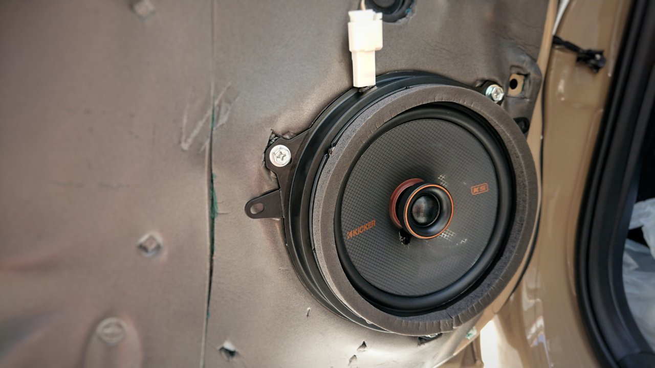

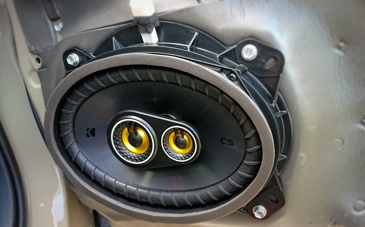

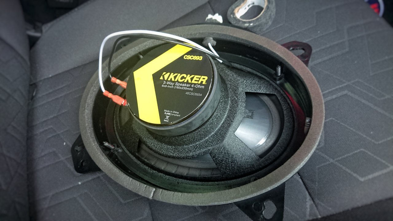

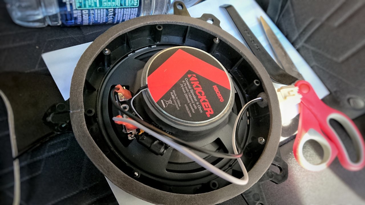

    Just finished my install recently.
    I did the Subaru Tweeters first, but did not notice any difference... Wonder if they are blown...
    Then got Kicker's CS fronts and KS rears.
    Got them both for only $150.
    The fronts have really improved the clarity of my music.
    The rears added little difference though...
    Will maybe add a hideaway then upgrade the HU.
    I do not know if it has been mentioned yet.
    I have noticed if you chose to install 6.75 speakers for the rear and use the provided screws from Kicker, then they would pierce the door's sheet metal.
    Because the stock speakers are 6.5, if you went for a 6.5 speaker it wouldn't be an issue.
    But a 6.75 speaker's mounting holes line up with the outer ring of the door's speaker hole.
    Used a file to shave down the tips of the screws.
