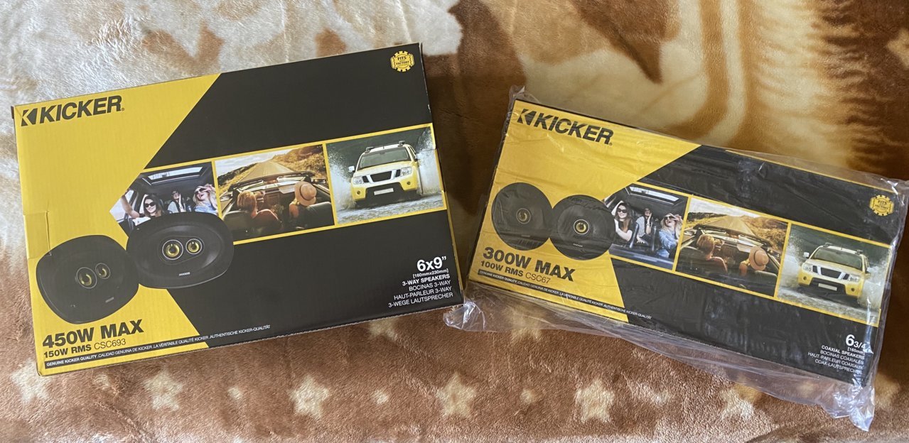

    I just ordered the tweeters, Kicker CS 6x9, and Kicker CS 6.75 but I'm wondering if the Kicker CS 6.5 would be an easier install in the rear door. Do you need to create new holes in the door to mount the 6.75 with the Crutchfield adapter? Would you need to create new holes if I just went with the 6.5? Thanks. Looking forward to getting everything installed!

    no modification require for the 6.75 as long as you use the crutchfield supplied adapters

    Crutchfield isn’t infallible, those will fit also as long as you use the supplied adapter

    Just ordered the front and rear Kicker speakers from Crutchfield. Supposedly some kind of sale ending on Sunday and free shipping with 2 day delivery to my location finally pushed me over the edge. Well, that and this damned forum. Holding off on the Subaru/Kicker tweeters for now until I see how much improvement I get from just upgrading these. Probably get some sound deadening material to do the doors while it's apart. After all I've had the truck for almost 2 weeks now. I might even need to put gas in it soon.

    Crutchfield order arrived Monday and I managed to get them installed last night after work. Incredible how light and cheap the OEM speakers are. I have bigger magnets on my refrigerator than that. I was going to Dynamat the doors while I had the panels off but wanted to get the speakers installed so perhaps that project might happen some other time. Still haven't decided if I want to drop the money for the tweeters but leaning that way. Upgrade of just the door speakers is a nice improvement over stock.
