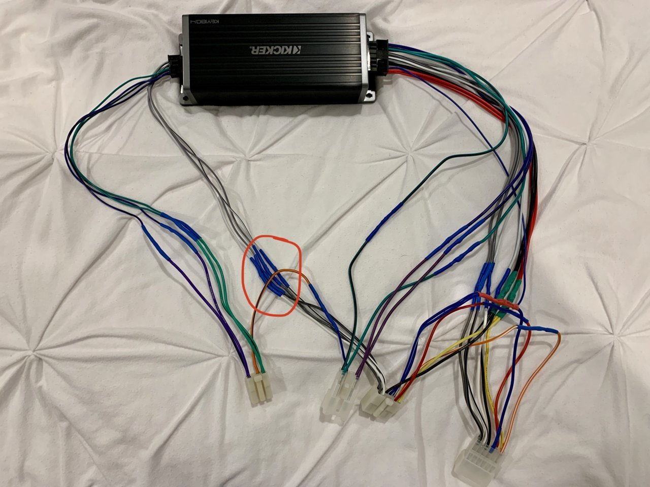

    I also went ahead and upgraded the Tweeters with Front & Read Doors and did the Kicker Key 180.4 as well. Overall, the improvement is phenomenal, thanks to the original poster "bshermann" and to the other Pros and enthusiasts of Toyota Tacomas, which without their postings, sweat and frustrations, I would not be typing here.
    But I have a dilemma at this point and I'm stuck thinking that I might have a bad Rockford Fosgate P300-12 Powered Subwoofer that I paid around $270 plus tax and which I cannot return because of Amazon policies.
    I bought the Rockford Fosgate P300-12 from Amazon because Crutchfield was out of stock and for some reason, I cannot get the Sub to sound like a true Sub, it sounds very weak with hardly any volume, "Destin" (Pro Guy ex Best Buy Installer) Hey Destin... had mentioned a while back and correct me if I'm wrong in this Chat/Thread, to splice into the front speakers because the front speakers and tweeters get more power from the Head Unit.
    So my question is, what is the use of having a Powered Subwoofer then, doesn't the Sub only need the audio signal to take the base frequency and build it up with it's built-in amplifier..?
    Is the reason why my sub is not sounding as strong is because I am tapping into the rear speaker wires, instead of the front, which the rears don't get much power from the head unit and hence the signal is weak going to the Powered Subwoofer..?

    You want to check the install in a few specific areas to ensure everything is set up correctly.
    1) make sure the sub is getting it’s signal from the FRONT speakers, not the rear. The head unit limits the bass signals sent to the rear speakers, and it’s hard to amplify a signal that isn’t there.
    2) make sure you are getting the signal BEFORE the Key. The audio signal goes from the radio into the key, then out of the key back into the vehicle’s wiring. If you built the t-harness, you want to ensure the sub is tapped in on the INPUT side of the harness, not the OUTPUT side. Hopefully that makes sense.
    3) you want to make sure the settings on the sub are correct. If the crossover is set too high or low, it can affect the sound negatively. If the gain is not set correctly it can sound too weak or too distorted. There are only a few settings, but they’re important.

    Thanks for the quick response Destin;
    So let me ask as I put the harness here as a screenshot, can you pin point or circle on the harness, on which set of wires I need to splice into to run the left & right wires that will run back to the Subwoofer Input..?
    Thanks

    right here

    Hey Destin, that's great
    I will go take it out now and start working on it.
    Much Obliged..!
