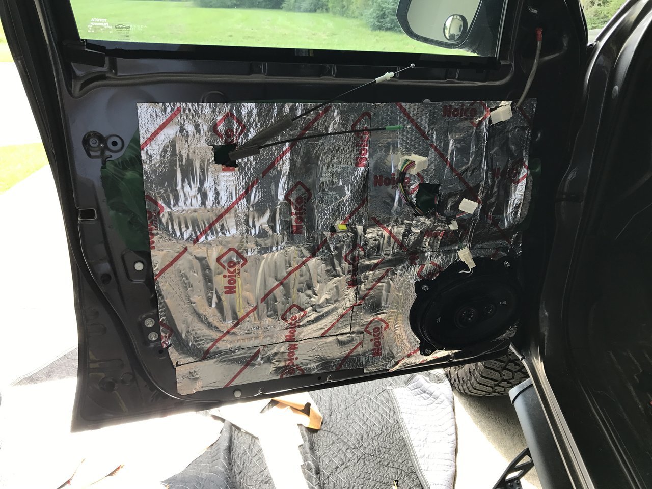

    Just a quick note as I was test fitting the speakers in the mounts, the front don't need to be drilled. The screws go in at a slight angle which is what gives them bite in the plastic and while over torquing will definitely strip them, they have plenty of grip to be secure.
    I started each at the furthest length of the screw and then slowly and evenly tightened each until flush and secure.

    I did the Tweeters a little while back and so far did the Rear Doors with the sound deadener and the Speakers, sound is great but need to do the Front Speakers yet. I had to modify the Rear Speaker Mounts that Crutchfield sent me, had to use my air saw to cut all the inner mount tabs off so that the speaker would fit in it.

    Those little tabs have a groove notched so you just take pliers and snap them off. You don't need to cut.

    Tip, you have to break off the tabs on the rear brackets and called Crutchfield who confirmed. Spent too much time last night on why the speaker wasn't flush. Front brackets have no tabs to break off.

    Do you install the sound deadening on top of the factory sound deadening material (the thick felt like stuff) or do you take that out? I'm assuming you would just cover it for but I'm also wondering how well it would adhere to it...? :confused:

    Actually one door I did and then I realized that it wasn't the best idea cause when you put it on the felt it moves around cause the felt isn't directly on the metal. So pull the felt off then put it on that's my suggestion anyways. I think others would say the same.

    Did you put the sound deadening on top of the white plastic lining on the doors?

    No, they are on the inside. The speaker will not fit flush in the mount unless the are broke off.
