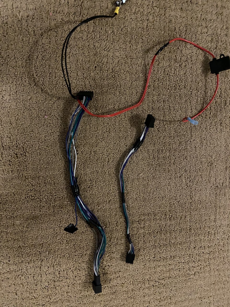

    You have to cut the two terminals apart and wire those onto the harnesses you get with the kicker. I left the cable going into the head unit shorter than the ones going to the speakers so I could get a longer cable to hide the key above the glove box.

    I found an old pic of my harnesses, the ground is much longer now to get a better ground. I got a quick connect, not pictured is the wire going to power.

    No ours is much more straight forward, color wires go to color wires, just need to make sure you get the right end going with the other right end terminal, the inputs and outputs basically correct, so that the head unit gets sent to the right port on the key and is output to the speakers.
    we don’t use the blue wire, at least I don’t know where to tap into to use it.

    Thanks.
    1.The wire going to power... is that going to the battery or HU?
    2.Is the ground needed or is that because you were getting static?
    3. The fused wire is that for your power?
    Thanks again

    I tried power a couple of places, tried the battery, the accessory outlet, and an add a fuse. Configuration in pic is from the battery. Tried different configurations trying to eliminate buzz, none of them made a real difference.
    2. ground is required for power.
    3. Red is the power wire for the amp, it’s part of the two harnesses you get with the kicker. Black is the ground.
