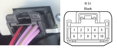

    But where on the 2020 harness does this blue wire get connected? That’s the problem we’re having :anonymous:

    I haven't seen the connectors from the HU for the 2020, but you're looking to connect the trigger wire (blue) to the "dimmer gound." If you could find a schematic, it should be fairly easy to identify. Maybe @caribe makaira can help us find one

    There is no blue remote turn on wire on the 3rd Gen, same for the 2020+.:(

    there is a remote turn on wire for the 3rd gen...it can be referenced in my t-harness writeup for the 16-19 models. I believe it also works for some of gen 2, but I'm not positive. On the 16-19 models it's on the 6-pin 70-1761/71-1761 connectors. I'm not sure what the specific pinouts of the 2020+ radio are. However, TT sells a harness for y'all. It's just that no one has found done a DIY for it yet

    Not the same connector as prior models.

    Those are just the speaker wires.

    They are. Which connector do you think the 2020 uses/has for the remote amp turn on.:popcorn:

    To clear some things up...
    I previously said something along the lines of
    “Of course the 2020 has a remote turn on!! Why wouldn’t it!”
    and then proceeded to look at the actual diagrams and even bought an aftermarket harness to see where the blue wire was pinned... and sure enough, there is NOT a remote wire or power antenna wire in the 2020+. If you are willing to splice into an extremely thin wire, you can grab the ACCY wire over on the radio’s main harness. Or ideally, you’ll grab the cig lighter wire because it is hot with the truck on.
