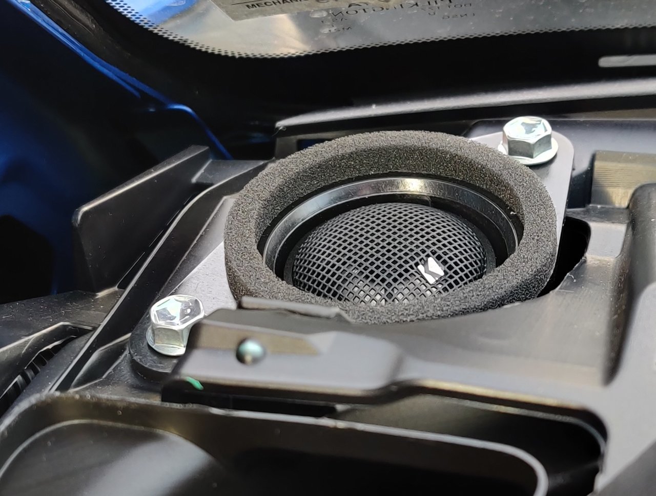

    I put in the Subaru tweeters today replacing 2020 SR5 OEMs... I'm glad it was a $100 dollar upgrade, because it doesn't make as big of a difference as I had hoped - BUT it is an improvement. I installed the driver's side first and faded from left to right using a variety of songs to test them out. I'm not a huge Sublime fan, but turns out Steppin' Razor is the best song ever for testing tweeters.
    https://youtu.be/73ZprL_ZKxI
    Anybody out there who had a similar experience? Did I have unrealistic expectations?

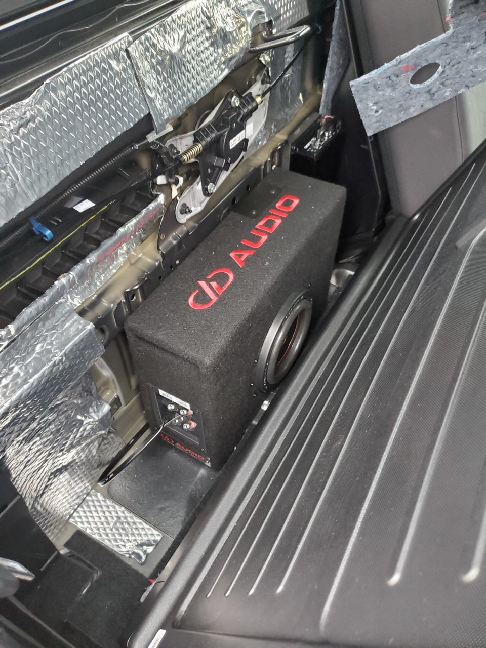

    Put it behind rear bench passanger side...had to remove rear panel on that side...it is a little thumper..but not overly...I think I would be interested in getting a amp for the rest of my speakers now...

    I just installed the Subaru kickers as well. I think the clarity / fidelity of the sound is better than before. But for the sake of plug and play, 20min or so of install time (wish I had some flex head ratchet wrenches) $99 is a simple enough trade.
