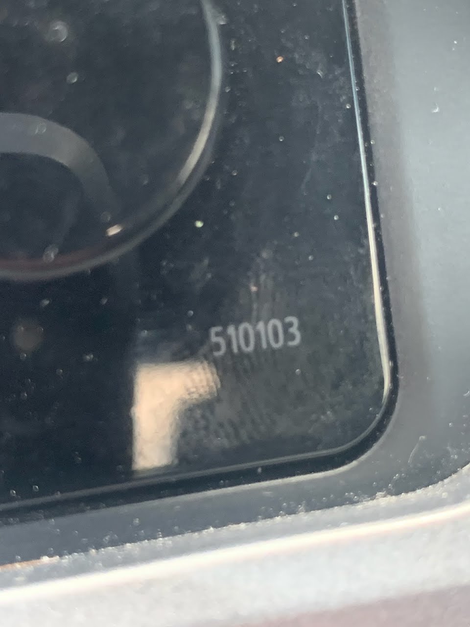

    I appreciate that. So with that being said. And again I have a 14; how does one determine which version they have?

    Not sure about Gen2, but a Gen3 Taco HU will have a faceplate ID number located bottom-right or bottom-center of the faceplate:
    510103 is one of the Tacoma Entune Premium Audio ID numbers. If your HU has a faceplate ID, Google it and see what comes up.
