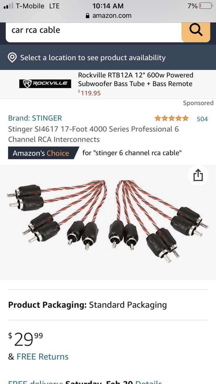

    Anyone know why I have a tiny bit of engine noise? Running my twisted rca cable alongside my power and remote wire maybe this is the cause? Not coming from amp ground because when I disconnect the rca from
    The amp the noise goes away it’s not a serious engine noise barely noticeable nearly non existent with music but it’s there, if anyone amped the factory head unit and experience this lmk how or if you got rid of it, thanks .

    See if you can route the RCA away from the power. To test it, make a 90 degree turn with your rca's at some point before getting to the amp and see if the noise goes away, if it does, it due to being too close or could be a lower quality RCA's. Some of the higher end models these days have enough shielding that being too close isnt as big of an issue.

    I’m using these a friend gave them to me for free but now looking at them they are twisted but not very insulated
