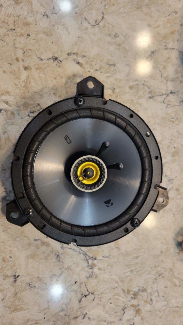

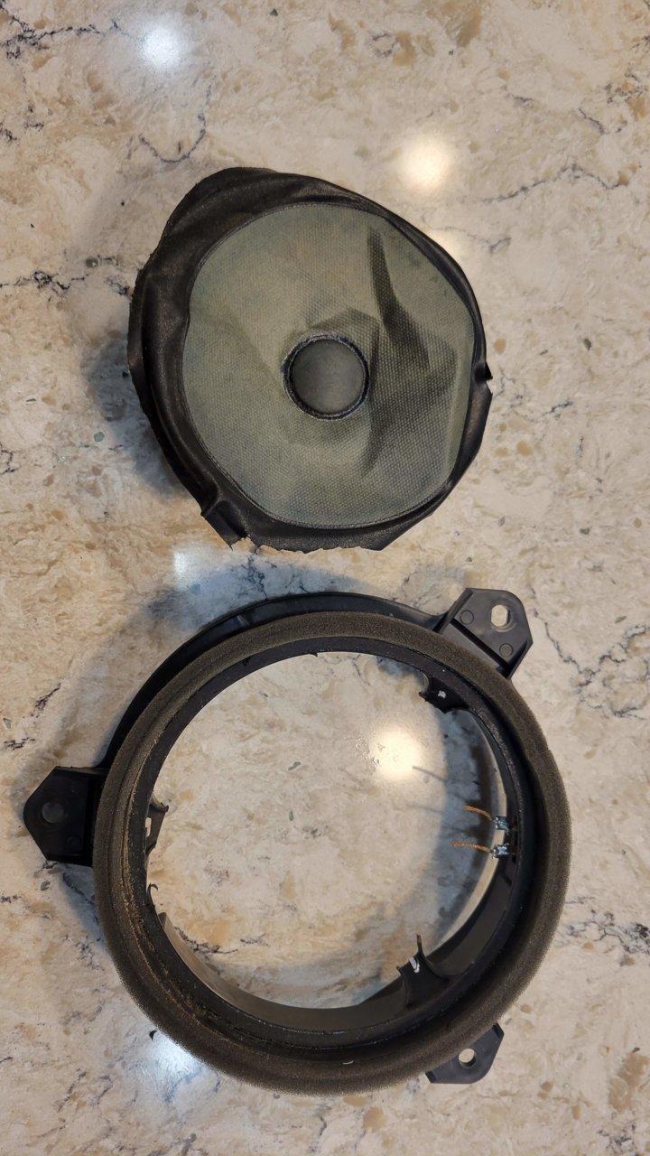

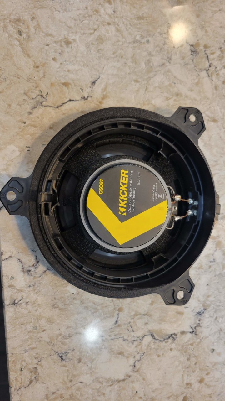

    Installed the tweeters, 6x9 kickers and 6 inch speakers in the back door. The upgrade was pretty easy although I should have ordered through Crutchfield and verified I had everything I needed before I started. For the Kickers I used the pigtails from the original speakers and soldered them to the new speakers. I used the adaptor for the 6x9 but forgot to order them for the 6" speakers in the rear. Comparing the speakers I realized the original speaker could easily be conformed to be the adaptor. It actually worked better than the 6x9 adaptor.
    First, I cut out the speaker with a razor knife leaving as much of the connector wire as I could.20210918_143738.jpg
    Second I screwed the speaker into my new adaptor. Perfect fit.
    Then I soldered the wires to the speaker. This would have been easier with plug n play adaptors but luckily I have a soldering iron.
