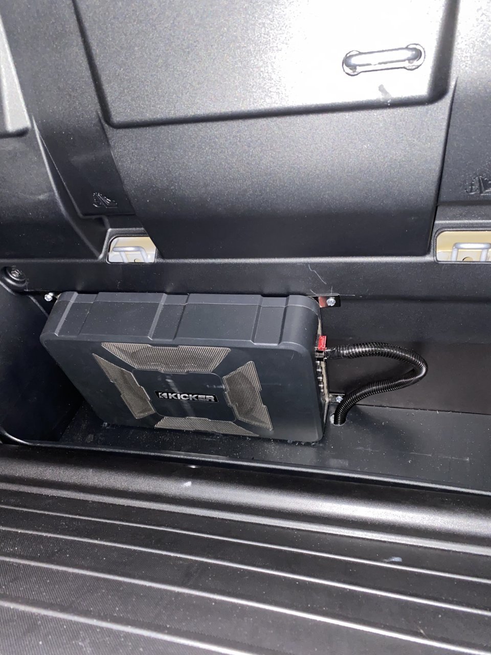

    I put in one 8” hideaway sub in my rear compartment behind rear seat. Kept factory speakers. You need to pull signal off the front speakers, the backs are pretty neutered. Tap into the front right kick panel. My last Tacoma I did the Subaru tweeters with kicker door speakers, then needed to add a kicker key amp to get the volume back up. I would start with the sub, then decide on the door speakers.

    The 200.4 is a 4 channel with signal processor for the door speakers. I had the older 180.4. I don’t have a key in my current Tacoma, completely stock system with the hideaway sub in the picture.

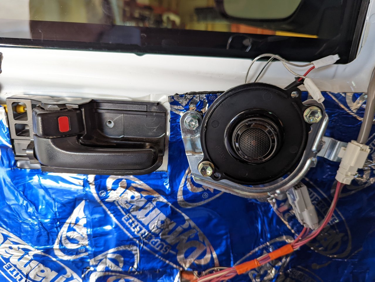

    Loving my infinity Reference 2-way 6x9s and 6.5s. I just added the 2 3/4" Kicker https://www.crutchfield.com/p_20647KSC27/Kicker-47KSC2704.html or https://www.amazon.com/Kicker-47KSC...640052761&sprefix=kicker+2+3/4,aps,237&sr=8-2 They come with brackets for the Tacoma, so it is an easy switch as far as the mounting goes. However.
    There are four wires going to the harness for the tweeters, two of each color (one color is +, the other is -). When you disconnect the tweeters, the sound from the 6x9s stops. You can't wire the tweeters to just one + and -, you have to wire them to both (i.e. on the right side, cut off the harness, strip all the wires, twist the two green wires together and wire them to the speaker +, then twist the two purple wires and wire them to speaker negative). Pretty sure someone has already discovered that and posted it, but thought it would mention it as a refresher.
