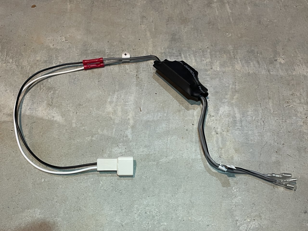

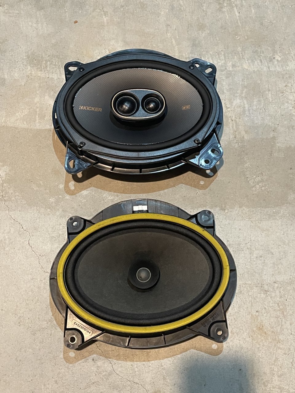

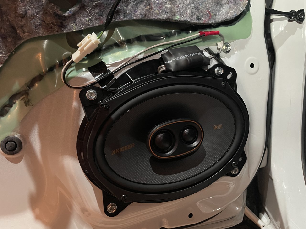

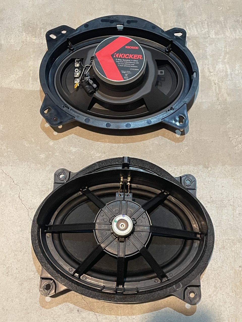

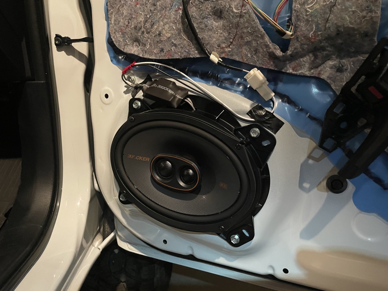

    So I installed the Kicker KS Series 3-Ways in the front doors about a week ago and am really happy with them. It's not 100% plug and play like the CS series...you do have to splice some wires but Crutchfield sends everything you need (minus a wire stripper/crimping tool). The KS series speakers have three terminals and requires you to splice the factory adapter into the supplied in-line crossover. Might do the rears at some point in the future but I'm quite pleased with the sound coming from the dash/front doors!

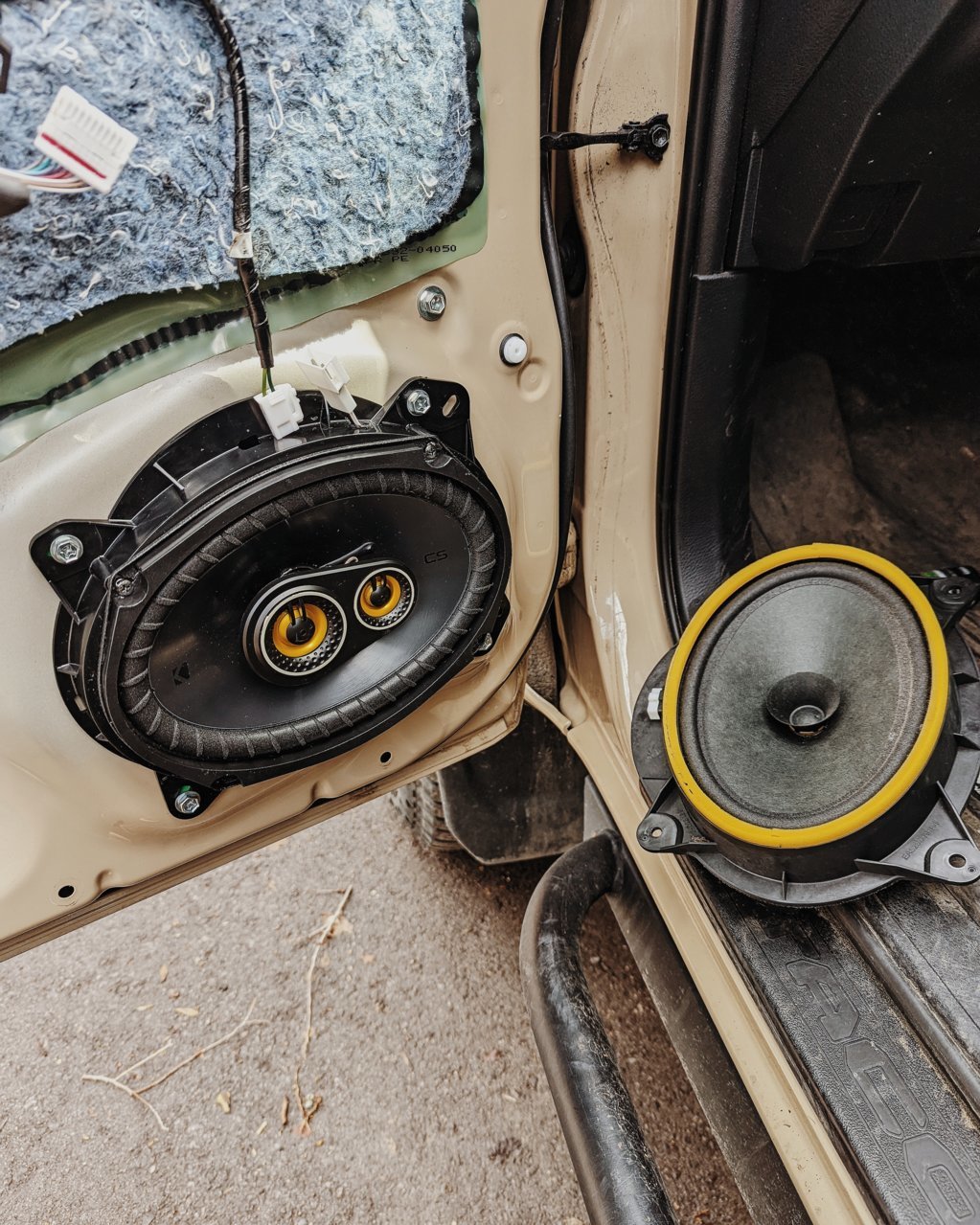

    I just changed my fronts to CS (along with the tweeters), ignored the rears since we barely get any power back there and the new difference was really good. Happy with the change and probably won't change the rears out unless I do more audio stuff.
    I did not add sound deadening mat into the doorwell...I ordered some but opted to not, the doors do rattle a bit more though. Contemplating saving the $50 or adding it if it annoys me too much

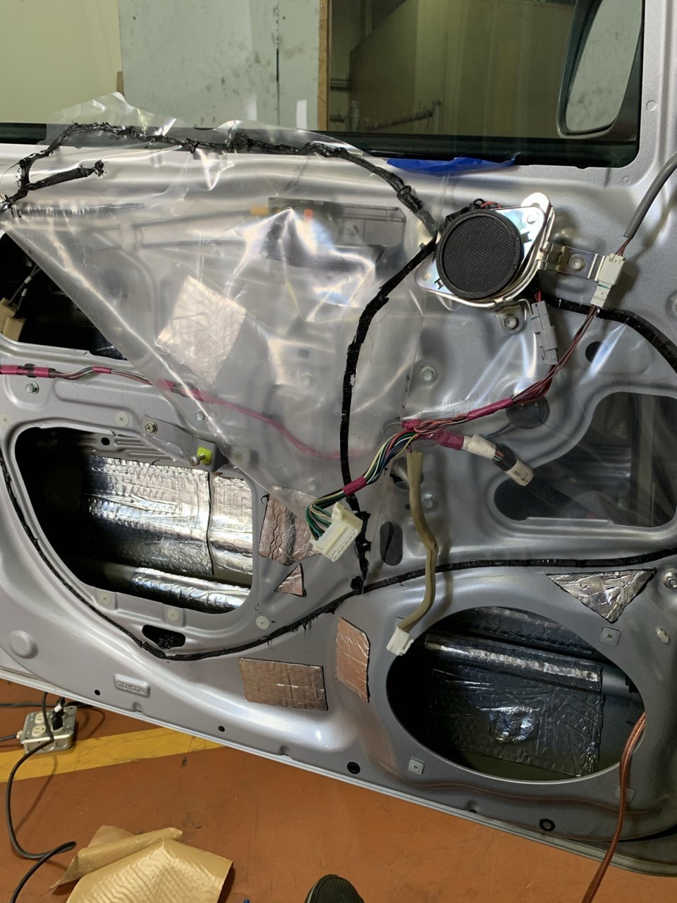

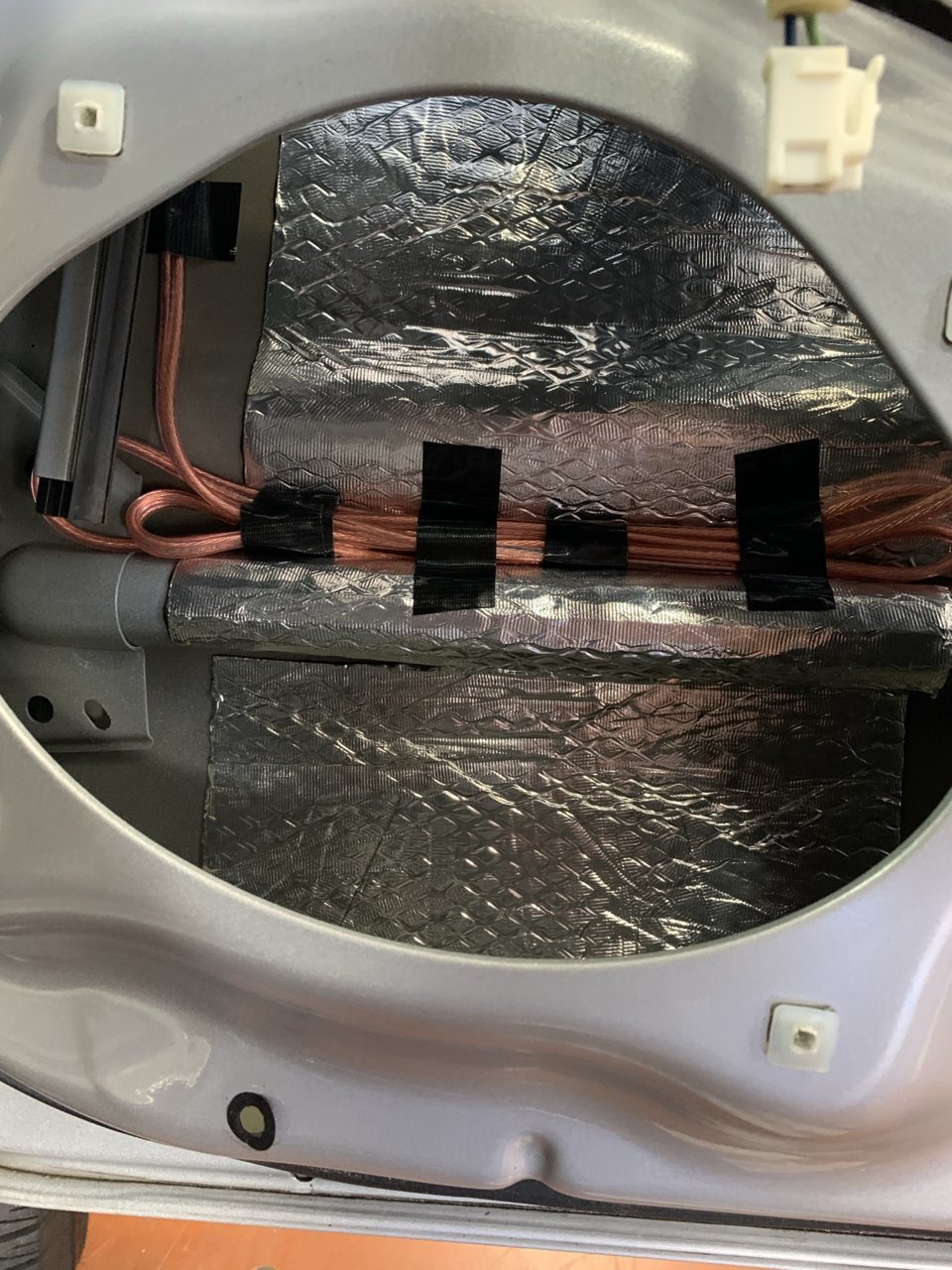

    Best for application on the hollow inside of the doorwell or can it be lined along the outside area where the speaker is? I think everyone I've seen on YouTube does it on the inside where the actual window comes down so probably will go that way unless there's an simpler or better suggestion.
  18. Apr 11, 2022 at 8:30 PM
    #4678
    GRNT4R
    GRNT4R Well-Known Member
    Feb 24, 2020
    #320266
    1,048
    NC - Triad
    2010 TRD Sport DCLB 4WD Silver
    TBD
    Both. Cover the large areas on the hollow part and the area right behind the speaker. And on the inner shell too. Pic of mine
