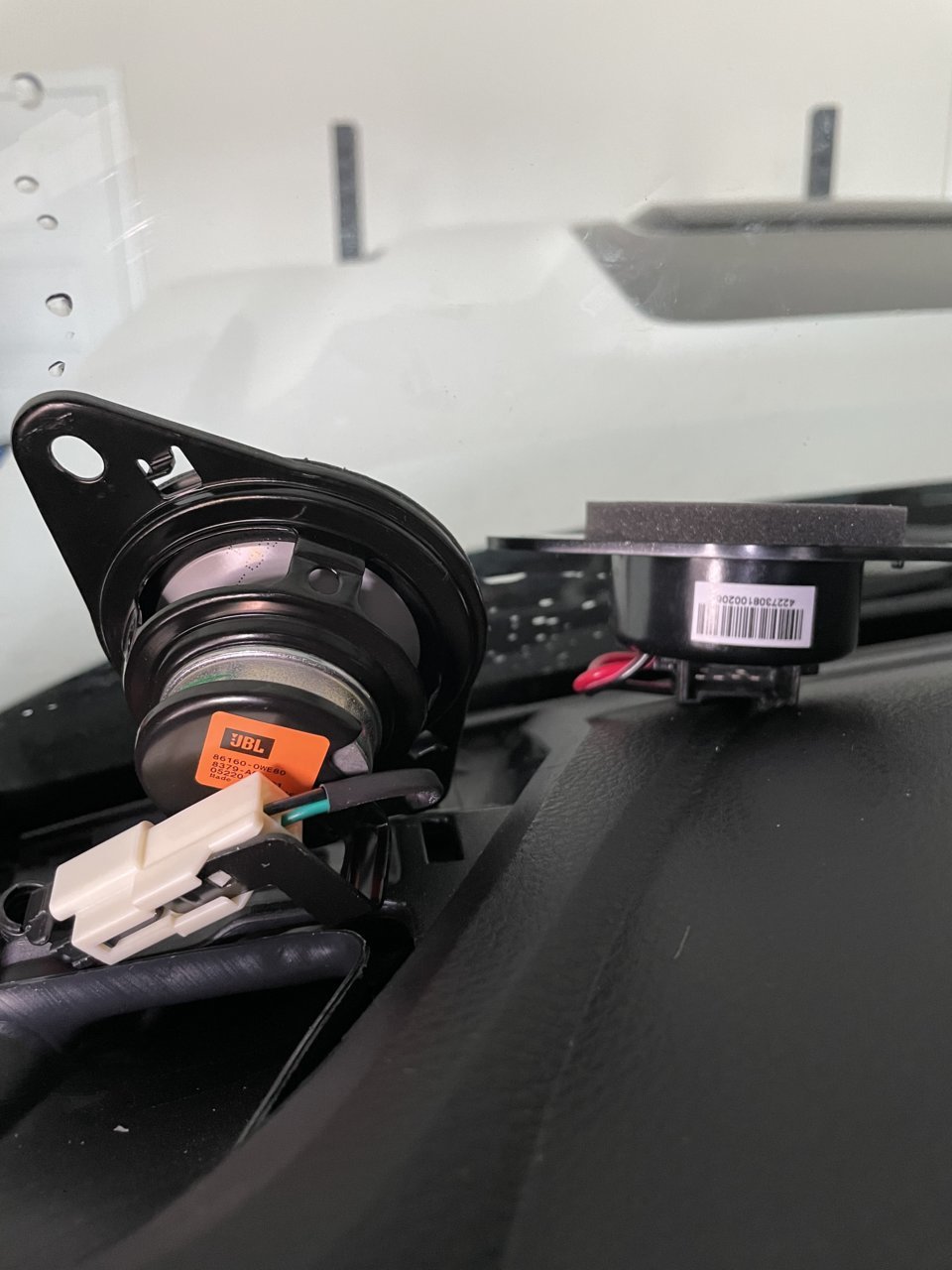

    I have a ‘20 Tacoma TRD Pro. Replaced the kickers and love them.
    just got the suggested Suberu Tweeters to upgrade from factory dash speakers. But when I went to install, the connectors are different sizes?? Any suggestions?
    (In photo, left is stock connected, Suberu on right)
