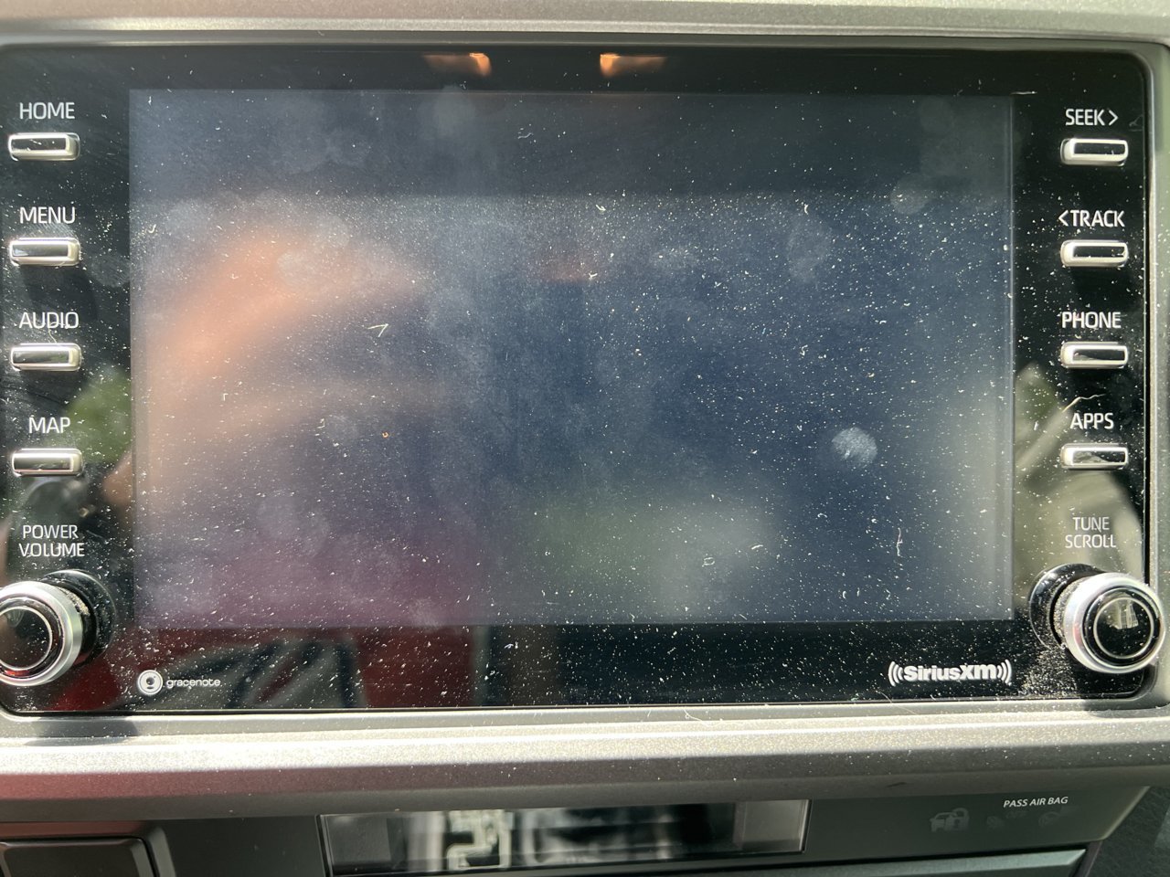

    I don’t see a number. It’s an 8” head unit though not sure if that’s helpful
    edit: 2021 off road, not the premium trim
    please excuse the dust that mid day makes look worse 0B281D9F-185C-4593-96D7-0179FB29BCC4.jpg

    Hmm, maybe they stopped putting that ID on the newer units.
    Try this, and Google the numbers you find.
    https://youtu.be/tEWCEVztvHs
