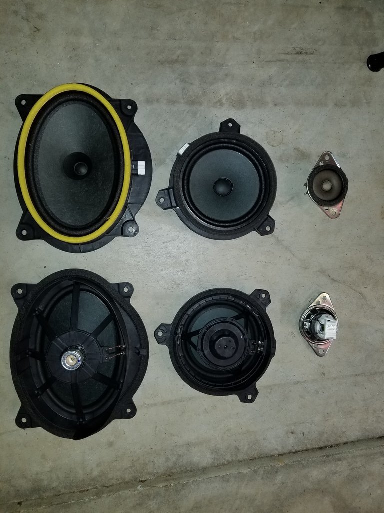

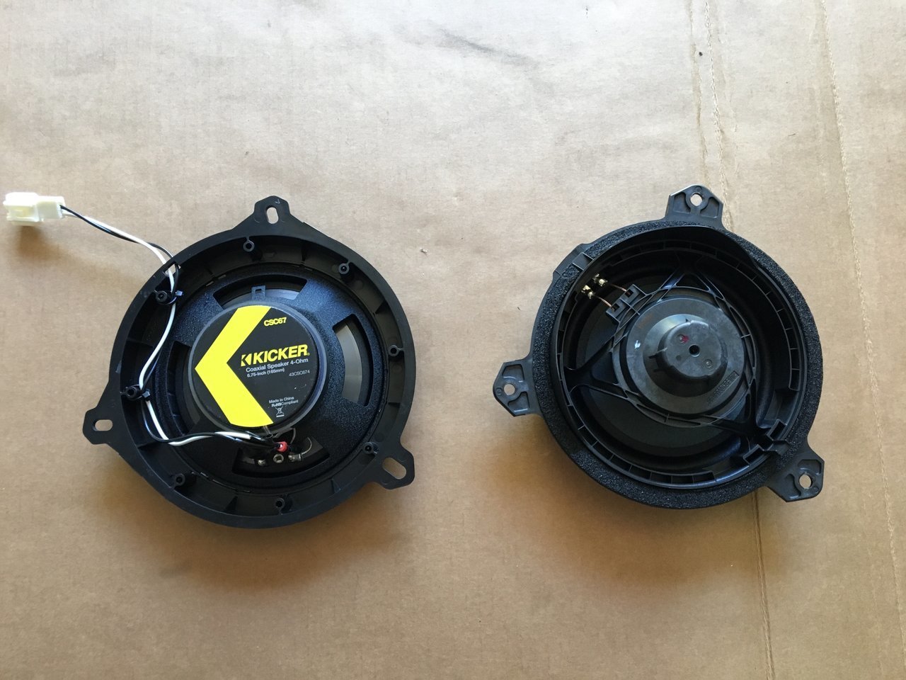

    Did the Kicker CS series speaker upgrade on the doors. Excellent sound along with the previously installed Kicker tweeters. I can crank it up to max with almost no distortion. I do want that extra bass so I'm tackling installing the Kicker Hideaway tomorrow.
    By the way anyone interested in buying a full set of Non-JBL 3rd Gen Tacoma speakers? Only used for 11K miles! :D
    Like others have said, they sure perform good for what they are...which is not much.

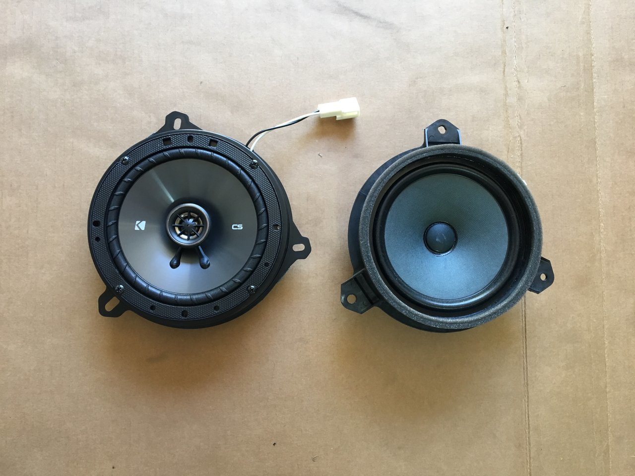

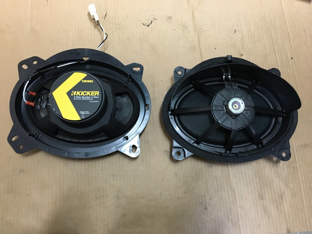

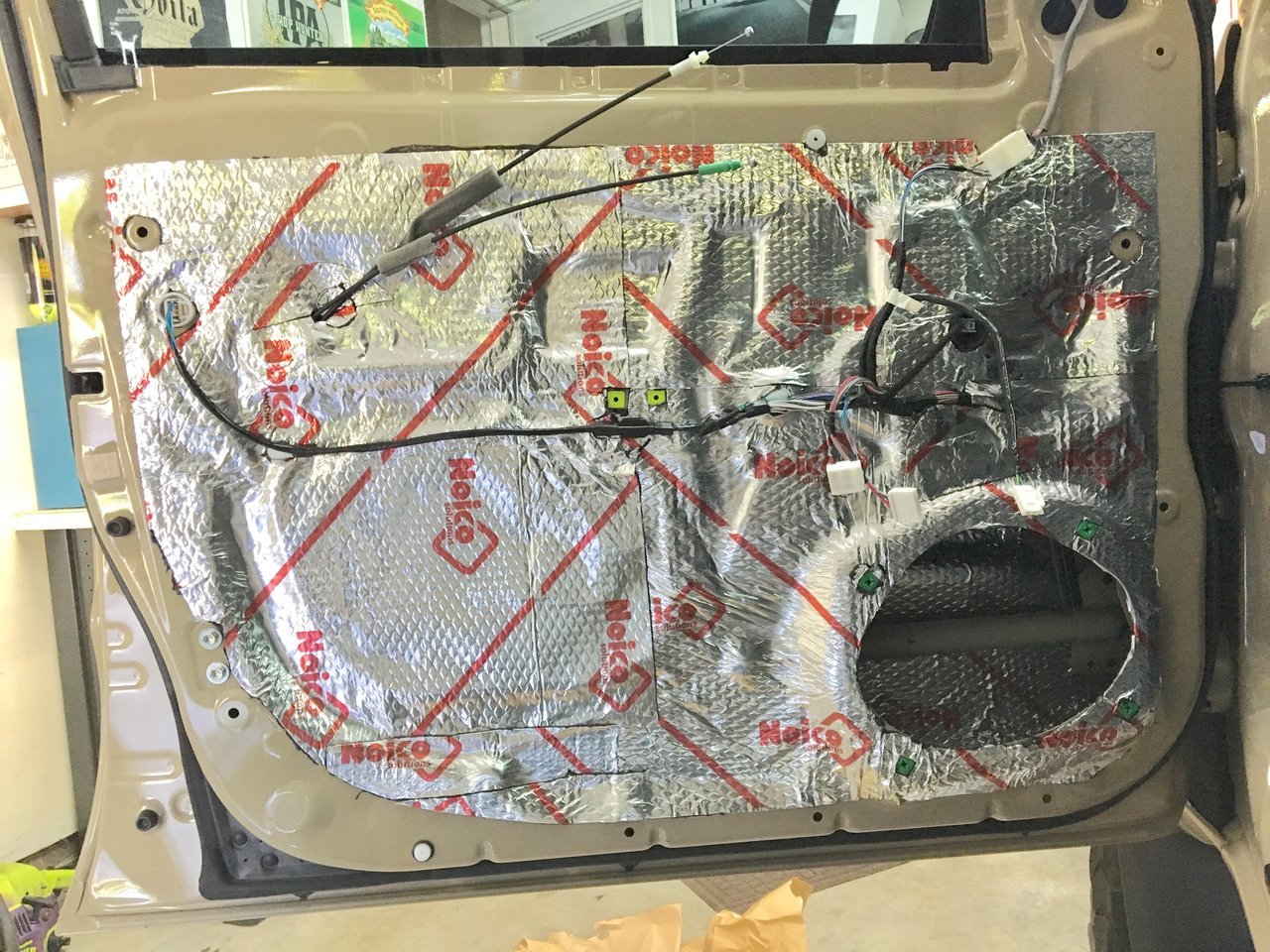

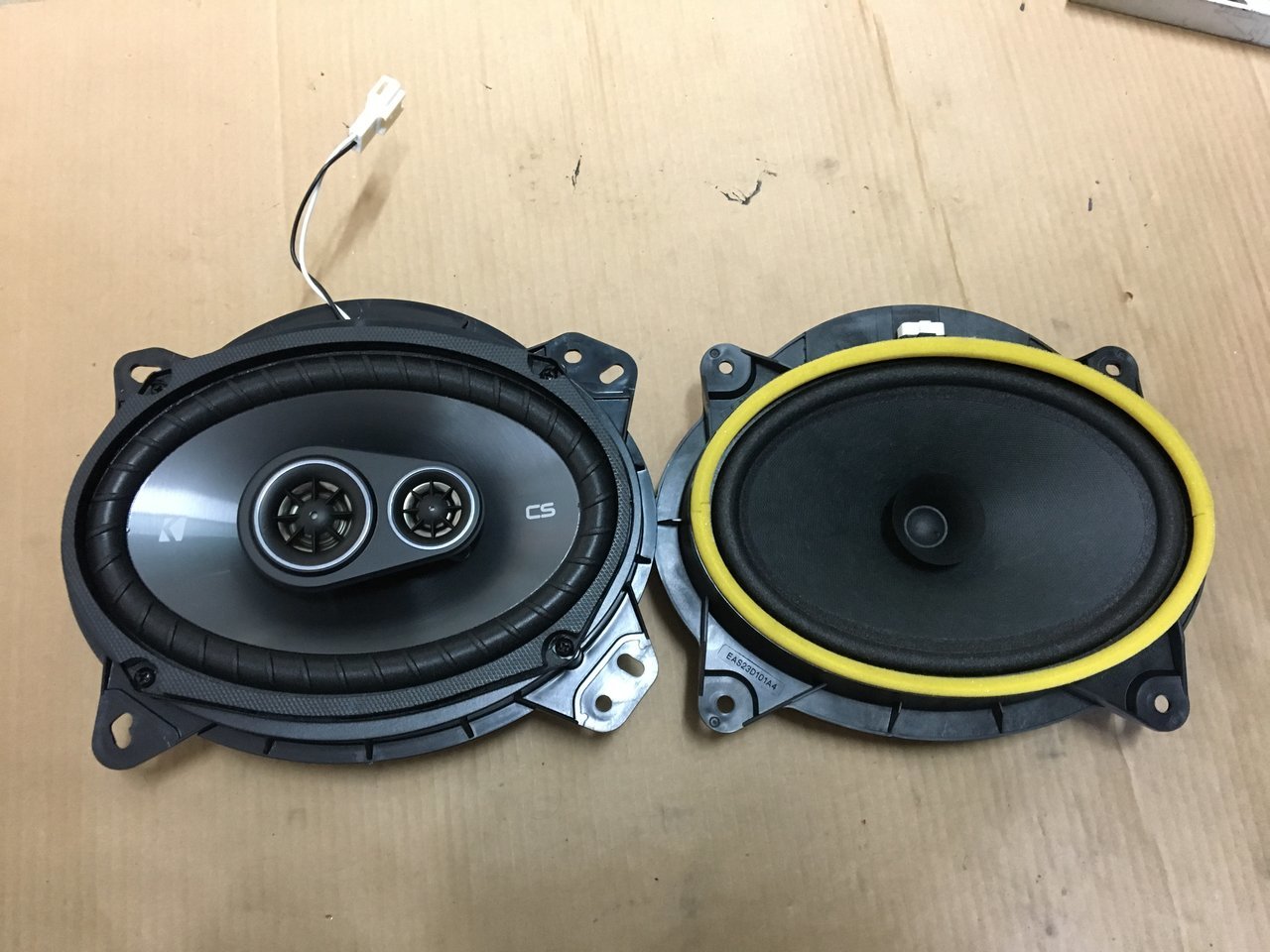

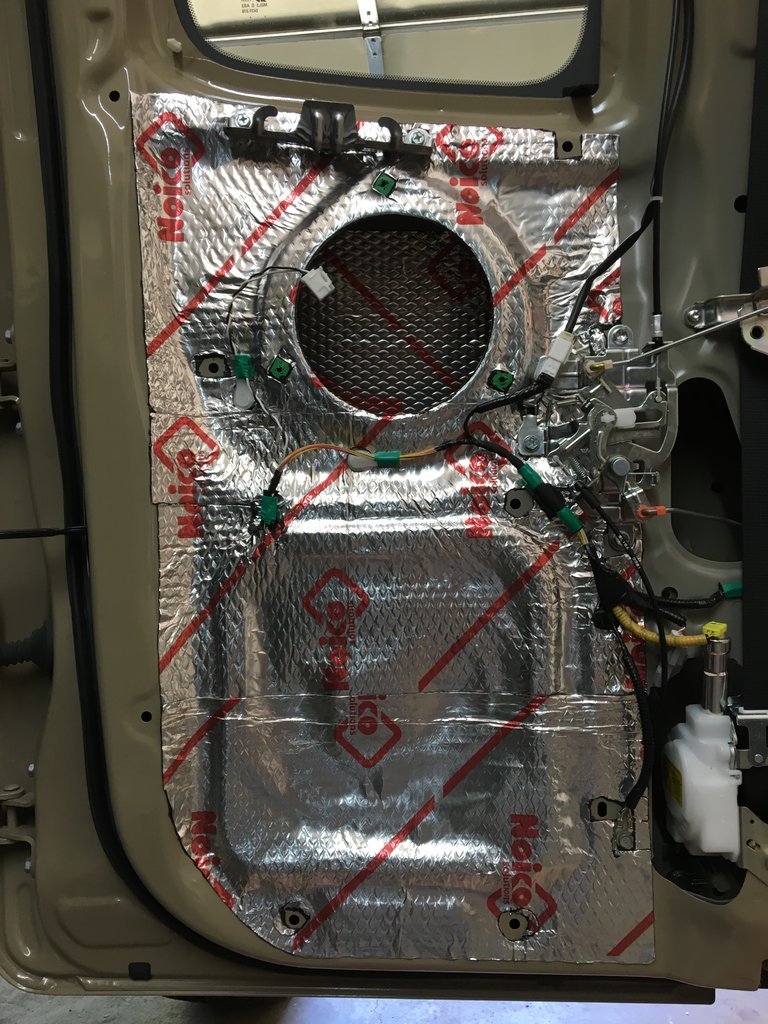

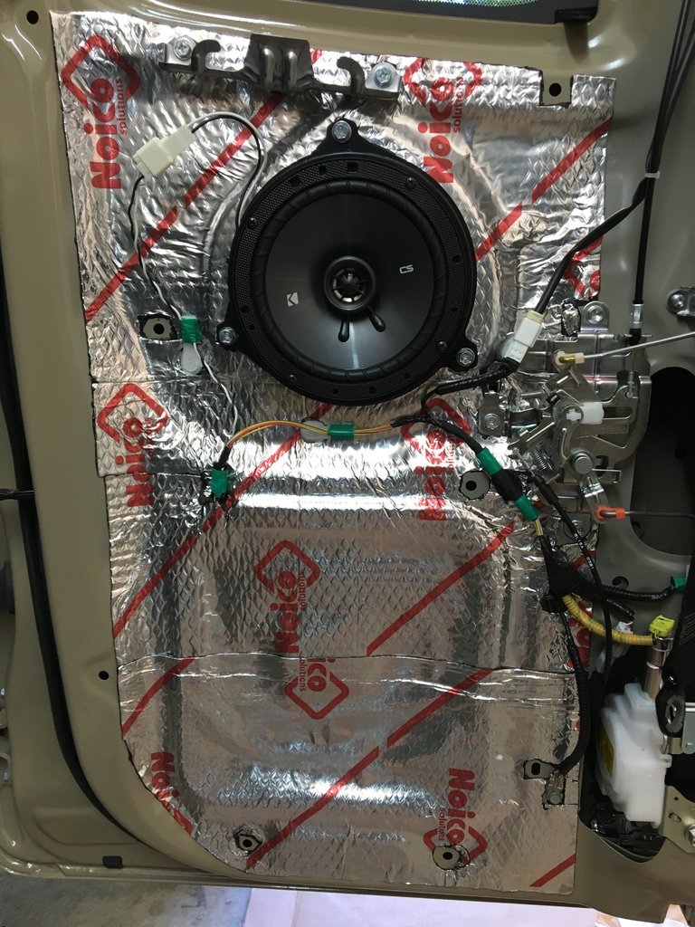

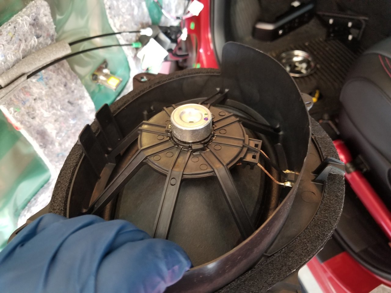

    Got the front door speakers and tweeters installed and WOW! Huge difference! You can really crank it and sound quality is crisp and bass is damn good considering it's amplified by the factory deck. Tomorrow I'll install the speakers in the access cab doors.
    I used the Noico sound deadening material, it worked great! I placed two ~10"x6" pieces behind the speaker cavity (one above the bar, one below). Also put scrap pieces randomly inside the outer door skin panel. No shakes, rattles, nothing!
    I did something that I hadn't seen others do... I put the plastic/felt back on over top the sound deadening material. Certainly can't hurt.
    Wow what a difference!

    Thanks for posting the pics. Very clean install of the matting. Please post pics of the rear doors also. Will be doing my access cab next week and your pics are a good guide.

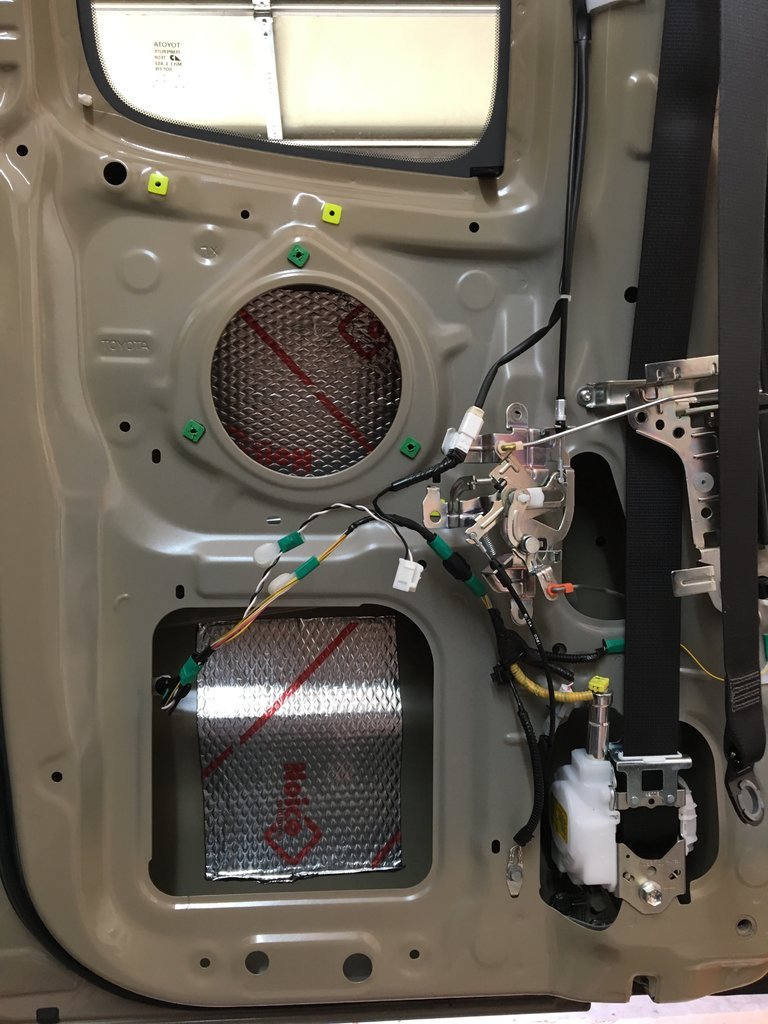

    Got the rears installed on the access cab doors. The final result is spectacular. I take back what I said earlier, my mirrors do vibrate when I have the bass cranked full blast. Sound quality is so much better!
    Placed a 1/4 section of Noico behind the speaker cavity and at the center of the lower cavity:
    Used 1.5 sheets on the face of the door (removed all the clips/brackets/door latch mechanism). The door has a second cavity that in line with the seat belt mechanism - I didn't bother to add any on the face of the door in this area.
    And cheers to the OP and everyone who has contributed to this thread for awesome recommendations!

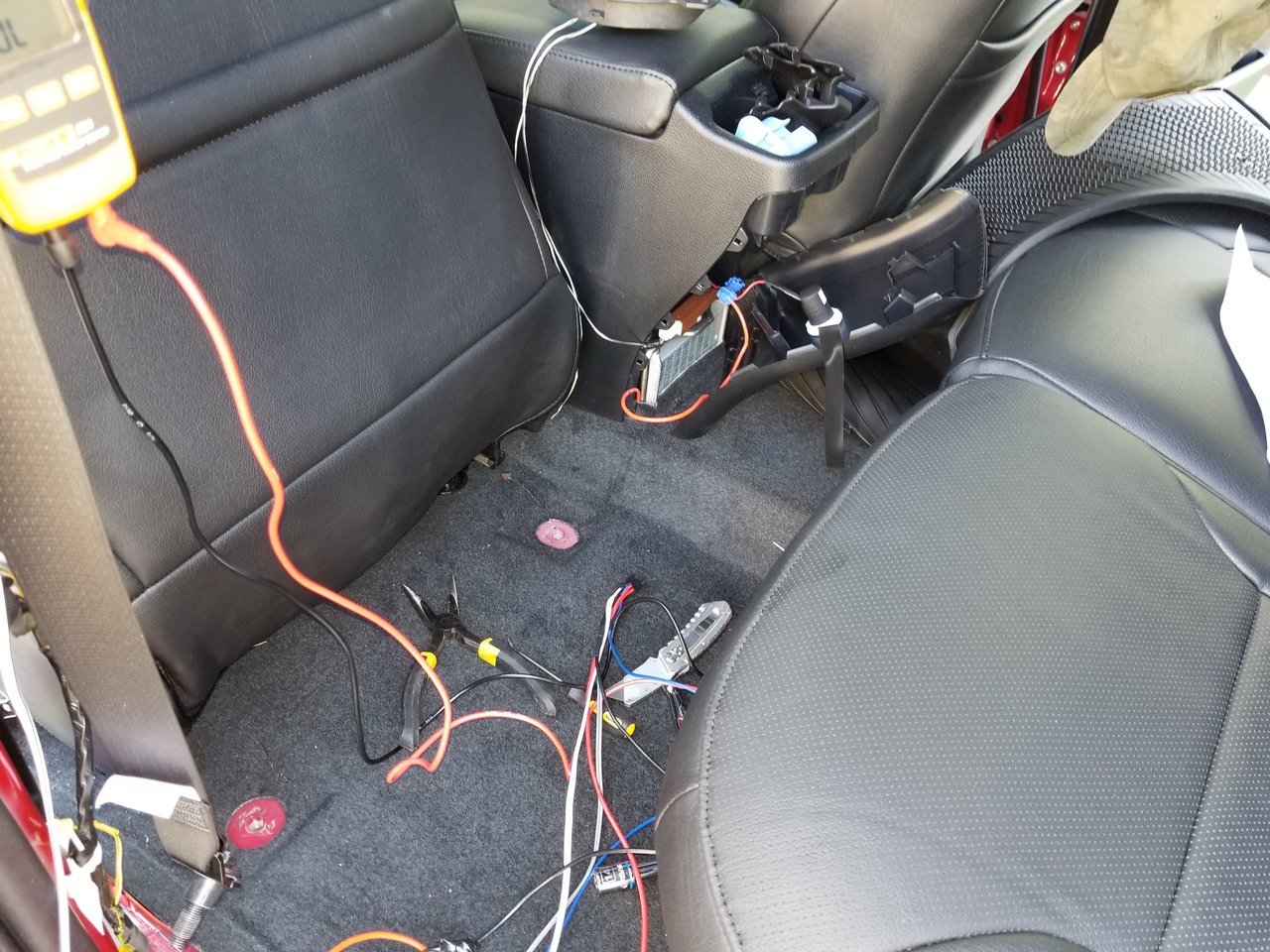

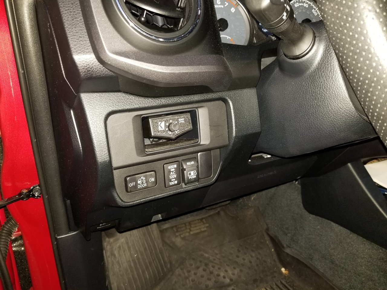

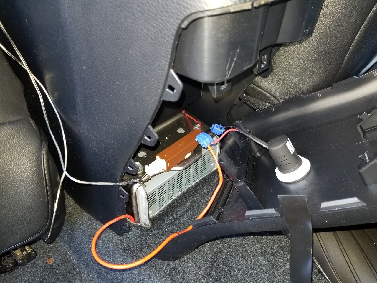

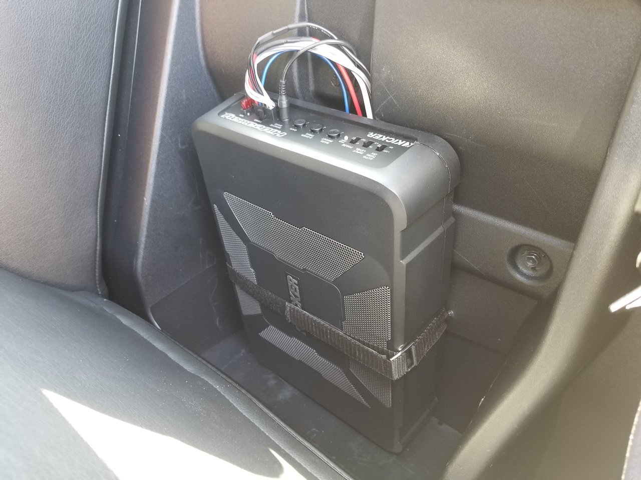

    Ok got the Kicker Hideaway installed today (installed the door speakers yesterday). I was happy with just the speaker and tweeter upgrade but WOW the sub does really make a difference. Went out with the family this evening and cranked it up going down the highway and it sounds great. The Hideaway adds that bass to balance out the whole Kicker upgrade.
    I took off the back seat compartment and lined the back of it with the Noico sound deadening material. No rattles!
    The whole sub install took me 6 hours. I had forgotten how many conections one has to make and how much trim you have to take off when installing a sub. I tapped the white and black (left) and light green and blue (right) speaker wires off the B pillars where they go into the door hinge.
    For the auto-on feature I tapped into the usb port behind the arm rest console. The USB port is obviously just 5v but the power going into is the necessary 12v.
    Any way. Love the sound. Really like the added ooomph the sub gives it. Be ready to need about 8' of extra speaker wire and about 8' of power wire to extend the right speaker connection, ground, and auto turn-on wires.
    Finally found a use for the cubbyhole
