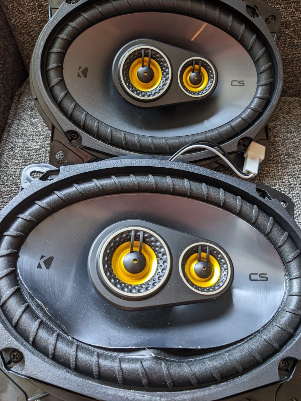

    I did this whole Kicker upgrade 2 years ago. Subaru tweeters, CS 6X9 and the Kicker 6.5" in the rear. Stock head unit. I was pretty happy... But...
    I just pulled my CS 6x9 speakers out of my front doors after just 2 years. As you can see the passenger side speaker failed miserably. I wonder if I can glue it back together...

    That's terrible.
    How are the other speakers holding up?
    If the speaker isn't repairable, you can just put the stock speakers back in the front doors.
