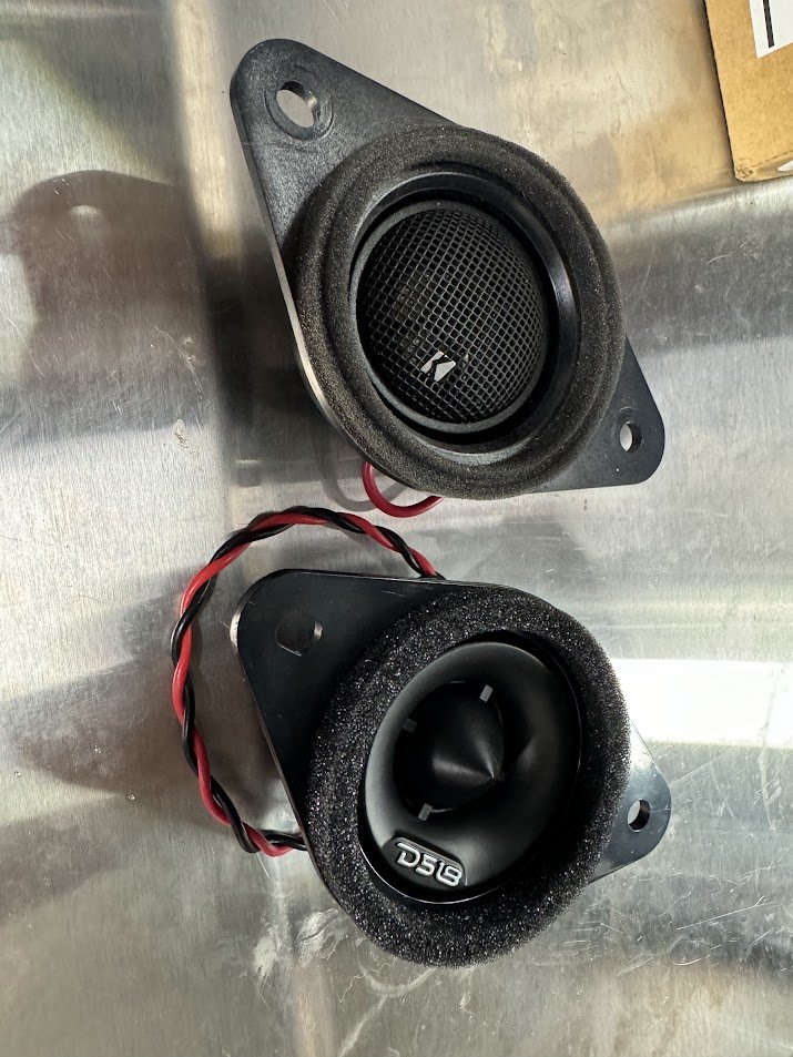

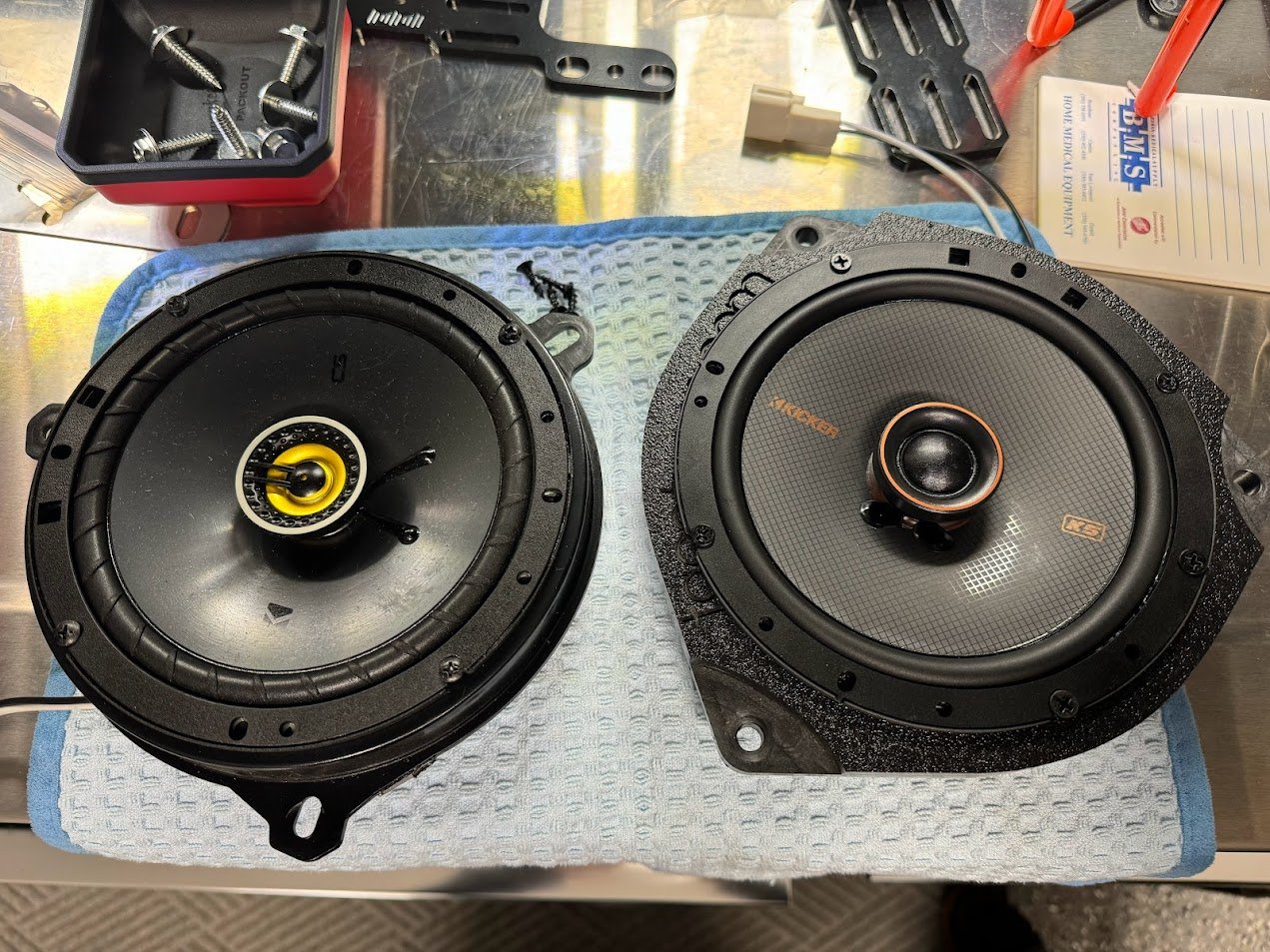

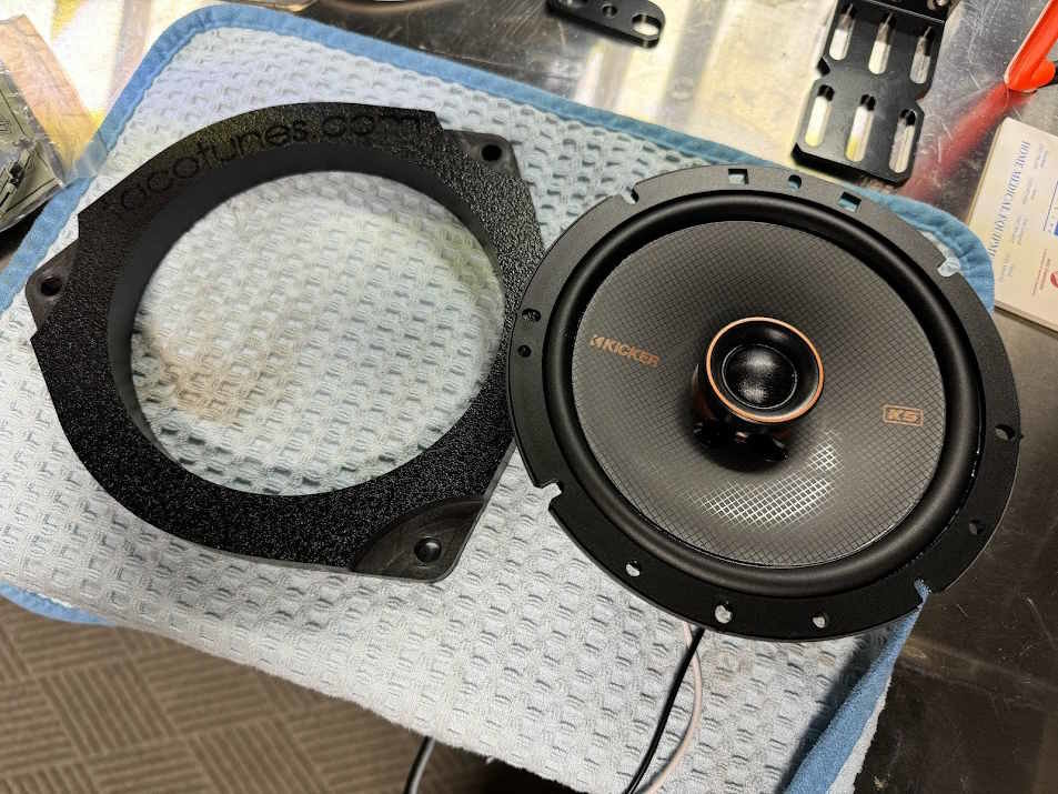

    My audio upgrade path went like this:
    Kicker/Subaru tweeters and Kicker CS speakers (front and rear doors) paired with factory headunit.
    Same speakers but paired with the Kicker Key 200w amp behind the radio.
    In the summer, I decided to upgrade to Kicker KS speakers, but only had time to do the front doors before my trip to Colorado and Moab, but the KS's were definitely an improvement (probably because I was driving them with an amp). Unfortunately I've never really liked the speaker brackets Crutchfield sends, they are cheap and the speaker screws strip with anything more than .2ft/lbs LOL.
    Last week I finally pulled the trigger, bought the Kicker KS 6.75" rear door speakers, and DS18 tweeters. I also looked around for better speaker mounting brackets but was coming up empty except for Taco Tunes. They have a great option, but pretty pricey for what they are. Unfortunately I didn't want to wait and keep searching so I paid for the Taco Tunes brackets and installed them over the weekend. These things are super stout. And the speaker screws don't strip.
    DS18's were a definite improvement, and the rear door speakers sound slightly better as well. Overall, it's a marked improvement over the CS speakers and "Subaru" tweeters. Not sure if the brackets gained me anything except peace of mind and knowing it's done right.
    Cliff notes: If you're going to run an amp, get something at least a little better than the Kicker CS, your ears will thank you.
