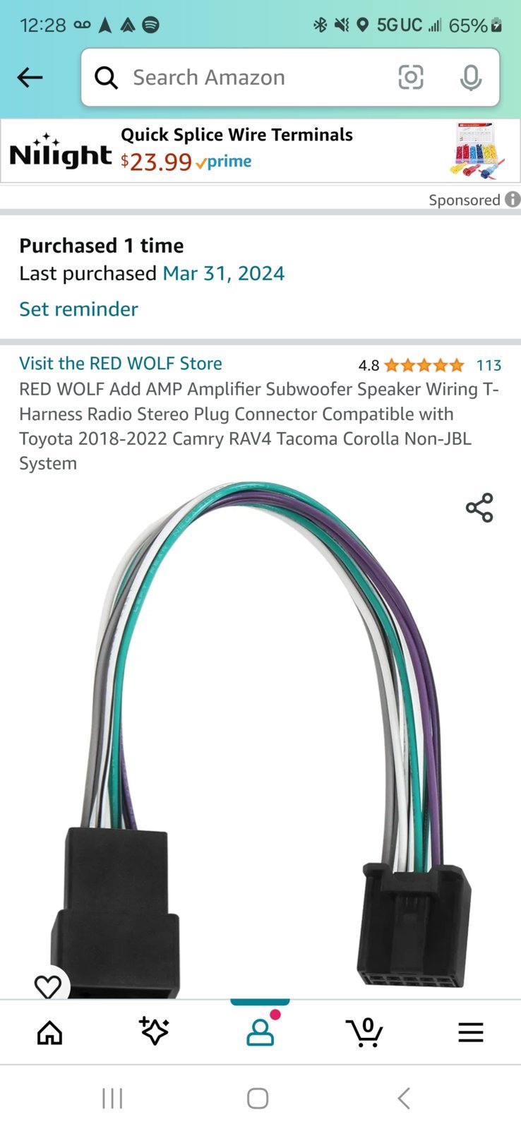

    Just installed the kicker key.. I thought successfully. No sound coming out of my car. 2021 non jbl. Red wolf harness
    Which side of the amp is supposed to plug Into the headunit? Side with dip switches or the side with smaller harness.
    Also I may have forgotten to press that little button don't remember what it's called. Is that an issue?

    Amazon. Same price as crutchfield. I think the issue is I didn't color match wires, I matched them sequentially so my grays and whites were flipped. I am getting power to the amp but I'm getting a red error code which could mean alot of things. I flipped the wires on male to male end, but not the side with power cables yet. I am scavenging my garage for 2 more buttconnectors.. lol
    Edit: can't do anything more tonight. All hardware stores are closed and I need two more butt connectors. Pulled the fuse to ensure the power wire isn't live for now. Tucked it all away. If flipping those last 2 wires doesn't fix it, idk what else to do
    Edit 2: oh my goodness. I found a treasure trove of them in an old box. Update soon

    Okay final update for the night. I got a green light! I color matched all the speaker wires, hooked it all up, and started the car. Initially it was red, then sat on green... then quickly flashed red and then no more light. All while still receiving no sound.
    Any other ideas?

    Yea I couldn't use the metra harness. This is what I used. Got everything fixed up today, working fine. Just need some quiet place to do the auto eq tune, apparently everyone is out everywhere today making fucking noise or driving by, and don't have a garage that I can park in lol.
    My issue was I didn't not realize all 4 color wires on harness and kicker key needed to be spliced individually together. That was not obvious to me, so I only connected greens to greens, purples to purples, whites to whites and grays to grays. Had no idea I needed too split the wires further by pulling them apart to separate green w/ black line from green, and then splice those together. And then do same for solid green to solid green, splice those together (seperately)
    All in all i went from 8 butt connectors (4 each side of key) to 16 total

    Mixed? No. When I saw 4 diff color wires on the redwolf harness and 4 more matching colors on kicker key, I just matched em up 1:1 with 4 butt connectors on each side of the key (8 total)
    What i did NOT realize, or did not necessarily read anywhere in explicit detail, is that each color of wire (green purple white gray), both on the kicker key and red wolf harness, there are two wires on the same strand of colors, not just one. One being the solid color, and the other the same color but with a black line down the middle. So, next I disassembled my harness carefully, identified which wires had solid black lines on them between the kicker and red wolf harness, and color matched once again but with that info in hand this time. So 4 butt connectors before (4 each side) turned into 8 (purple x2, green x2, white x2, gray x2) making 16 total.
    I was basically youtubing everything and scouring this forum for explicit details for this install with barely any experience in any of it . I started this project on a whim that "boy this looks super easy ppl are giving super easy install steps" blah blah but I didn't have the basic information or understanding of how this stuff works. Now I have some experience and learned some lessons along the way for my next potential endeavor

    So you combined each + and - into a single butt connector, essentially shorting out each speaker input and output... That would do it.
