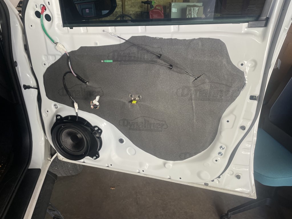

    6.5s work!

    maybe they've changed it, but my old 2001 mitsubishi eclipse came with 6.5" door speakers. crutchfield would only ever tell me 5.25" door speakers were all that fit.
    i bolted 7" speakers in it without issue.
    my current working theory is that they look at the largest/deepest of each speaker and verify fit off that. and not all vehicles are capable of having the largest/deepest of the oem size installed, and there's also plenty of leeway for them to deny 'guaranteed fit' off that.
    i'm currently running 7" dayton esoteric's in my other vehicle, which are only about 1/4" larger cutout than the 6.5" peerless hds nomex i'm running in the truck currently. if dayton still sold the esoteric's, the truck would've gotten a pair of them. they're just an interesting speaker, though i don't feel they offer any tonal difference from the peerless hds...
    my future upgrade plans for the truck are to install css ldw7 7" mids in the doors. i'm hoping it's a nice compromise between what i have and the 8" mids i'd really prefer, but can't fit.
    i tend to stick with round speakers over oval speakers due to the distortion characteristics. when pushed hard, ovals tend to collapse a little more onto themselves due to the race track design.
