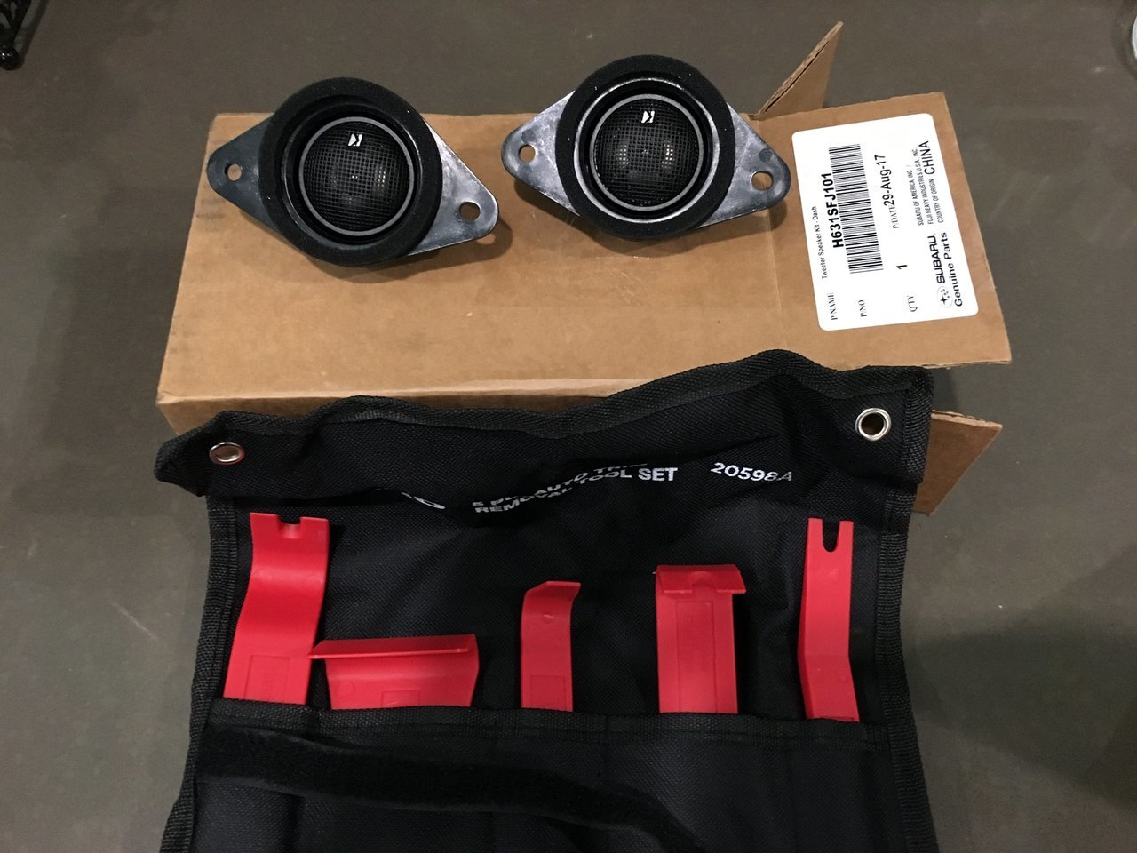

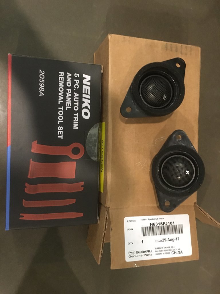

    I installed the Kicker tweeter upgrade today. I had a couple of “well secured” panels to pop out but all went well and I got it done during my lunch hour. I would note that the speaker brackets feel plastic. Because of that I’m not sure there was any appreciable difference is the weight of the speakers. In fact, I think my factory tweeters were heavier but that is likely because of the steel brackets for the factory speakers. The factory speakers were paper like everyone else said and they had no protective cover over them like the Kickers. They were heavier than I expected but not impressive to look at (or listen to).
    I’d say dedicate about 30 minutes for the install (I took my time). Below is a picture of the speakers and the trim panel tools I used. The tools were a 5 piece set for less than $10 on Amazon with a nice wrap up storage bag/case. My only minor issue is that they are almost too thick to the point where maybe they went a little overboard trying to make them “extra” durable.
    The speakers fired right up after I installed them and put all the trim back on (good thing because I put the trim back on before I tried them out - rookie mistake). They sound better but how much better was hard to detect for me because my time was really limited. They are definitely more clear and crisp but not much louder to my ears. I plan to spend some more time listening to them as time permits and will report back. The one thing I would note is the same thing many others have noted and that is there appears to be more sound coming from the front and it likely means they are doing more than I thought and the other speakers need to be upgraded to balance out the sound.
    Once I upgrade the doors I’m not sure if I will use the Kickers or go to the Focal speakers I’ve been eyeing. Thanks to everyone here for all of the useful info and tips - what a great community of “people helping people”. Peace and have great remainder of the day.
